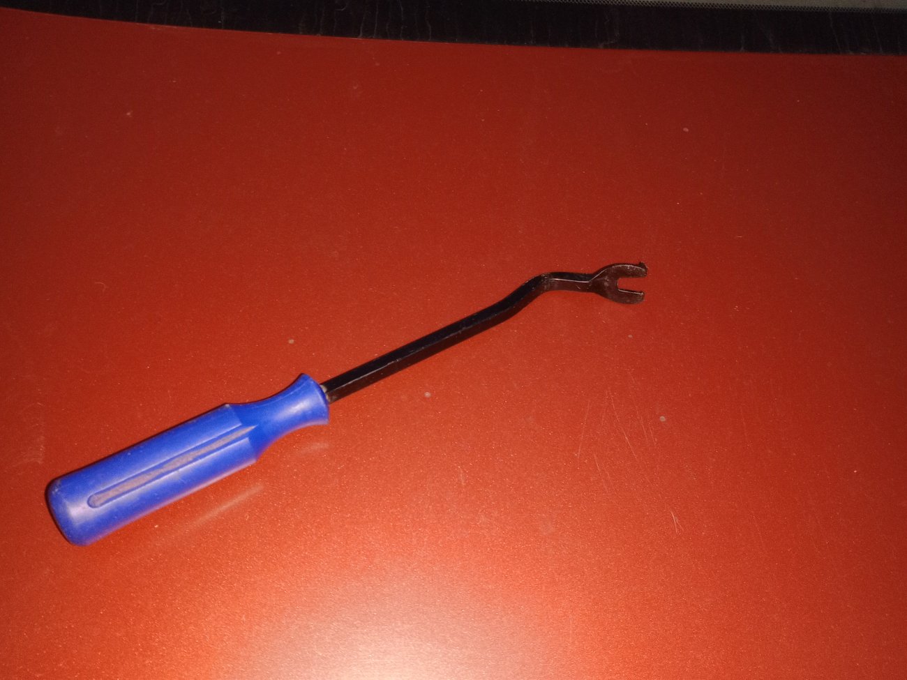

if anyone was wondering, once you disconnect the hard line (7/16), you need to pop up the clip.its the only thing holding the brake hose end in place. I used the tool show in the picture, it made things a hell of a lot easier. after you pop the clip out, the end of the brake hose will slide in and out. when putting the hose in place don't forget to make sure it stays away from the suspension or any obstruction. then just install the other end to the caliper (14mm).
Sounds like he's telling us how to do it now.Lol
