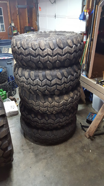

Picked up a set of tires from my buddy. 38.5" TSL SX's, It couldn't have worked out better. I actually scored a free 38.5" SX spare tire recently, before I knew I was going to buy these other 4. So now I have a spare tire. They are going on a set of H1 beadlocks I have laying around.

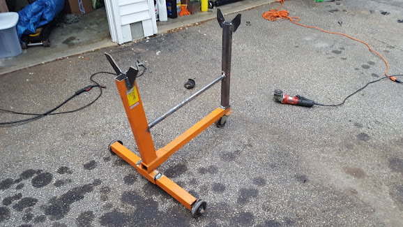

In preps to start rebuilding the front D60, I needed a stand to throw the axle on. I had a old engine stand laying around so I modified it to hold the axle.

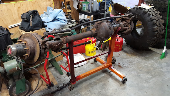

Plan is to go 35 spline outers on the D60 and 4.56 gears. Hopefully tonight I will be picking up a 14 Bolt rear with 4.56's and a Detroit. I was going to keep the sterling but parts are to pricey for that, trying to keep the cost low on this one to get back out on the trail.
