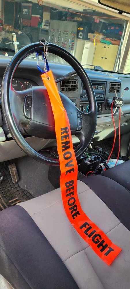

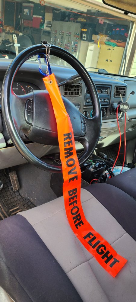

This might help prevent me from driving off with the block heater plugged into the extension cord. I'm not always 100% awake when I leave for work in the morning.
2002 F250 diesel - discovery and build thread.
I had that problem at first as well until it became a habit. Once in a blue moon, I still forget and come home to the extension cord strung out in the driveway or in front of the house.
The people I see that use black heated back the truck to the house, then run the cord up the drivers side and hang it over the mirror.
That way it’s in your way to open the door.
