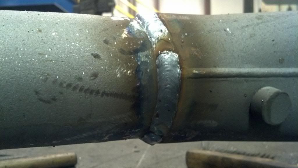

Nice build, clean welds and liking how you're building the rear suspension

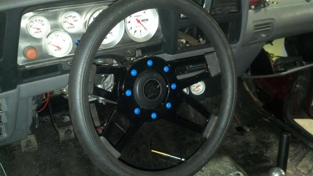

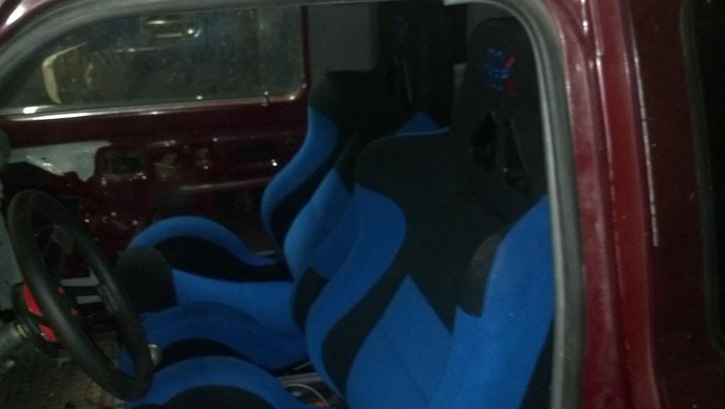

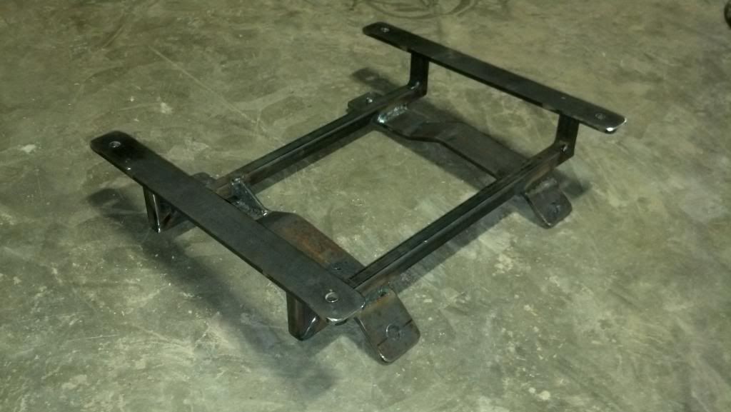

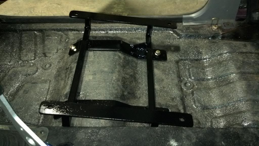

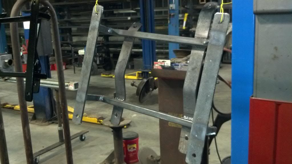

custom painted steering wheel to match seats and custom seat brackets for my APC race seats

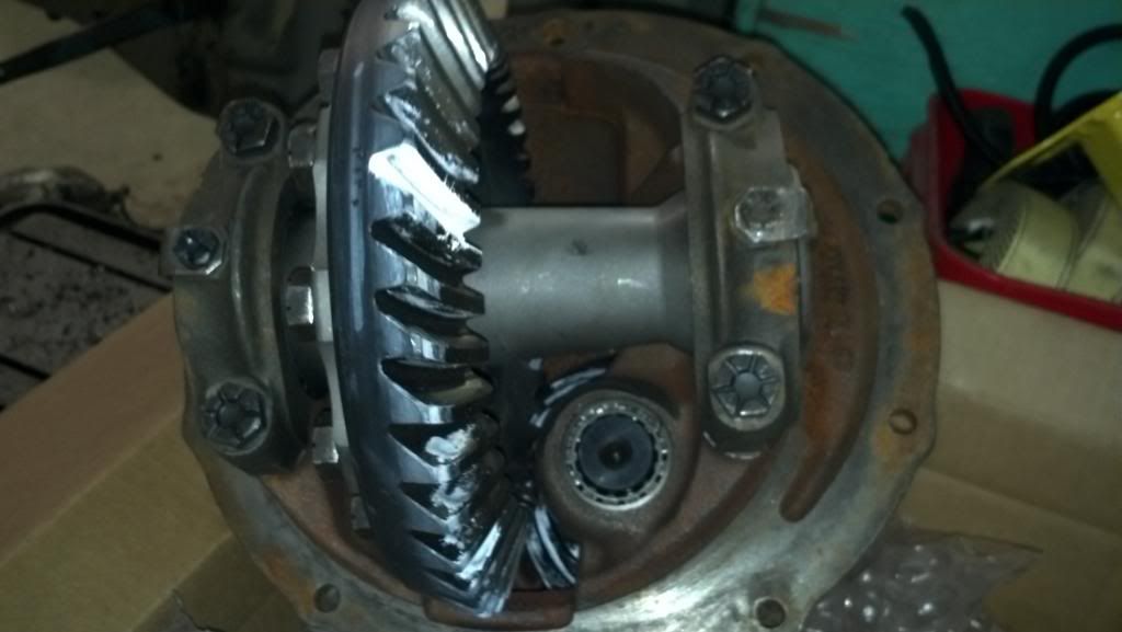

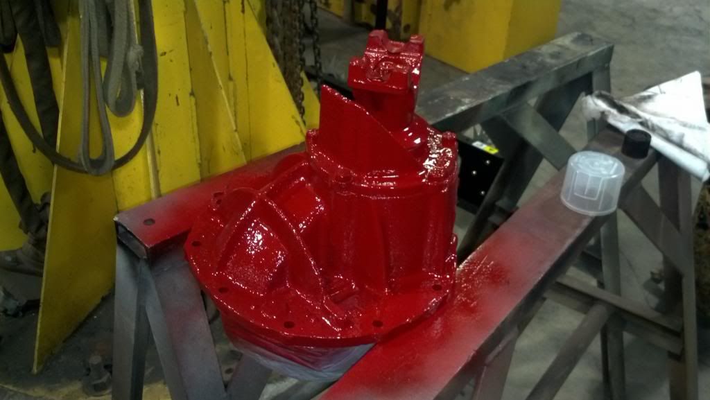

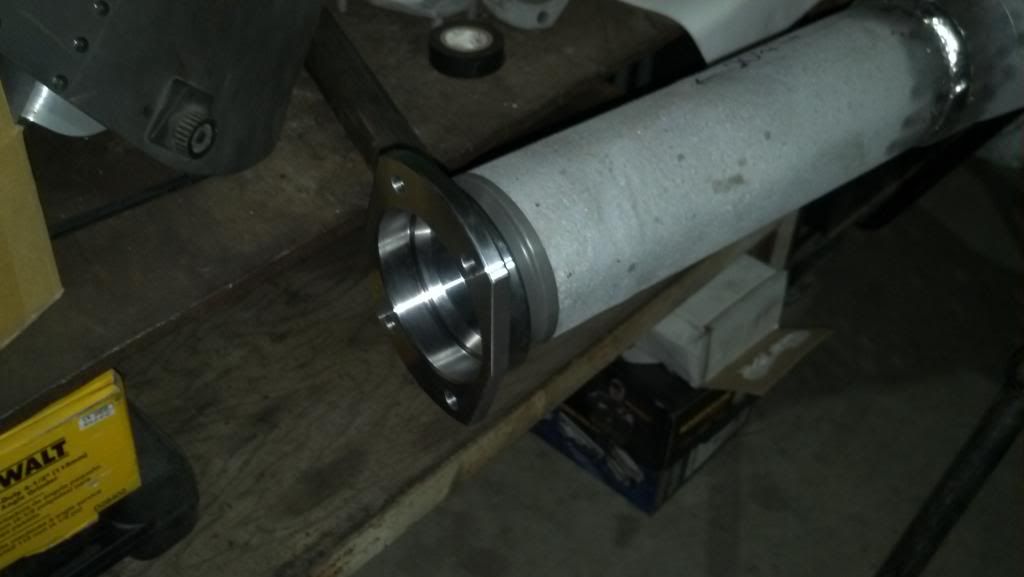

And the 9" swap pics & once again ANOTHER 4 link design this time using factory crossmember no added weight and coil sprung rear with drop shocks
third member has 3.70 gearz and a full spool 31 spline moser axles with 5x4.5 bolt pattern

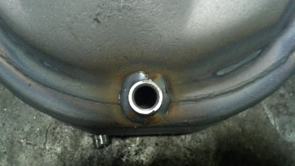

BAFFLES SO WHEN YOU CORNER GARD THE OIL DOESNT SLOSH DOWN AN AXLE TUBE!!

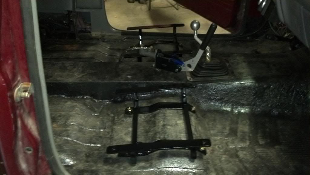

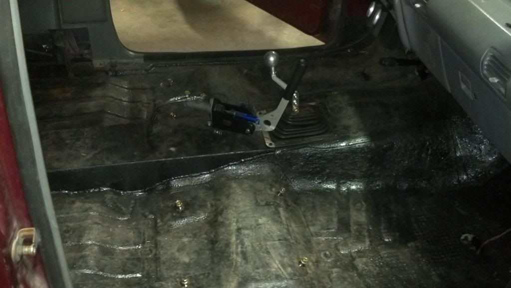

SCRAPING OUT FLOOR & FACTORY SOUND DEADENING TO PRIME N PAINT THEN SOME B-QUIET SOUND DEADENING FOLLOWED BY A FACTORY BLACK CARPET WITH INSULATOR UNDERNEITH SHOULD HELP TREMENDOUSLY!
