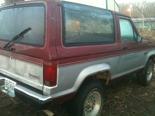

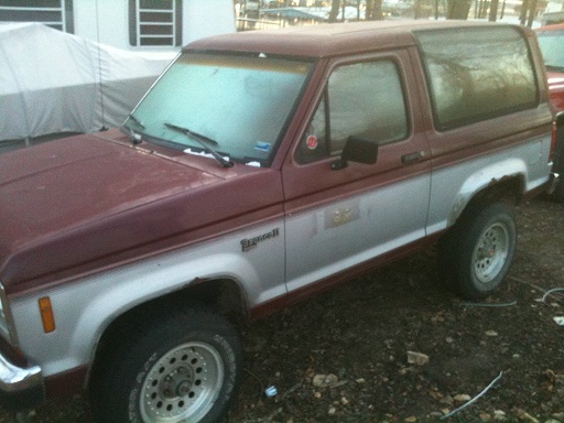

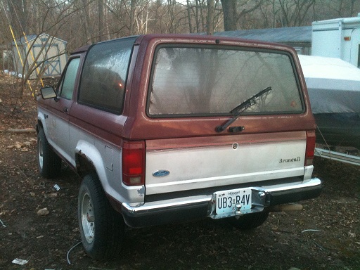

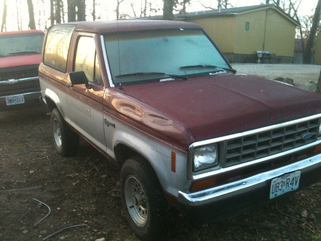

Was wondering if anybody could tell me if I can put 31.10-50s on my stock rims??And also I want to level the thing out it was a mail carriers truck so its has a slightly heavier set of springs in the rear and its like 2" taller in the back any ideas or suggestions on how to raise the front end without spending a ton of cash??:icon_confused:

Yes, you can put 31X10.50s on those rims.
As for leveling, search for it, there are instructions for making a leveling kit.
u bolt the spring from the front axle and put a spacer or washers between the spring and axle thats the cheepest way i kno of
you can buy 2'' leveling sacers off ebay for 50 bucks
look in the tech library under "lifting on a budget"
You might want to wait on the tires until you do the leveling thing. Other wise you will have a rubbing issue with the front. I have that size of tires on my b2 and ended up cutting the bottom front corner of the fender due to rubbing every time i would turn a corner.
Just bought a 3 inch body lift that i still need to put on but first have to fix the a couple other things.
Yep that's what I was gonna do, level it out a bit in the front just haven't decide the best way to do it yet.
