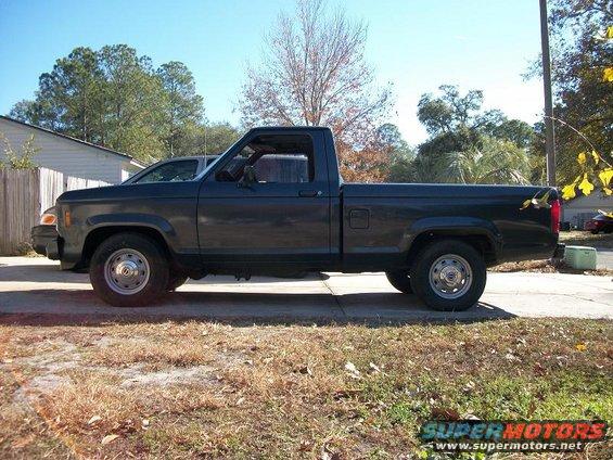

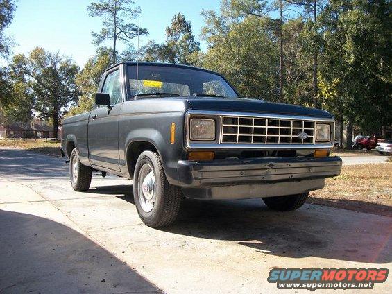

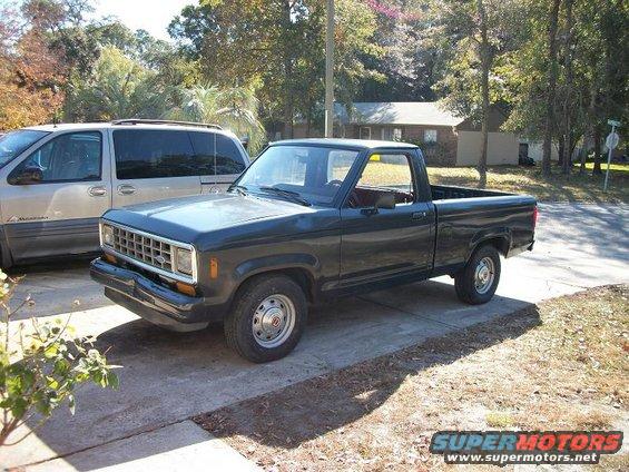

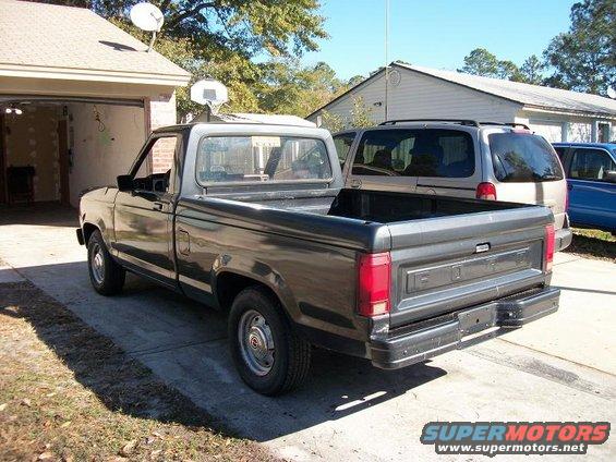

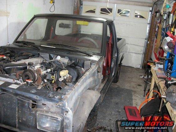

this is my current project.its a 1987 ford ranger with a 2.9 v6 and auto tranny.has ac,heat,ps and brakes.i would love to keep all that.i plan on swapping in my 1984 2.3 turbo out of a svo mustang with a t5 tranny.i have a LA3 comp out of a 88 tbird tc.the engine has been warmed over alittle.this swap will start soon and i will post all progress as it happens.here is some pics of it now.....

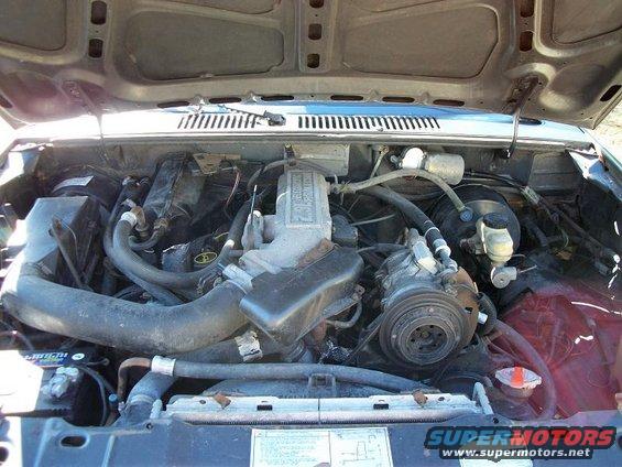

the good running 2.9...almost dont want to pull it...lol.:icon_welder:
thanks.and whats really cool is i only paid $280 for the ranger...and drove it home.but the tranny has no reverse and it cuts out while driving.but idling its really smooth.and in park when you start it it jumps forward alittle and acts like its in drive.oh...its all coming out anyway.
ok time to work on it.gonna go pull some panels off so i can fix some rust and get it ready for paint.yes the 2.9 and tranny will come out before paint but the 2.3t will not go back in until it is painted...doing a color change to a burnt orange color.

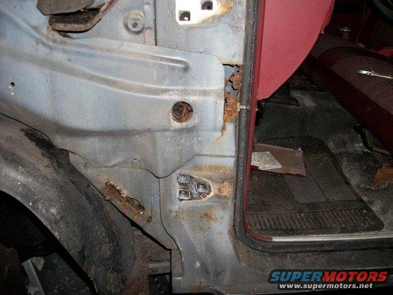

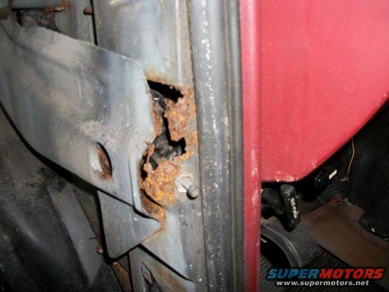

got some panels off so i can fix some rust issues.nothing major just some holes.all easy fixes.after i weld in new metal it will all be good.and this is it as far as rust goes on this truck.very surprised with it being a florida truck close to the beach.

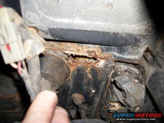

this is next to the brake booster closest to the fender...
