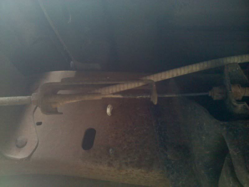

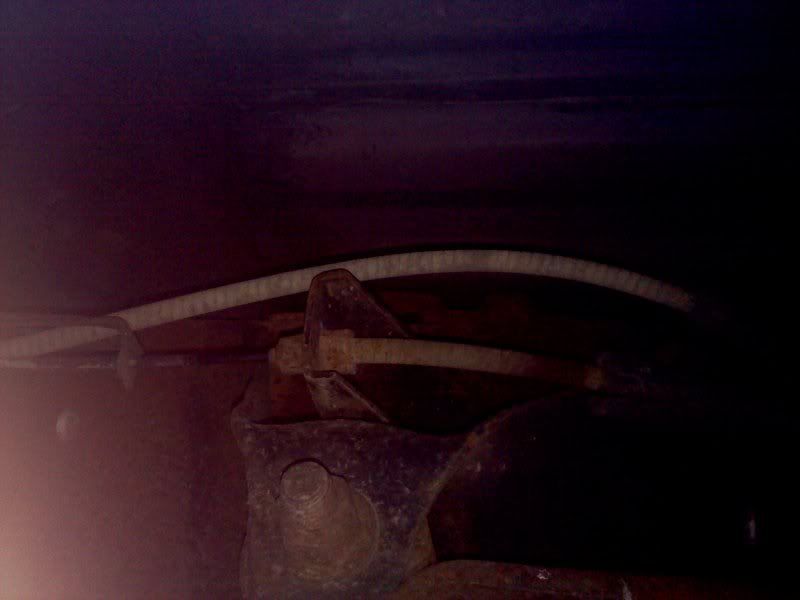

The brake line is spraying out brake fluid in the rear where the line crosses through the frame I need to know the best way to remove and replace any help would be great thanks
And not sure how to detach this to replace line
This is where the line crosses throught the frame kind of

the thing is there is a piece where the lines come down the left side of the truck a connection that i dont know how to undo i will try to take pictures and post them to see if it helps
All of those pics you posted are of the parking brake cables.... no fluid in them. Get up under the truck more and you'll see the brake tube runs inside of the frame. Chances are your line is busted between the gas tank and the frame.
