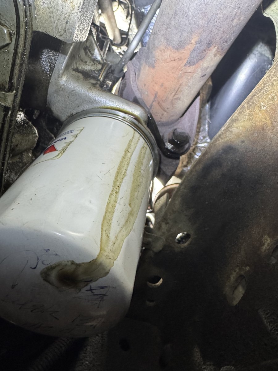

but the most concerning thing I need help with right now is when the engine was running to check codes I started to hear a slight drip sound after 5 min and noticed there was dark liquid leaking from where exhaust manifold connects to exhaust pipe, has a gas smell and I’m assuming the darkness is oil.
any help, knowledge and suggestions on codes and exhaust manifold leak would be greatly appreciated. Some photos attached

Which manifold is getting hot; first you mention the exhaust, then the intake?
It was running a lil rough after dizzy was replaced until I set the the timing and everything seemed to be good until I noticed the intake manifold was way hot. Never got to glowing red hot. With spout out timing was set to 10 deg as specified on truck so I’m a lil stumped to think the timing would be off.
This is with new injectors and distributor,running good but the exhaust manifold is getting hot? Did you drive it? Both or one manifolds getting hot? How are you measuring manifold temp?
