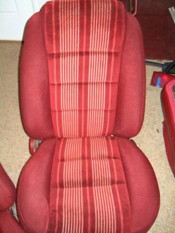

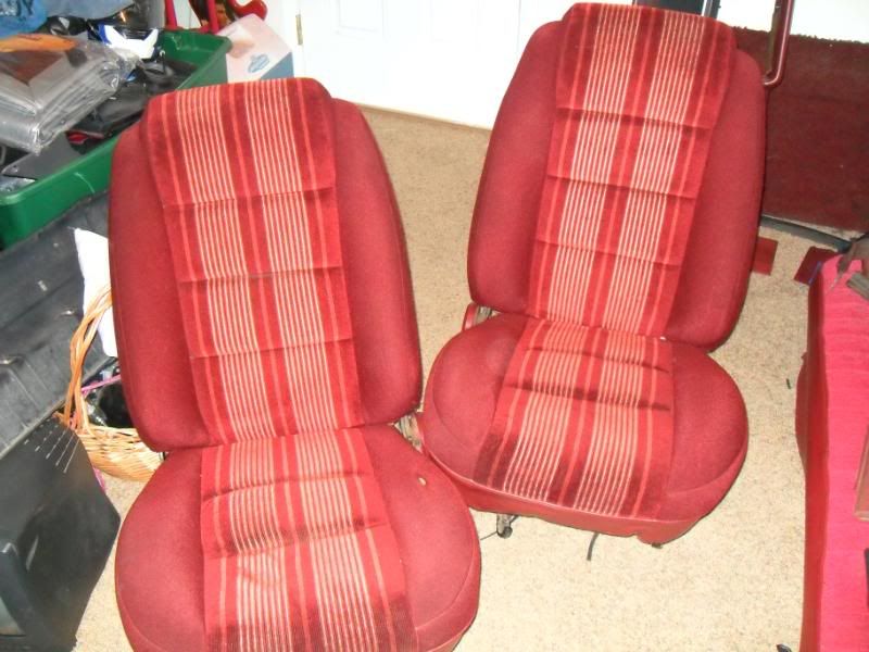

I appreciate it ! Back to the junkyard I go, Here is a Pic of the Seats I'm putting in, I think they will look GREAT ! and "Period Correct" I'm trying to restore the truck to like it was when It came off of the showroom floor (Plus some Upgrades) LOL....
