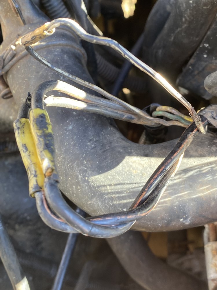

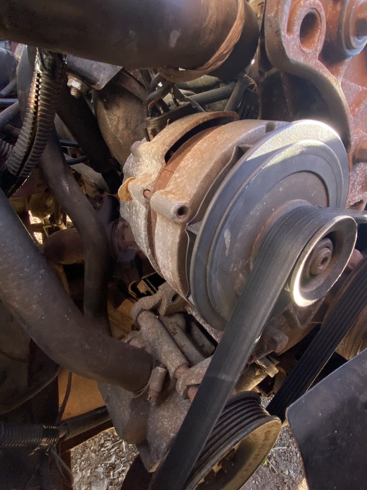

Took the battery off charge this morning after 20 hours and it read 12.52. I let it sit for 2 hours and it read 12.50. I installed the battery in the truck and started it, slow crank again and battery was at 14.58. Checked battery again 20 minutes later while truck still ran and read 14.16. Turned the truck off and now it won’t start, very slow cranks and that whining noise that sounds like it’s coming from the starter. Battery reads 12.04.
Found this mess under some electrical tape going to the alternator. Maybe someone added a new plug to the harness? Is there supposed to be an extra alternator ground on this metal tag? After cutting the bad section out and adding a length to the smaller white wire and 2 butt connectors the truck started up and with strong cranks! I let it run a while and cranked it back up but barely started.
