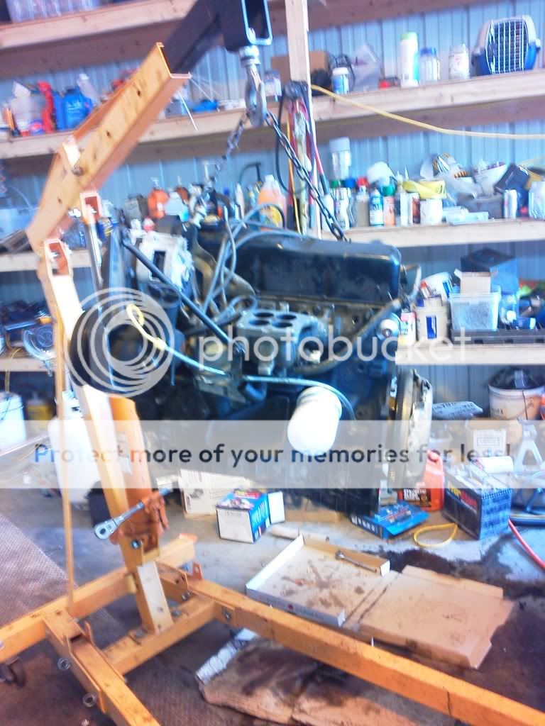

here is the "new" one:

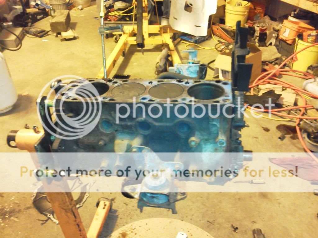

as i was swapping parts (new was 2.3 mustang, different brackets etc) when i pulled my oil pan off the old engine and look in my sump to see why i had low oil pressure, found a shard of piston skirt(what the hell?) so then i start digging in my oil pan and found this:
l
l
l
l
thats my my #3 piston. so what i was hearing wasnt a lifter tick, it was that rattling on my crank and rods.
