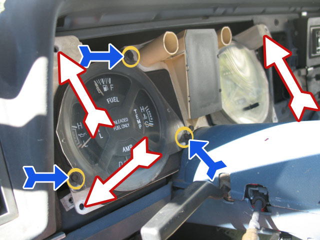

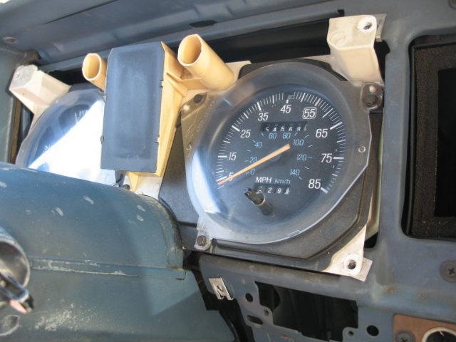

There is not enough room to wiggle my big fat hand behind the top plate, or the right side to loosen the SPEEDOMETER CABLE. So IF I definitely need to unhook the Speedometer cable, then I shall, IF this is the ONLY way to get to the 194 cluster lights on my truck.
As you can see, I removed the four screws holding the back plate on. They are the WHITE LARGER ARROWS with red outline.
This panel will not easily come out. I've done this before, but don't ever remember disconnecting the SPEEDOMETER cable to replace those 194 light bulbs before.
Am I supposed to remove the smaller BLUE ARROWS with WHITE TRIM smaller screws to get behind that left side plate?

To make getting the cluster out/disconnecting the speedo cable (you may not even need to) look along the firewall near where your right foot would be, you'll see the speedo cable is attached to the firewall by a bracket held with a single screw, at least it was on my '86.
edit- you shouldn't need to bother with the screws you've indicated with the blue arrows, there should be no need to disassemble the cluster itself, you just need the whole unit (white part) to come out a little, so you can get at the back of it.
