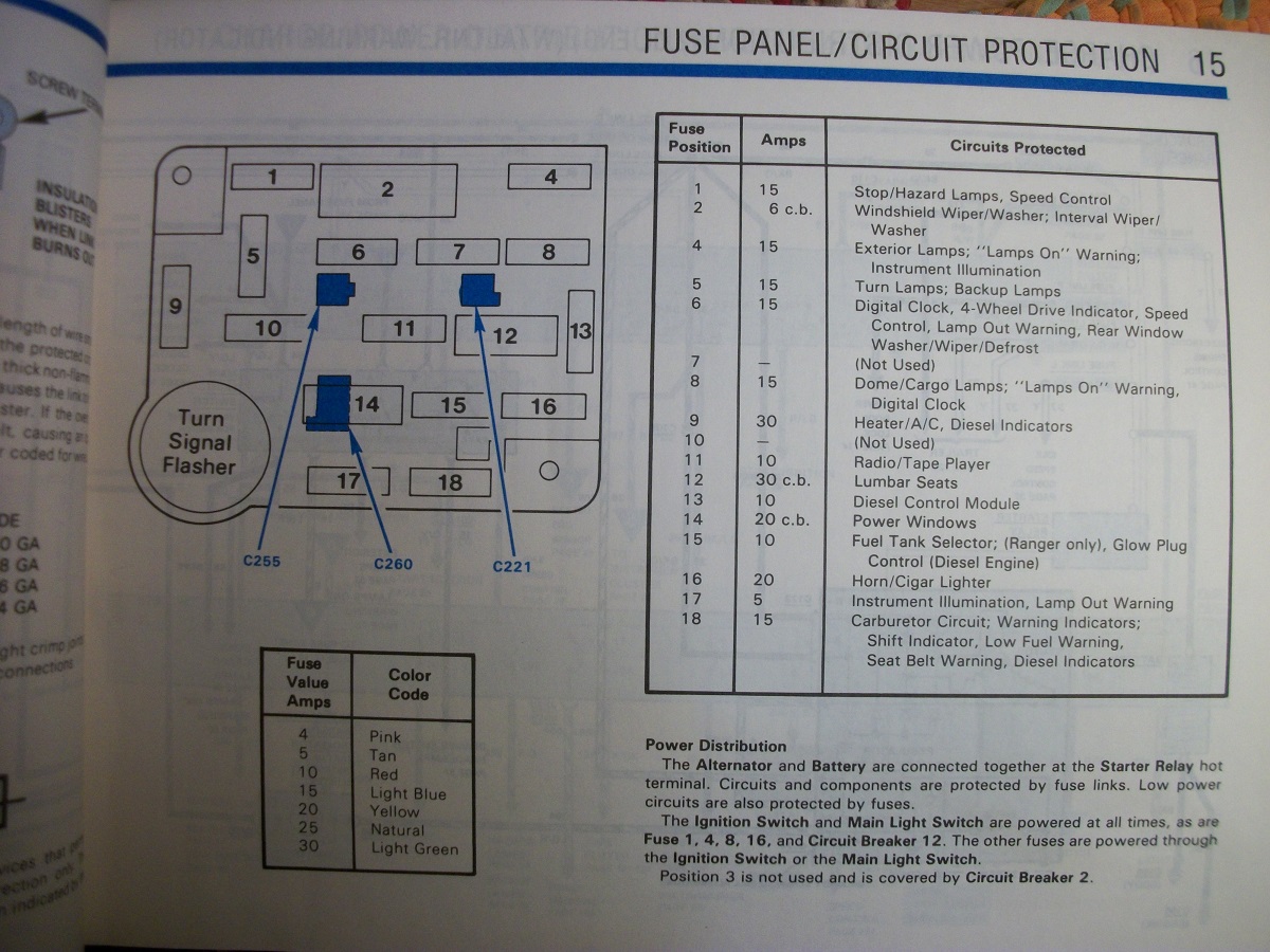

Anyone have an EVTM or owners manual with a diagram of the fuse box that they could post? I'm working on one for a friend and want to give him a picture and list of which fuses feed which circuits. Thanks.
Ask and ye shall receive; from the 1986 EVTM:
47038
Thank you sir.
