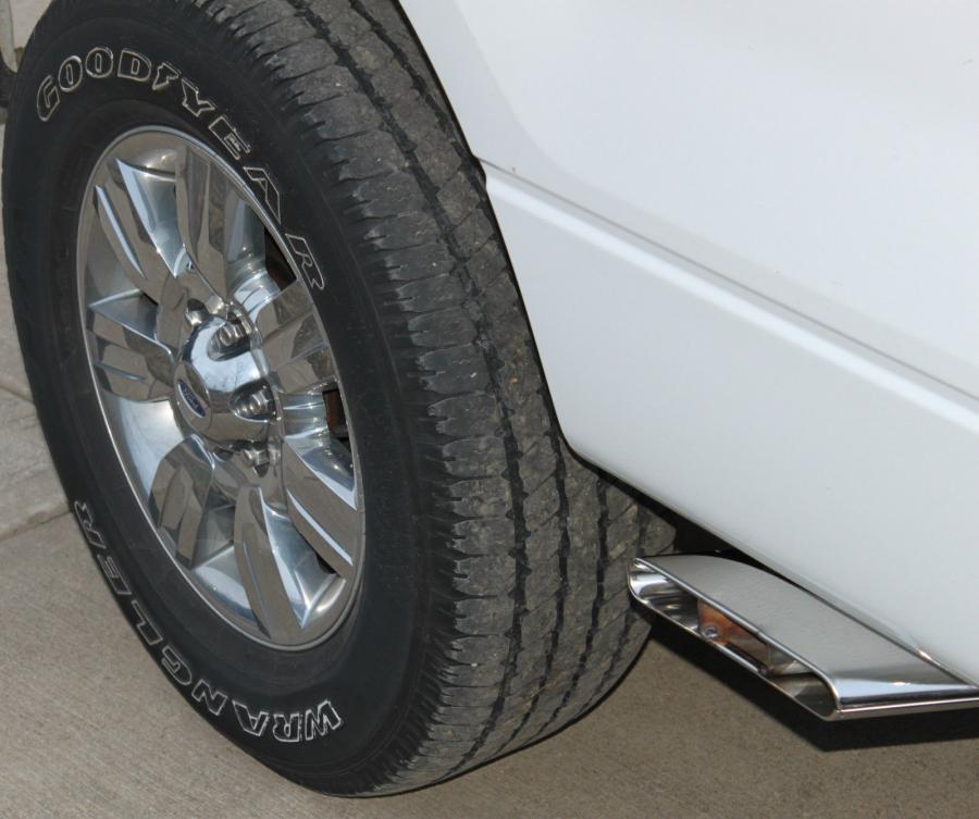

Don't worry, If you go with the series 10 flowmasters on a true catless dual exhaust coming out each side before the rear tires you will get a VERY DEEP RUMBLE! Try the Flowmaster Delta Force 10 Series with some nascar exhaust tips, save a little space and some clearance.
Check a lot of threads of this issue of V6 rumble and you will find it just doesn't happen and especially with smaller ones-I am a fan of the 2.9 kinda- a lot more pep than the 3.0. I had a built 2.9 once. Save money and go the one pipe route. Check out Hooker's Maximum Flow muffler(highest flow rating-better than flowmaster) but not cheap and a hidden exhaust tip-curled down at the rear and barely visible. Deep breathing(cam profile and cubes) with semi-high compression leads to a good deep rumble-not loudness.
