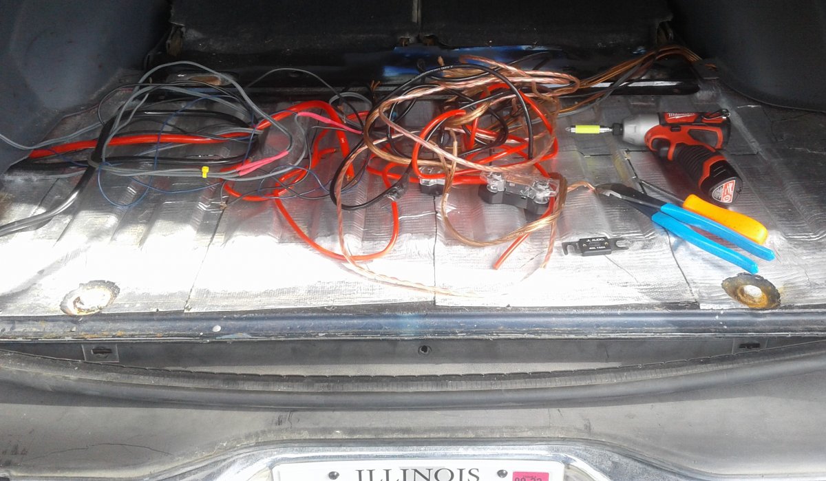

I did go out there today and was going to knock out some fixes. I popped the hatch to set some tools there and noticed the carpet batting was wet... not damp... WET. So the first thing I did was pull out his old amp/speaker box and pull the carpeting out to let it dry up. Then I started to address the massive amount of audio wiring this thing has. Then I decided to to wait and address that when I actually rewire the stereo. At least the soaked flooring got out. The water has to be working it's way around the liftgate seal. I don't see what else it could be.

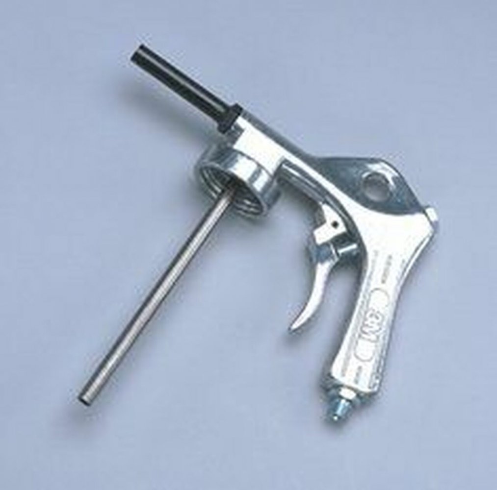

Was the schultz gun a HVLP type or just a regular paint gun? I have a couple Devilbiss (think that is the right name) guns I bought for cheap at a garage sale years ago. Either way I'm going to need to practice before I go off applying anything.
A Schutz gun is a siphon feed with a 1/4” nozzle. It’s not like a regular spray gun. A regular paint gun of any type will just clog instantly with the rubber particles in bed liner.
67246
It was cheap... under $20. I still use the thing a lot, for spraying soap, starting a siphon on a hose, etc.
Looks like the price of those has went up a bit... unless I'm seeing the wrong Schutz spray gun.
It looks like you can get them for under $30. Look for an undercoating gun.
