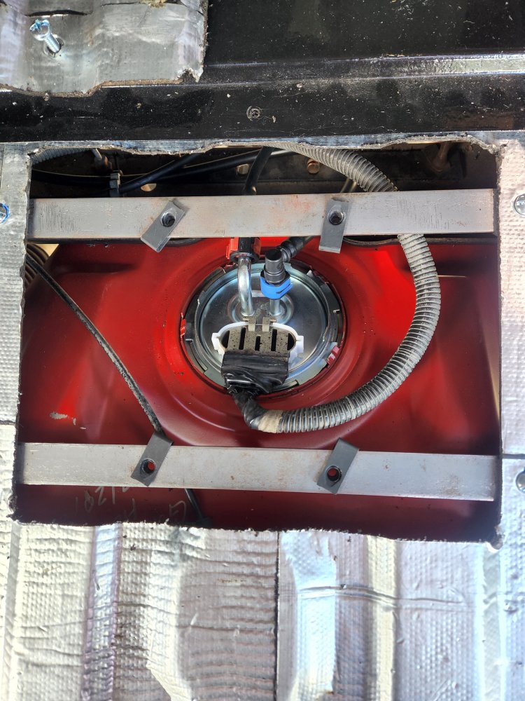

Good work, that will be handy for when you have to change the pump. I may have to retract my recommendation for the Kemso pump, mine kicked the bucket last week :mad: Wish it was as easy as cutting a hole to change mine.

Nice job. The last one I cut a hole for I had to carefully wield a sawzall. It was what I had at the time that used batteries. Jigsaw would be way easier.

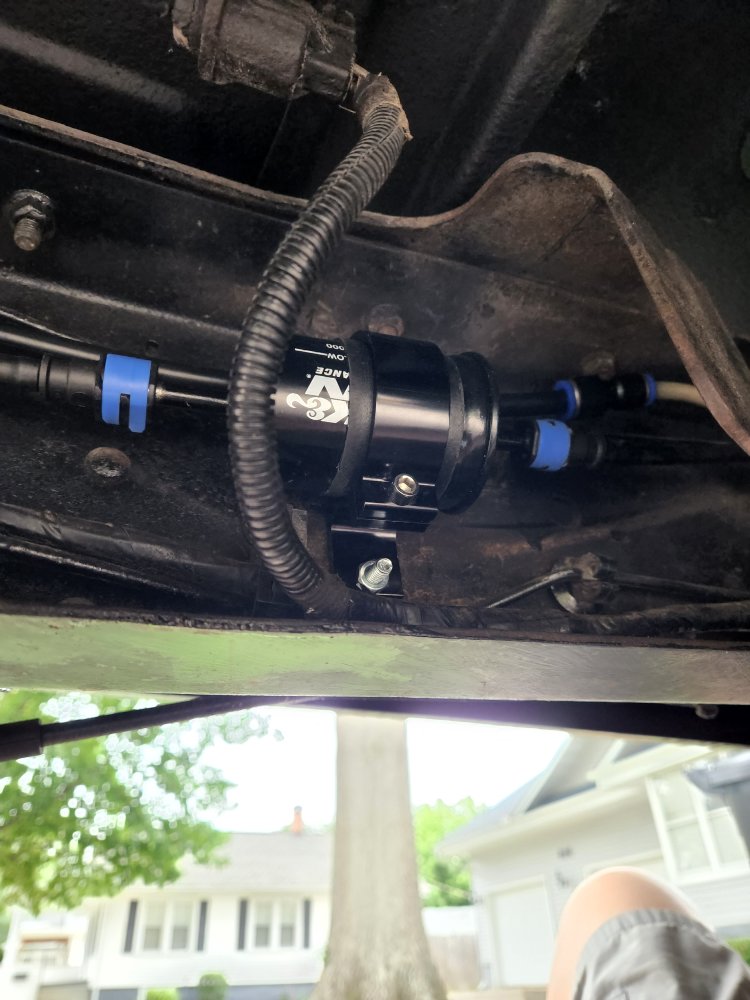

Got to mount my fuel filter... make one more line and put some fuel in this old thing.

Well... fuel filter/bracket mounted... remaining lines plumbed. Filler neck installed... all I need is some fuel. Got some running to do and I need mower fuel anyway.

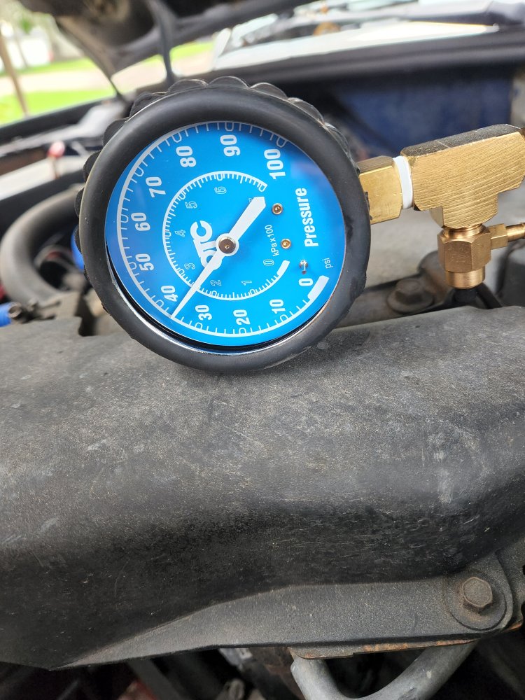

So it got some fuel and I primed the system several times with key ON cycles. I noticed both my unions where I tied into the original lines were leaking. I got back under it and gave them a bit of a twist while pushing the lines in. It seems to have worked... no more leaks. It fired up and fuel pressure was were it should be... and increases with a stab of the throttle.
Last year I ran it with that swamp fuel and I'm pretty sure it fouled the plugs. Tomorrow I'm gonna crank a set of plugs in and put the timing light on it. So the jury is still out for now... but I'm guessing the fuel system is good. This picture is after about an hour. I left the gauge on it and will see where it is in the morning.

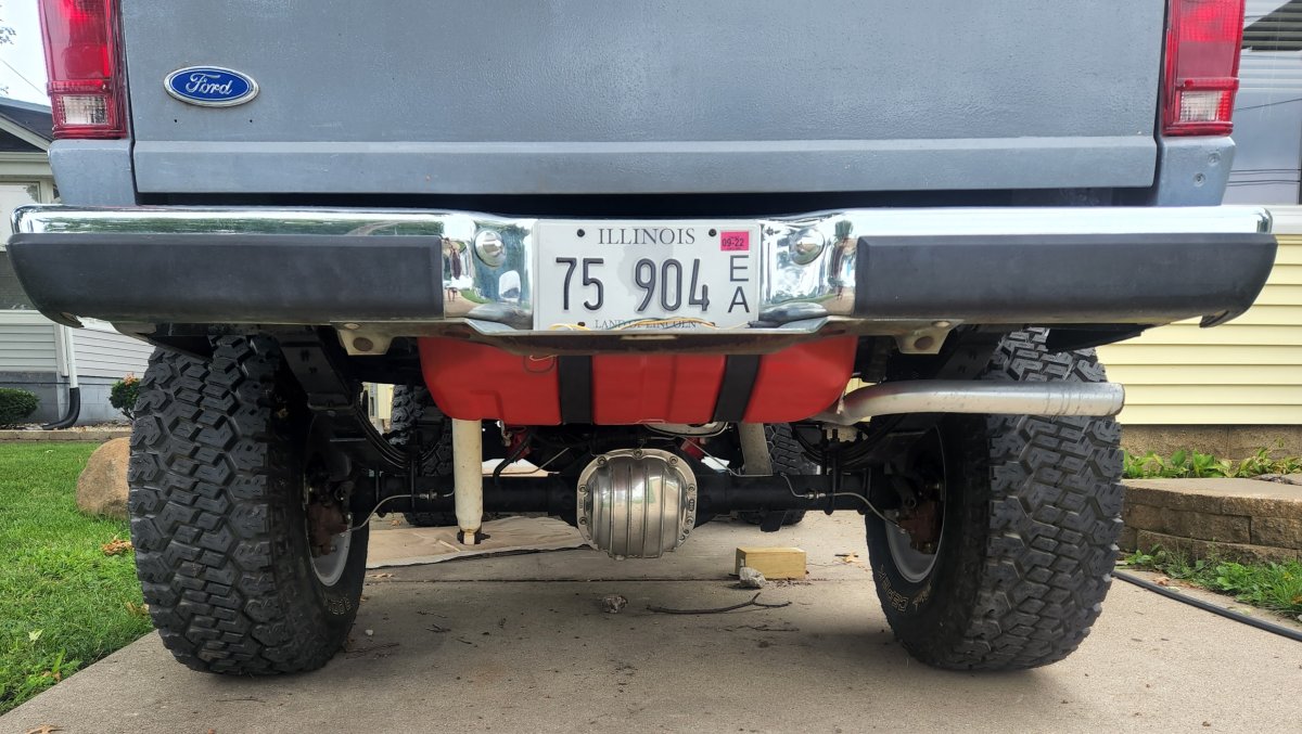

I kinda like the red tank... shame to cover it up with the skidplate.

Maybe a red skidplate... :icon_confused:
Question. The two holes below the "Ford" emblem. Are they for a badge like "Eddie Bauer"?
Yes, a red skid plate would be nice. Call it a "target" like the Pintos. lol Seriously, red would be a nice offset.
