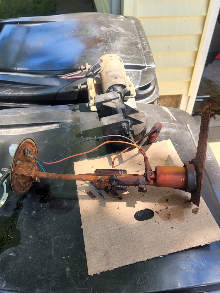

Read and loved the entire thread @Uncle Gump! Thanks for the link. I found the tank easy enough on Amazon but as far as the pump/sender and filter (and hoses or other ancillary parts) did you have a list/links? 👀 Easy enough to get this done while I'm at everything else...:ROFLMAO:
EVIL ENERGY EFI 255LPH Electric Intank Fuel Pump High Flow 43PSI Kit https://www.amazon.com/dp/B08PF9LBB2?tag=959media-20
EVIL ENERGY 50mm Fuel Filter Mounting Bracket, Fuel Pump Clamp Holder Black https://www.amazon.com/dp/B07GB73PRD?tag=959media-20
K&N Gasoline Fuel Filter: High Performance Fuel Filter, Premium Engine Protection, 1996-2017 Ford, Lincoln, Mercury Fuel Injected Gasoline Engines, PF-2000 https://www.amazon.com/dp/B00OXZE4SC?tag=959media-20
@Peter Griffin those are the major components I used. But my Bronco did not have an in line filter. You could probably use your existing Fuel Filter if you have one already in place.
The other thing I bought was a Dorman nylon fuel line repair kit. In hind site and looking at today's pricing I would just buy the tool that presses the fitting into the lines and not a complete kit.
Dorman 800-301 Fuel Line Repair Tool Universal Fit https://www.amazon.com/dp/B000E35W1K?tag=959media-20
Also... my fuel tank was really bad. I bought that on Amazon also. It was a return and I got it for less then $50.
I couldn't find the fuel sender on Amazon and went local. It was a Spectra part.
I guess I will add a bit more...
You have two different size lines on your truck... 3/8 and 5/16. If you do this mod... all lines end up being 5/16.
Thanks @Uncle Gump! I very much appreciate you taking the time to do that for me. I have the frame mounted filter I believe...? I thought my truck had 2 pumps; one in the tank and another inline but maybe I'm confusing that with the filter...
That's what was on my truck. Yours should have it too. Fuel sender with low pressure pump... fuel reservoir... frame mounted high pressure pump. Most also had an in line fuel filter between the hp fuel pump and the engine... right up by the engine cross member. If it does... use it in the new system. The rest... pitch it in the garbage can. We'll someone may need parts I suppose.
