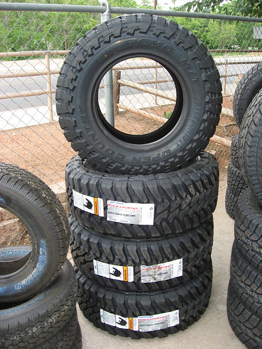

today i shuold be picking up those 33s too. i forget the name but they look alot like these
toyo open country m/t
