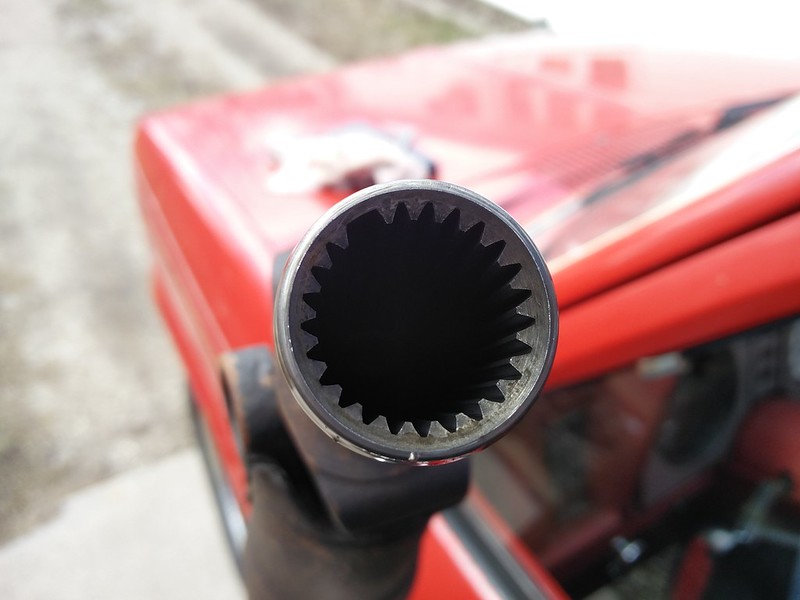

Got under there, pulled the driveshaft. Took the opportunity to grease the (recently new) U-joints, which have those infuriating flush-mount grease fittings making them challenging to grease overhead.
Also observed slop in the parking brake cable adjustment, which was new a couple years ago also. Tried to turn the adjusting nut, broke the end off the cable. Super awesome.
Pulled the fill plug on the trans and checked with my finger. The level was a little low, not scary. Added some since I was there anyway. 90% of the oil loss onto the driveway is engine oil, but there's a definite leak from the back of the trans, and a spray line across the floor where it gets slung off the yoke.
Speaking of the yoke:
Re-verified the OD is 1.375" (1-3/8")
Checked for wiggly slop, realized I was mistaken, there is almost none. Maybe 1/32" of lateral movement at the end, which is probably nothing...yet I still have big oil loss out the rear seal, not helped by a new seal, so...

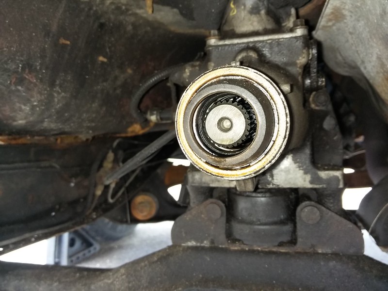

It's nearly impossible to see anything meaningful in behind the seal, but I tried:
The very last picture seems to reveal the presence of a bushing at the right near the top. At least it appears there is another 'edge' inside, and it is not part of the seal.
