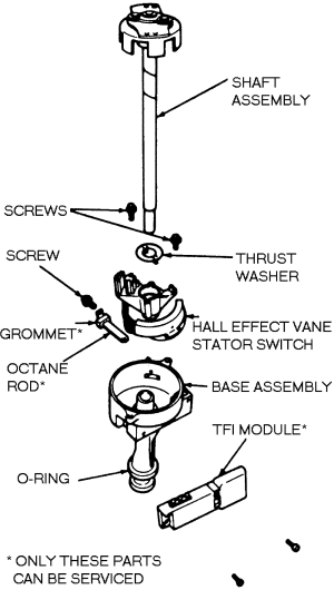

You don't need to pull (or take apart) the distributor to replace it. Just remove the two screws, and pull downwards.

tfi ignition module

The pickup in the distribulator can go gooey where the TFI plugs in from the bottom. If you replace a TFI make sure the contacts in the bottom of the distributor do not 'move out of the way'.
