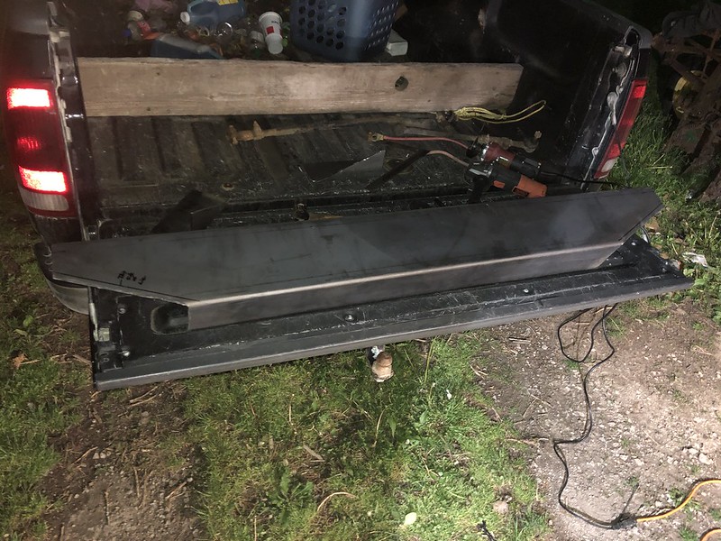

Rear bumper is CUT!!
'85 Ranger Restomod
Just need to measure it up and get some plate to fill it in. And reinforce it for the tire carrier and figure out how to mount it, and make a spare tire carrier and and and...

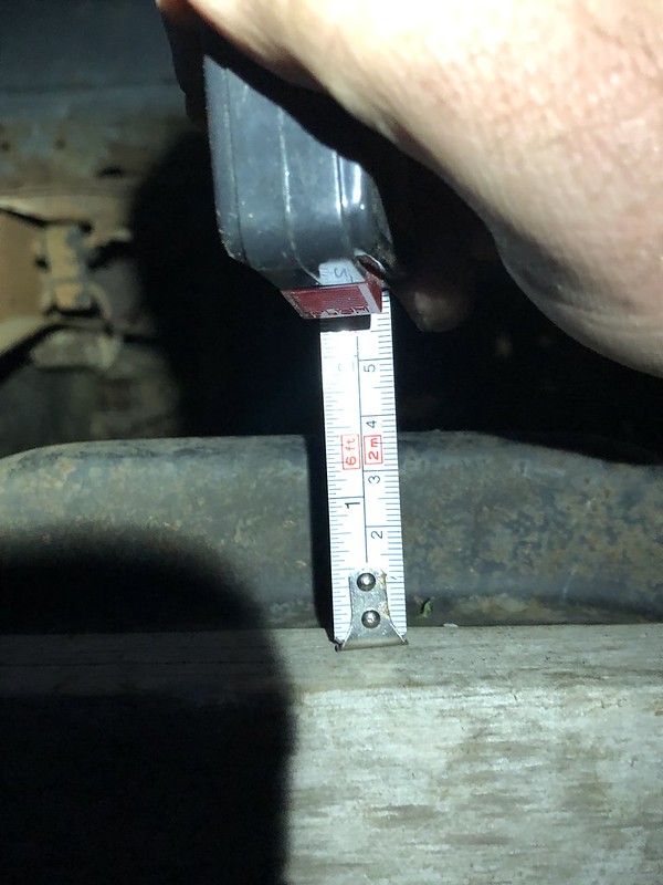

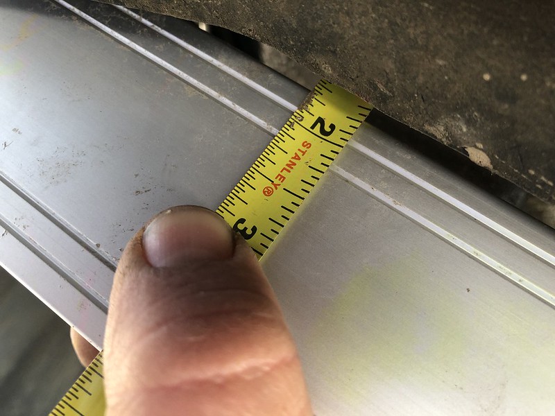

So I dig the crossmember out of my dad's grainery and flip my pickup box trailer in process up on its butt and measure.
'85 Ranger Restomod
Gonna call that 1-1/2" above the bottom of the frame.

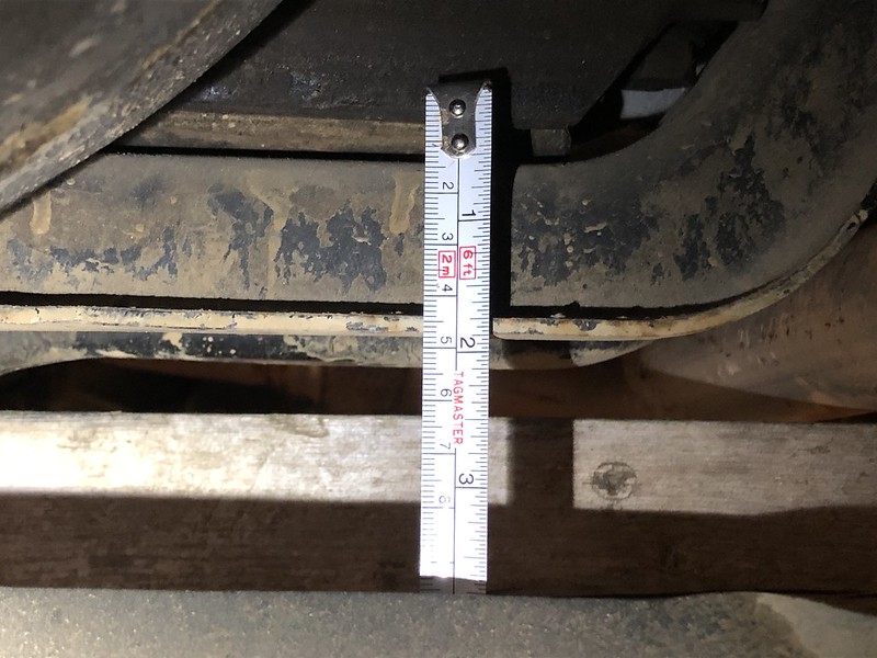

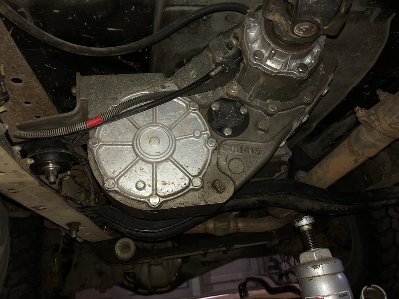

'85 Ranger Restomod

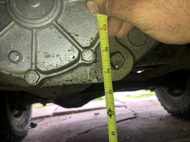

So then I crawls under my truck, the perspective makes the top look weird but I did my best to line it up. 2-1/2", a full inch different!

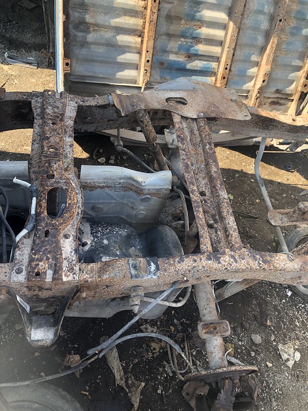

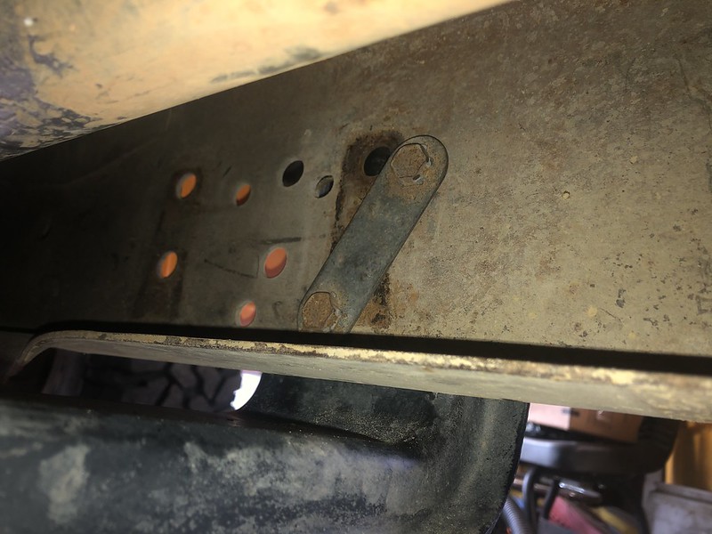

Ok, lets call that a plan B. The brackets on my trailer are very rotten and riveted on the frame to complicate pulling another set from a yard. The second gen mentioned earlier bolts on, easier to pull and easier to mount. So I hit the JY.
The least crusty one there was in a '93 Explorer. I did measuring back and forth and the frame doesn't get wider until RIGHT after the trans crossmember. I also measured it to be 1-3/4" above the frame. So I give up a quarter inch of adjustment to get a much easier to work with crossmember.
'85 Ranger Restomod
Still nervous about the frame thing I compared to a 2wd third gen, same same. Also eyeballing it for fitment it looked to be about a quarter inch higher.
'85 Ranger Restomod

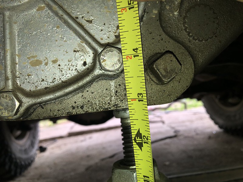

Before I start I measure just for giggles:
'85 Ranger Restomod

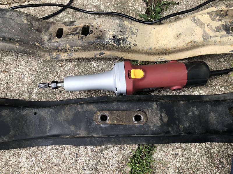

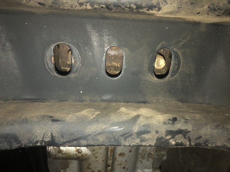

And it bolts in! I think the holes are there for dogbone style crossmember and this one uses two on the passenger side, kinda neat.
'85 Ranger Restomod
Or almost bolts in... had to break out the die grinder.
'85 Ranger Restomod
'85 Ranger Restomod
'85 Ranger Restomod

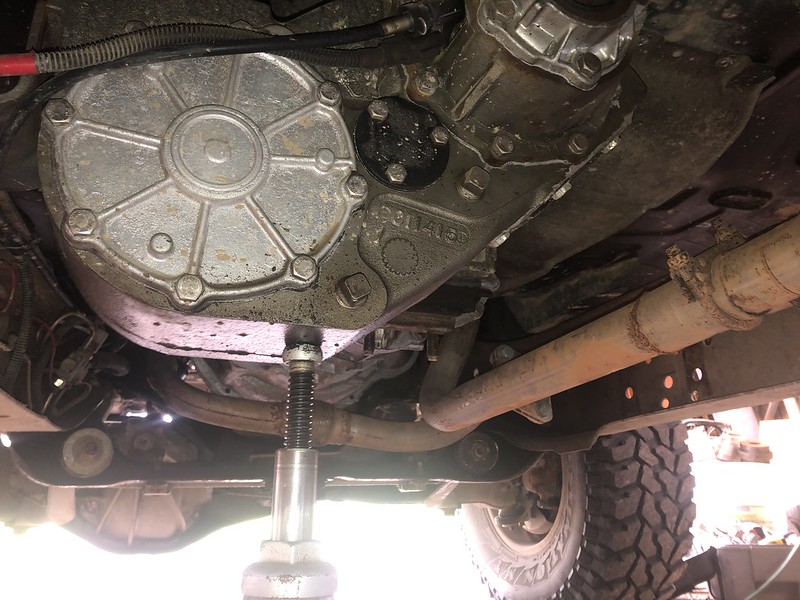

And it is down 3/4" on the nose.
'85 Ranger Restomod

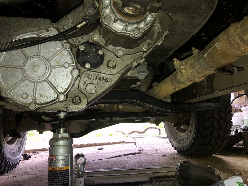

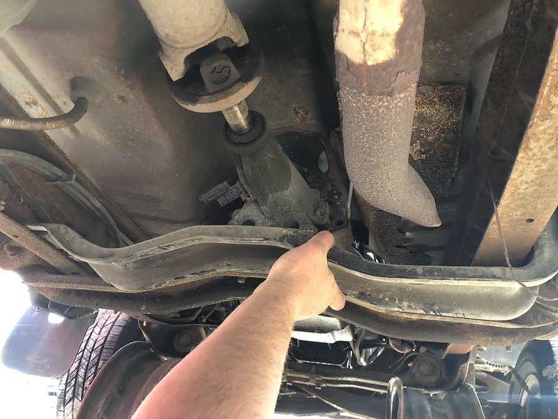

Crossmember is holding the transmission:
'85 Ranger Restomod
Angle still is not ideal. Pinion is up 1.5* compared to the transmission. I suppose without the Belltechs it would be right on. Given I have dropped the trans a ton I am going to give it a go and see how it is. I need to work on the t-case mount yet but otherwise I am optimistic so far.
I had to modify the t-case mount so it could sit lower, and drill new holes in it. It fought me every step of the way but I got it back together. I went to hook the driveshaft up... and it barely goes in. The thing is like less than 1/4" from full compression now.

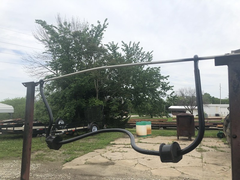

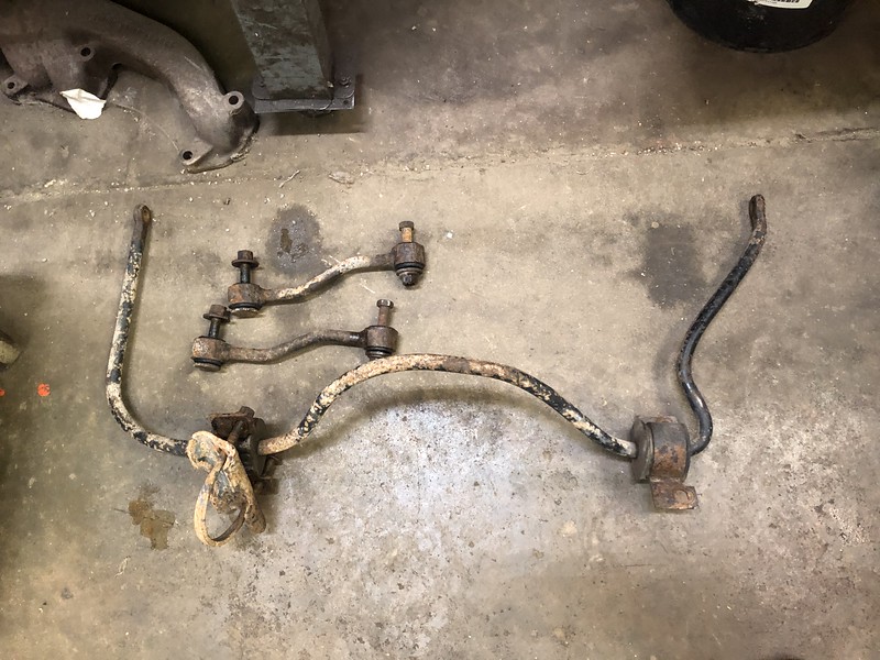

Rear sway bar is blown apart:

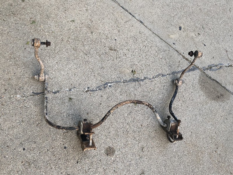

Cleaned up and painted:
'85 Ranger Restomod
