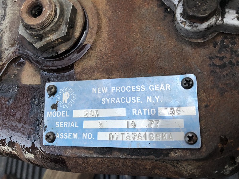

A guy posted in the V8 swap forum about what t-case fits the best. After my recent discoveries how big the NP208 is I suggested a NP205 for its compact size.
Then it hit me, why am I dinking around trying to piece together a Jeep 208 and a Ford 208 if I can just buy a Ford 205 that is basically ready to go? Still going to have to buy another t-case either way. Won't have to buy the extra thick clocking ring or cut down my output shaft. I will have a completely resealed Bronco NP-208 try to resell instead of a bunch of basically junk parts parts.
I talked him down some but here it is, I pick up it up next Saturday (wife has to be in Omaha then so I will already be halfway there)

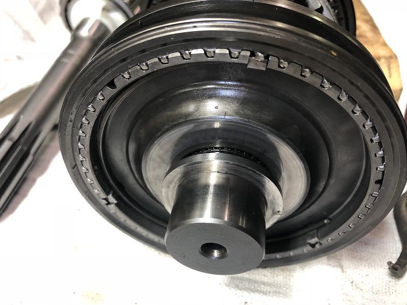

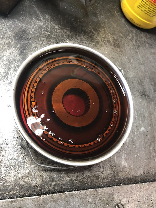

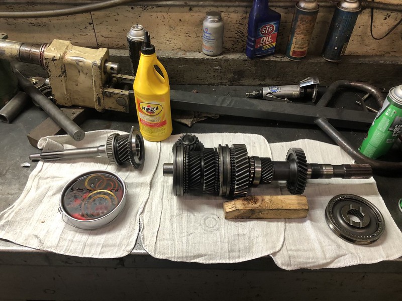

Starting to go back together. Cleaning/soaking parts. Brought it to work because I didn't think it was too good of an idea to be spraying brake cleaner next to the furnace in the basement...
Continuing on...

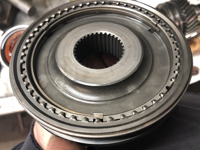

Cleaned the cosmoline off and soaking the syncro.
'85 Ranger Restomod
Before:
'85 Ranger Restomod
During:
'85 Ranger Restomod
That really makes it look bad when you look at it edge on:
'85 Ranger Restomod

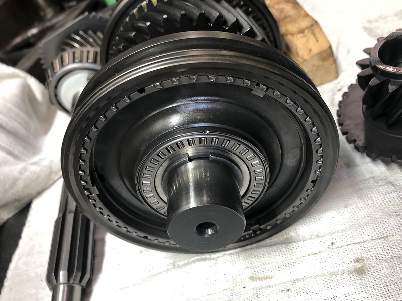

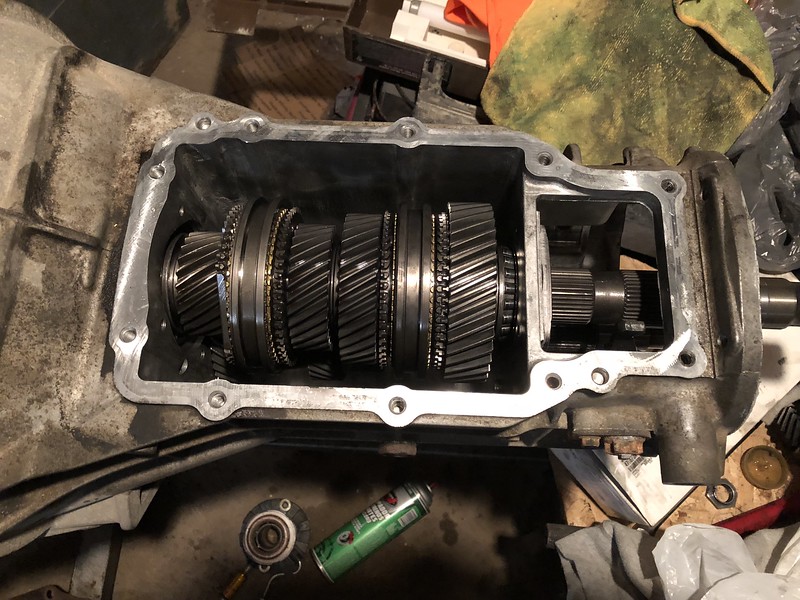

Trans is set back together.
'85 Ranger Restomod

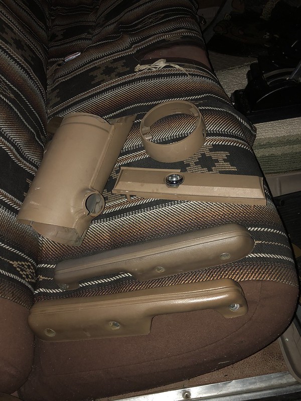

Swung by Lincoln U-Pull-It while I was there, found some nice interior trim pieces.
'85 Ranger Restomod

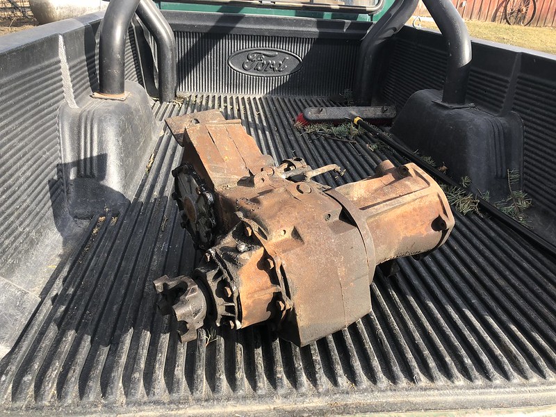

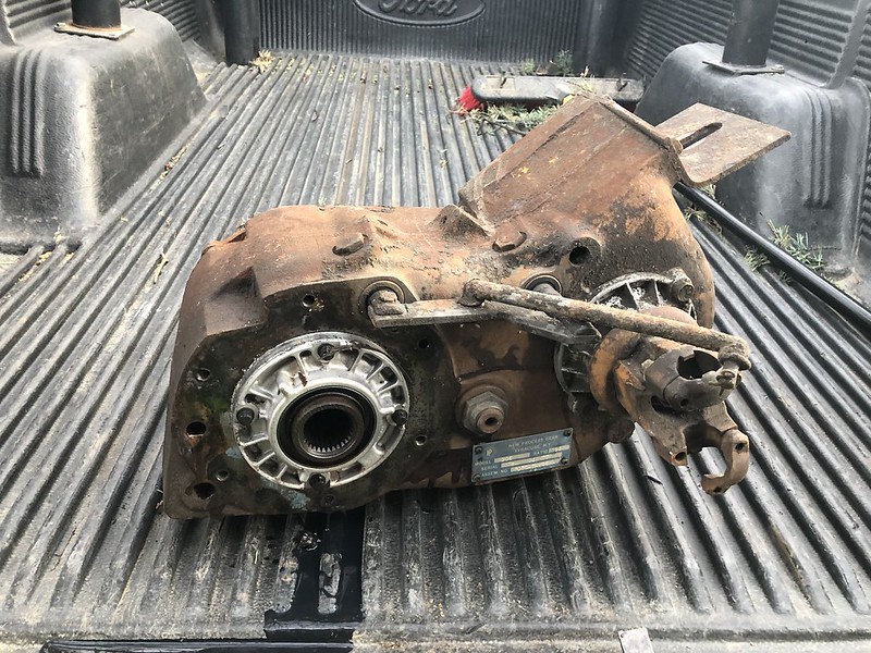

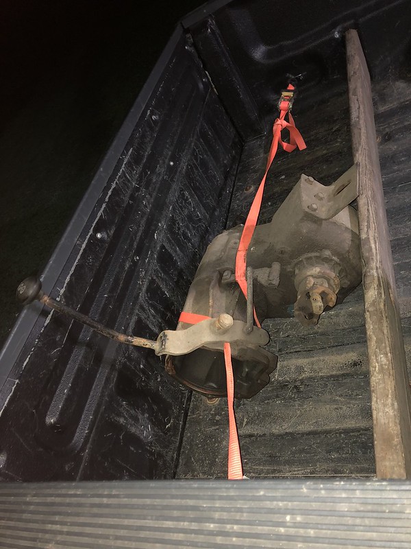

Theres the beef!
'85 Ranger Restomod\
It got into the 50's today so while it was loaded I gave it a bath. Kind of a bugger to move around, it is heavy (130-180lbs dry depending on where you read without the cast iron extension and lever) but it is a combo of it being hefty and no good place to grab the thing that makes it hard to sling around.

Looking forward to seeing it in your truck
It went right in, just swims in there. :icon_thumby:

It was sold as a '79 but I think it is a '77. Makes no difference to me either way, tag is cool though.

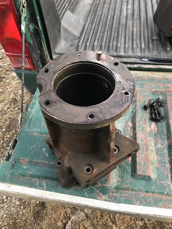

Popped the extension off to lose some weight, struck oil. Not sure why it started leaking after I took that off.
'85 Ranger Restomod
I think this will bolt on my my M5R2 and be the foundation of a stand to hold the trans upright during the input bearing setup. :yahoo:

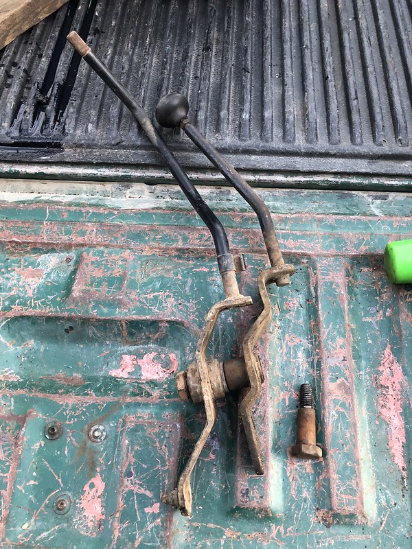

Random thought I had. I think it could be made to work but by the time I make the linkage and weld new shafts I don't know if it would be really worth it vs $135 for a twin stick kit. Dunno, I will keep playing with it.
'85 Ranger Restomod
I do have a couple different ideas that have hit me so far. Cut off the bends and make a clamp on lever like what I have for my current t-case so I can adjust the lever angle if I want. Or... (ideally) cut the shifters off entirely and weld flat stock onto and bolt on two FX4LVII shifters (I have one right now) Not sure how much if at all I am going to clock the t-case and where the shifters are going to end up coming thru the floor at makes the two piece lever more appealing. I could get the bottom set up and done any time. And then as soon as everything is in the truck I could tweak the upper lever to fit.

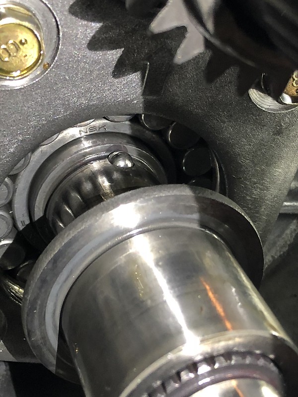

In taking apart the trans I lost a ball, the shop manual mentions it neither when tearing down or reassembling. Parts book actually shows it in front of the rear countershaft bearing. I found it laying in the bottom of the trans case and had no idea where it went. In comparing fit between it and the other 5/reverse detent ball I managed to launch it into low orbit never to be found again. The earlier transmissions used the same ball for both positions, mine has a smaller one on the countershaft. I could only ever find the part number for the bigger one (99611-2500)
In my experimentations a John Deere 400R ball fits nicely.
'85 Ranger Restomod
Not something you read every day! :icon_twisted:
Glad you got this sorted. When I took mine apart, I made sure I had a magnet on hand to hold those little guys.
