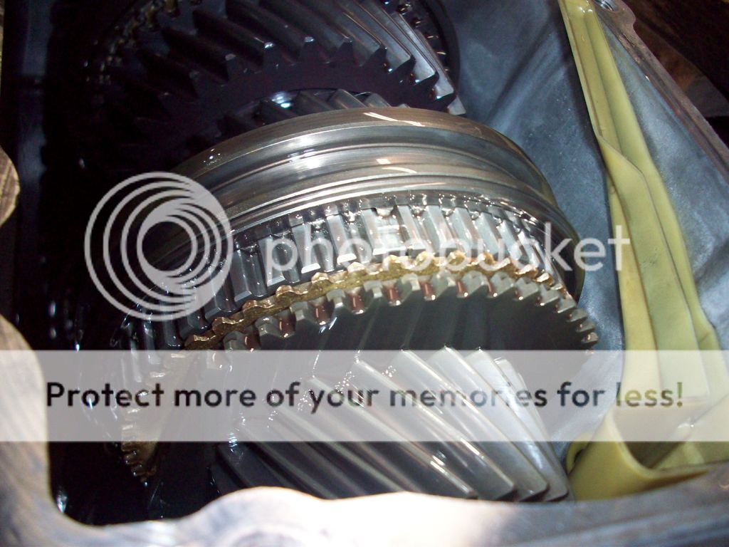

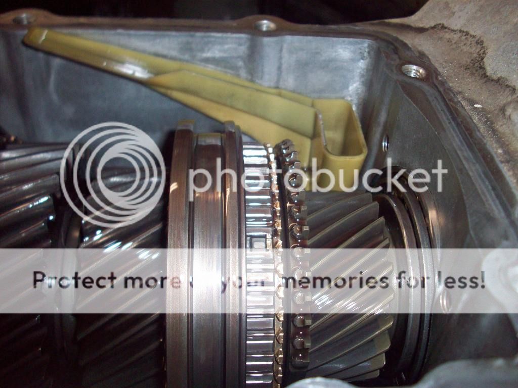

My brother was over (he is a Sr Master Tech) and I had him give it the what for and he didn't like the slider and ring for fourth.
'85 Ranger Restomod
'85 Ranger Restomod
So my parade got a little bit of rain... not too bad though. It looks worse in real life than the pics show. So I need a input shaft and the slider. Being a +99 I am not going to mess with the $350+ syncros.
