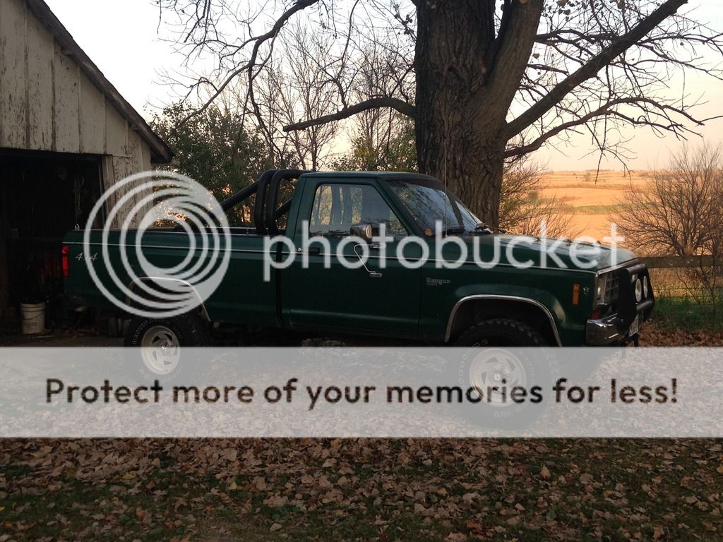

Anyway the fuel tank is in, it runs and the new springs are in. I love the stance over the slightly tail high stance it had before. I think it is pretty close to the factory rake.
'85 Ranger Restomod
Managed to catch the sunset after I got gas during the test drive.

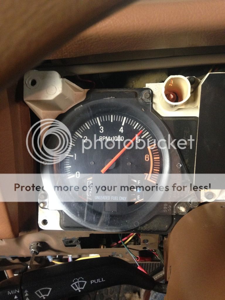

Tach is in! :yahoo:
'85 Ranger Restomod
It reads half again too high but it is in... I have an email into Baker about what to do about it. Kinda weird to cruise down the highway at 4500rpm.

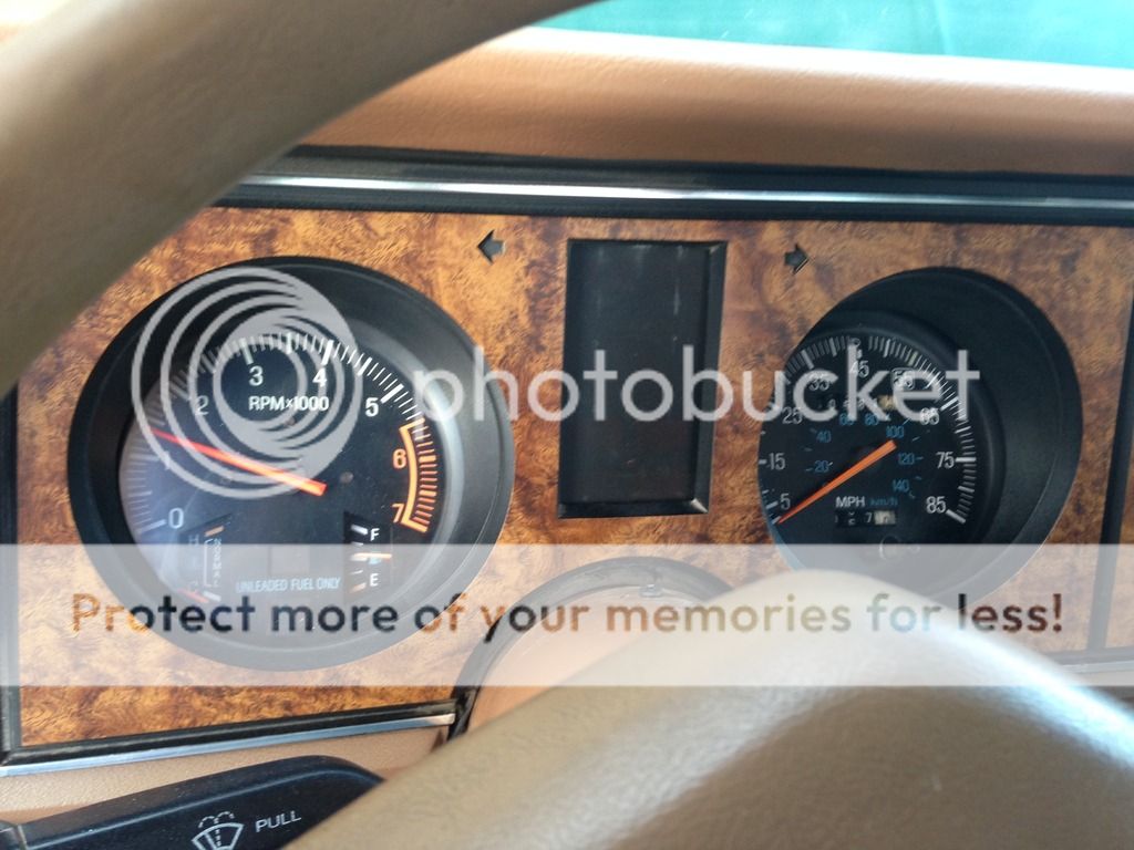

One thing that hit me on the way to work this morning is in the write up Shran made he mentioned something about putting the tach wire on pin 3 or 4 to match the donor. My donor was on 4 so I left it there. 3 has nothing in it.
Looking at the pic of my cluster both go to different parts of the tach... me is wondering if the pin changes with engine displacement.
Whatever pin #3 is good for... it ain't that.
'85 Ranger Restomod
Must be some kind of ground, note the turns signal indicator was dimly glowing. When I shut the engine off the tach stayed pegged at 7k, I moved it back to 4 and it worked "normal" again.

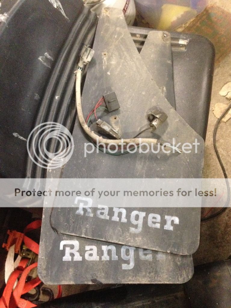

Also got the harness for the capacitor to see if that makes a difference (I doubt it will) after that I think I will just send my module back and have it reprogrammed. Even found a neat pair of mudflaps, might try to revive them a little (kinda warped and faded)

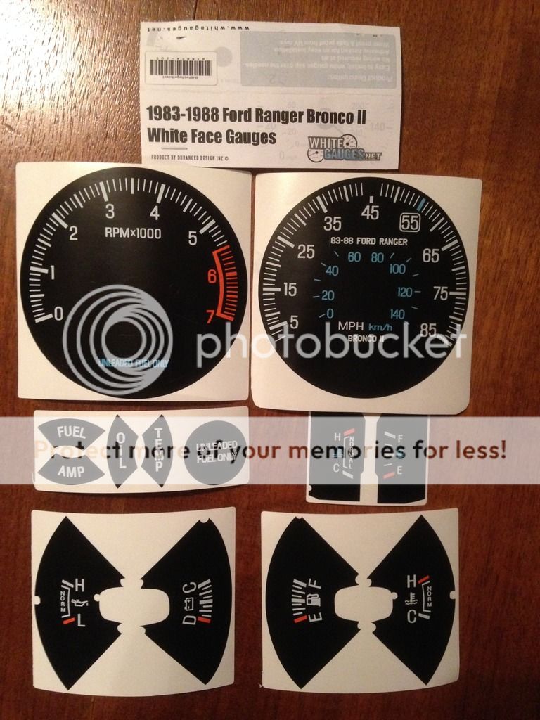

I ordered gauge overlays from whitefacegauges.net. To get anything other than white it is special order which isn't cheap but they have a ton of options. Overlays look great, I guessed semigloss for the OEM it is a little glossier than original. Matte would have probably been more "correct" but oh well. Carbon fiber was very tempting... Gripes are not too bad, the red range went about 1/4" farther originally and the hole for the speedo needle could have been bigger. The font is a tad heavier, should make it easier to read. I also got the install kit (a spray bottle a small 3M squeegie and a razor blade) and the florescent orange needle paint.
Paint is kind of a specific thing, this stuff grabs light very well. Judging by the unfaded areas of needles in the gauges and pictures in my brochure this stuff matches very well. I did it on the living room side of the kitchen, it is freaky how well they light up with the kitchen light off just catching light from the living room... it may also find its way onto front rifle sights. The brush in the cap is really really stiff, I used a fine Tester's brush instead.

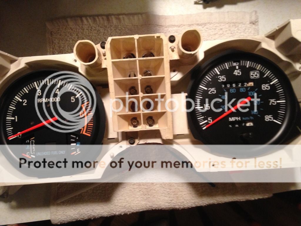

'85 Ranger Restomod
'85 Ranger Restomod

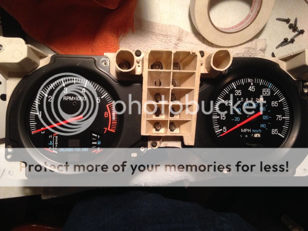

Big needles are painted:
'85 Ranger Restomod

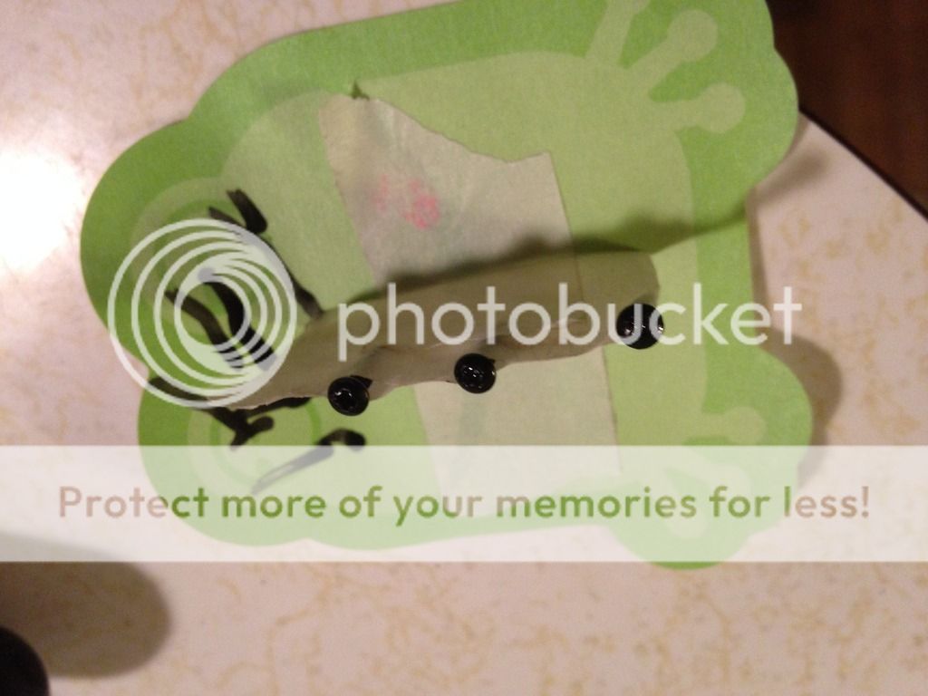

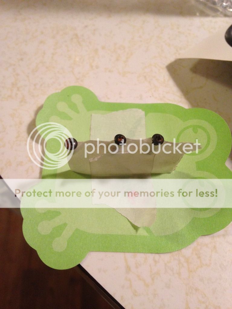

Threw some Testers flat black on the three screws that hold the tach face on the cluster.
'85 Ranger Restomod
'85 Ranger Restomod

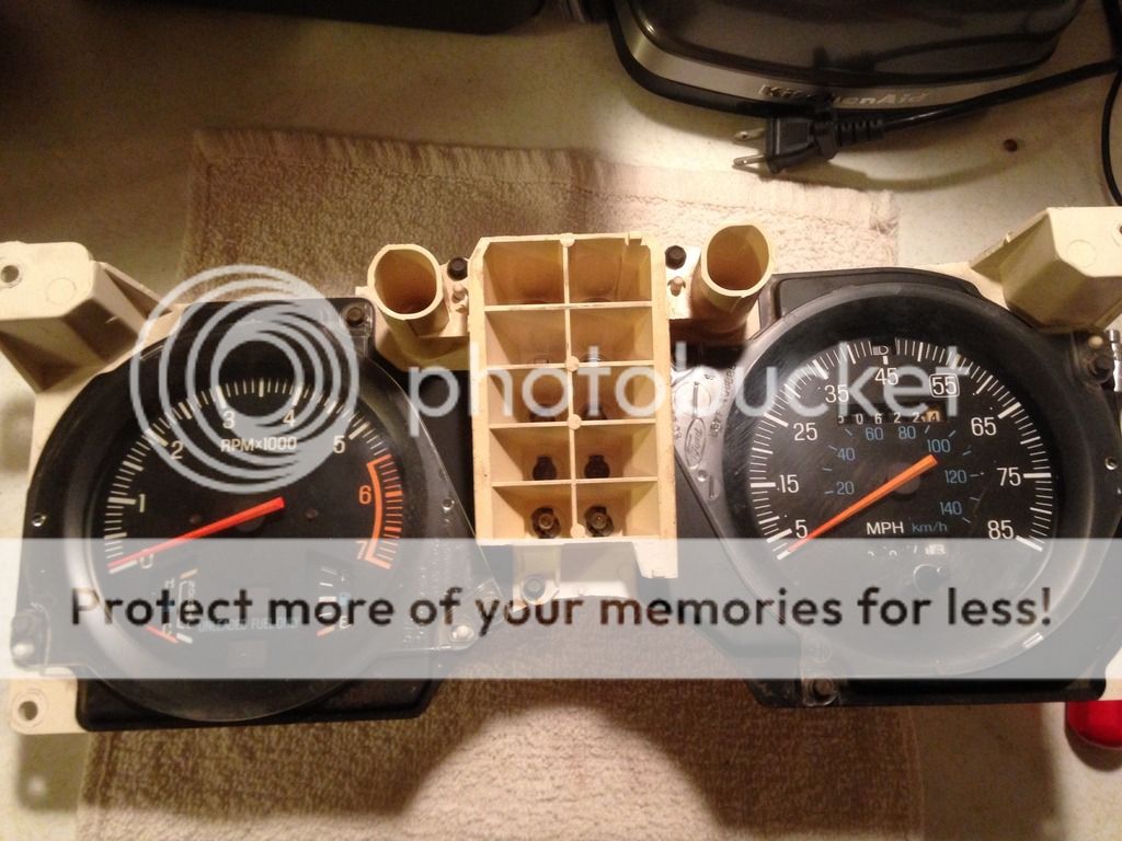

Note how the red range doesn't quite go past the 7 like original, the whole range is more squished, not sure why they did that when they knocked it out of the park everywhere else.
'85 Ranger Restomod
Pretty much done, going to replace the 194 bulbs while it is out too.

I got an email from whitefacegauges asking how I liked their product and if I had any issues.
So I told them they could make the hole a little bigger and the red range on the tach was different than original. Didn't pitch a fit or anything just said you might check into it for future orders. They sent me a pic of the gauge they went off of and sure enough it was like the decal I got. Both my '88 clusters look the same. So they are designing a new one and are going to send me one. :D
Well you pointed out something that we didn't know. Looks like you have a slightly different version then the scan that we have, see attached picture. I just checked and see that we have a version of your tachometer in one of the clusters we have so if it is okay with you I will push this through and get a correct version out to you. If you dont want to worry about it please let us know but getting a revised version out in the next couple of days is not a problem.
So beware I guess, there are different styles of tach faces floating around out there. I wouldn't have done anything but I can see the lines under the overlay.
