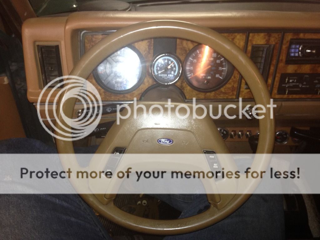

It is amazing how nice ranger dashes and steering wheels clean up despite the neglect they get.

Here you go, I even pulled the steering wheel and did the back side too.

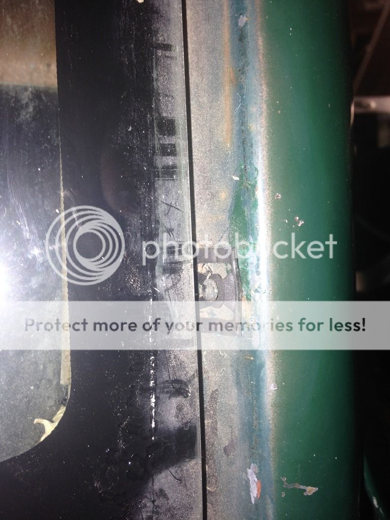

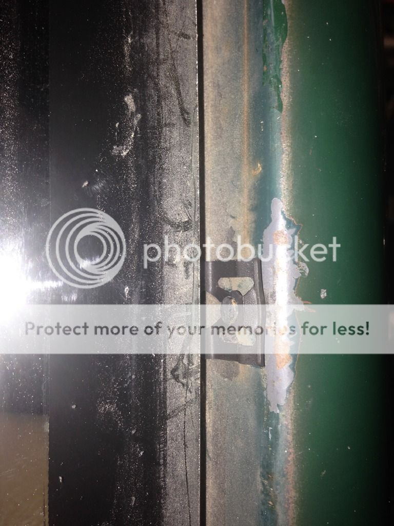

I had words with one of the studs for the windshield clips, it is set down in there like 1/8" too far to reach the trim. Probably why the old trim was mashed up and it wasn't latched either.
'85 Ranger Restomod
'85 Ranger Restomod
Otherwise it is on, going to see if I can find a longer clip for the one corner.

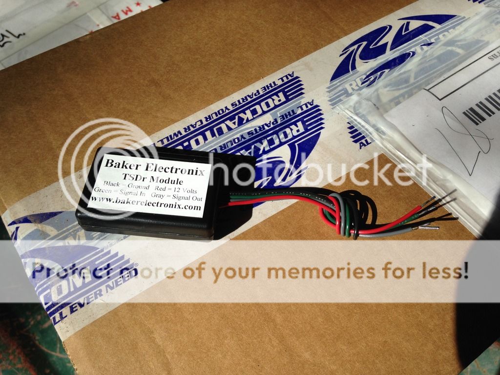

I also ordered a module so my factory V6 tach will read correctly with an 8cyl. The 3/4 multiplier TSD with a green LED to be exact.
http://www.bakerelectronix.com/products_tsd/

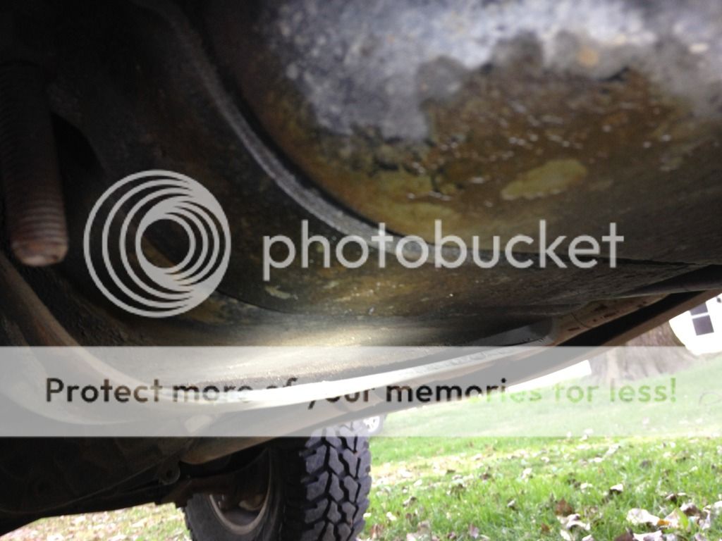

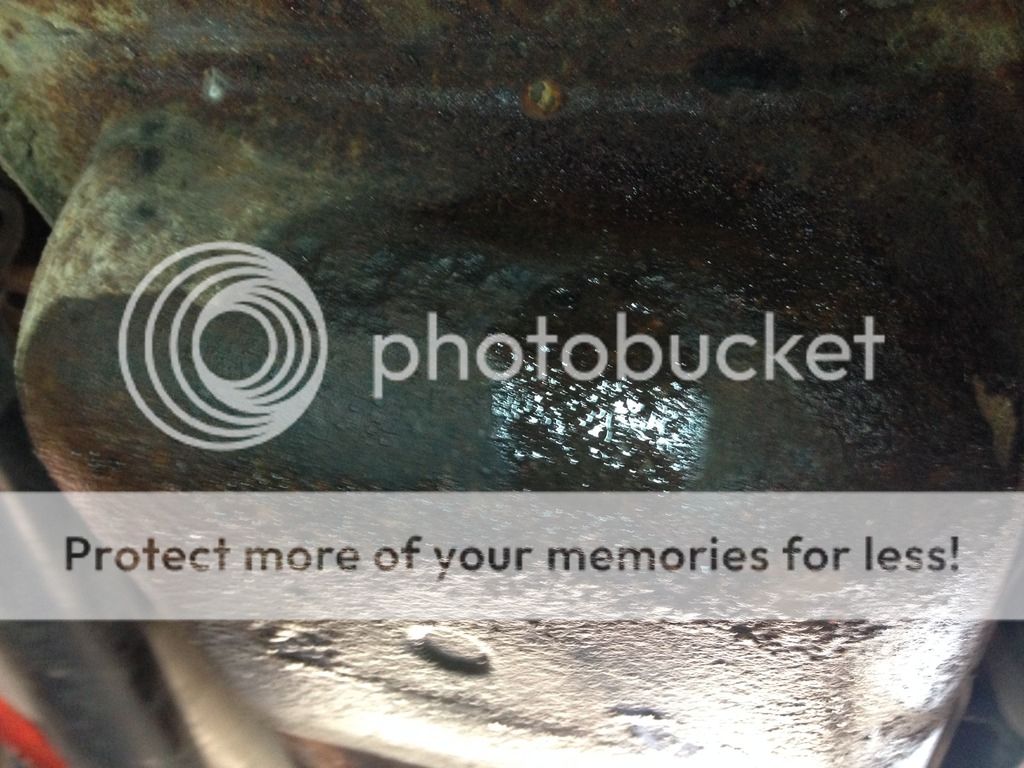

First things first, the fuel leak...
'85 Ranger Restomod
I can see "stuff" packed between the front deflector shield and the tank itself
'85 Ranger Restomod
The front strap that holds the shield in place came out like a dream... to reveal yuck.
'85 Ranger Restomod

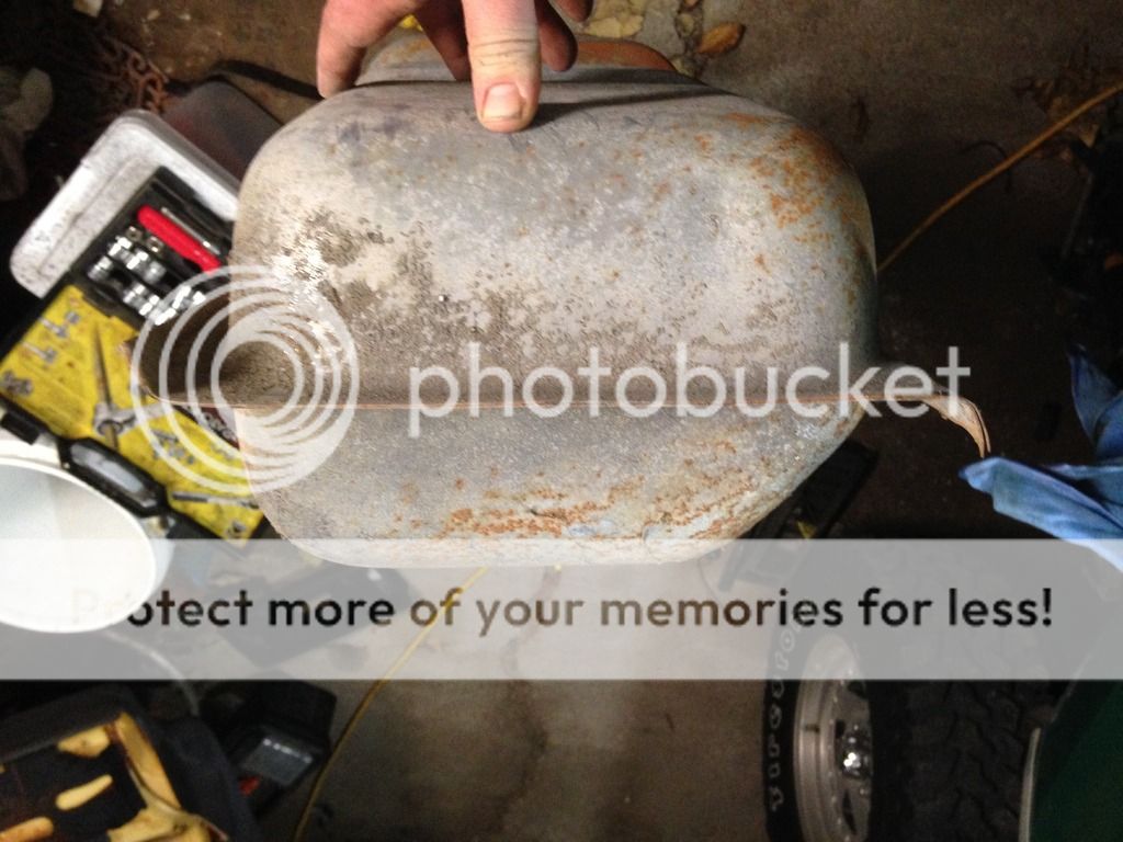

I can't see hole but as soon as I wipe it away it comes back. Later as I was dropping the tank it and it was nose down it did have a stream.
'85 Ranger Restomod

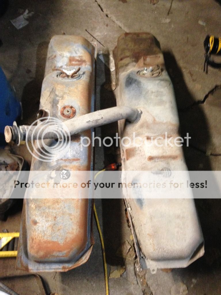

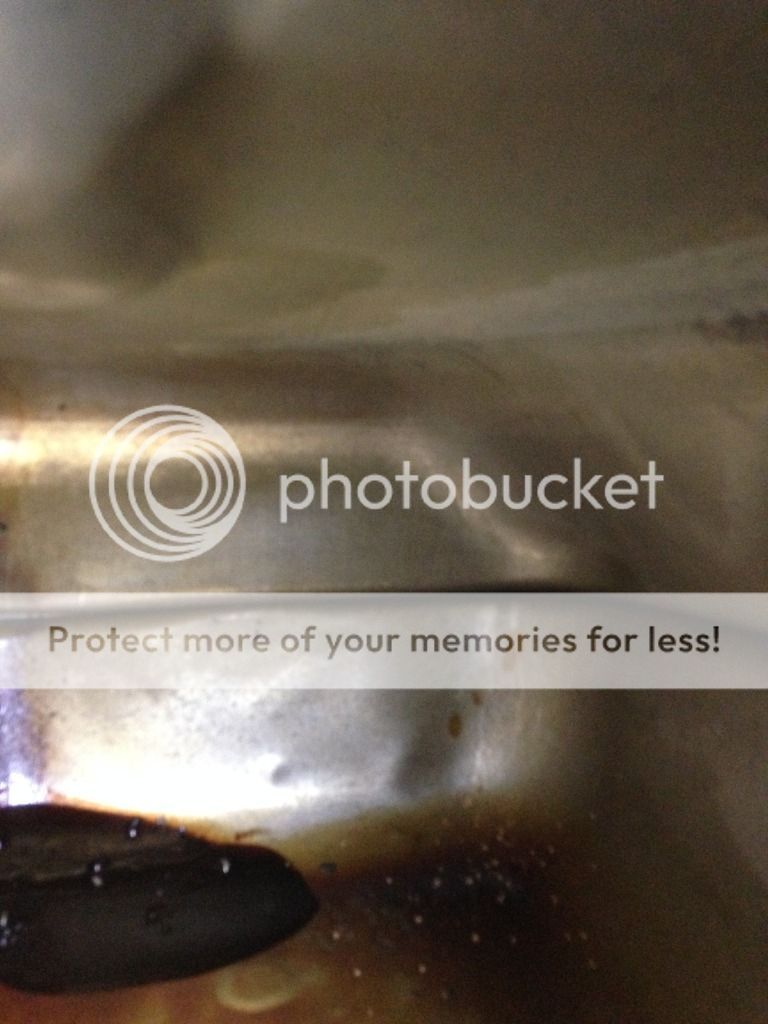

For as pitted as it was I could see it didn't have much of a future left, luckily I kept the tank out of my '86 parts truck from 14 years ago. Which aside from a puddle of varnish in one end and minor exterior surface rust looks perfect inside and out.

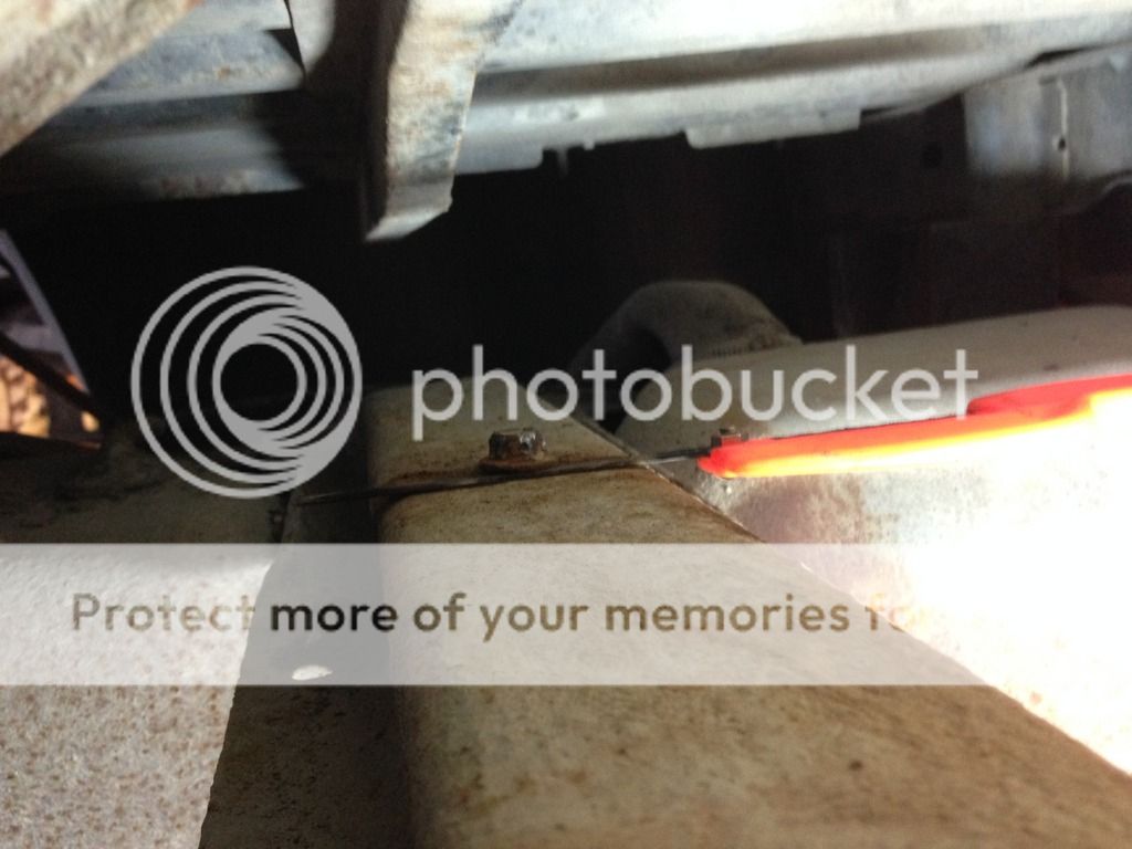

So I move onto dropping the tank... which royally sucked thanks to this guy:
'85 Ranger Restomod
I got it backed out 1/4" and it would have no more so I took drastic measures... thank god for bodylifts BTW.

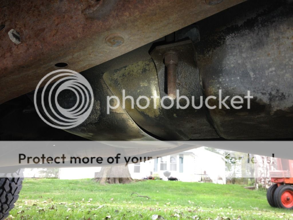

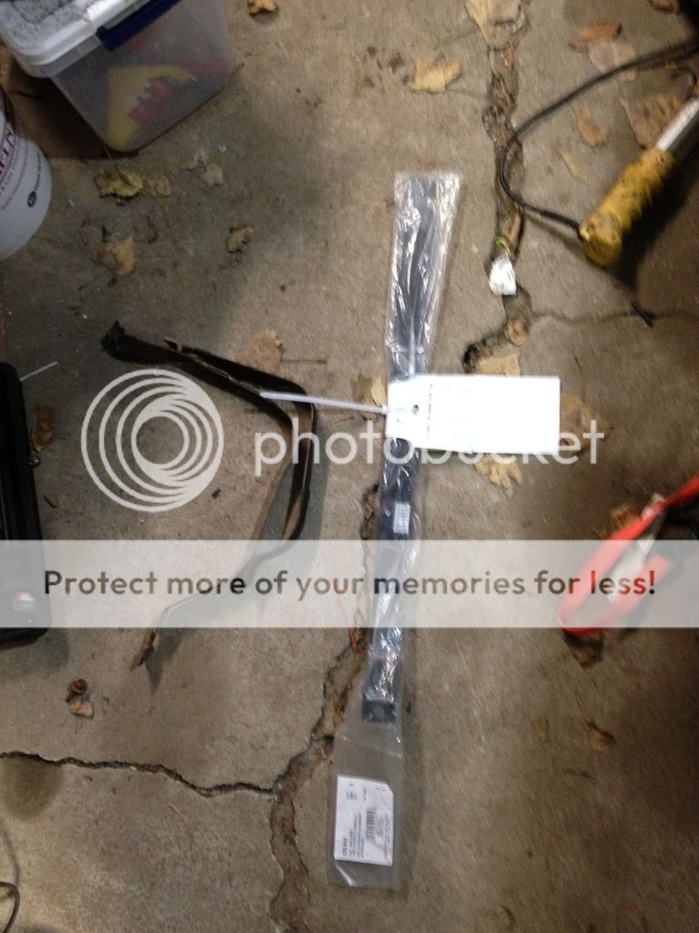

New fuel tank straps, one came out very polite, the other is trying to twist apart.

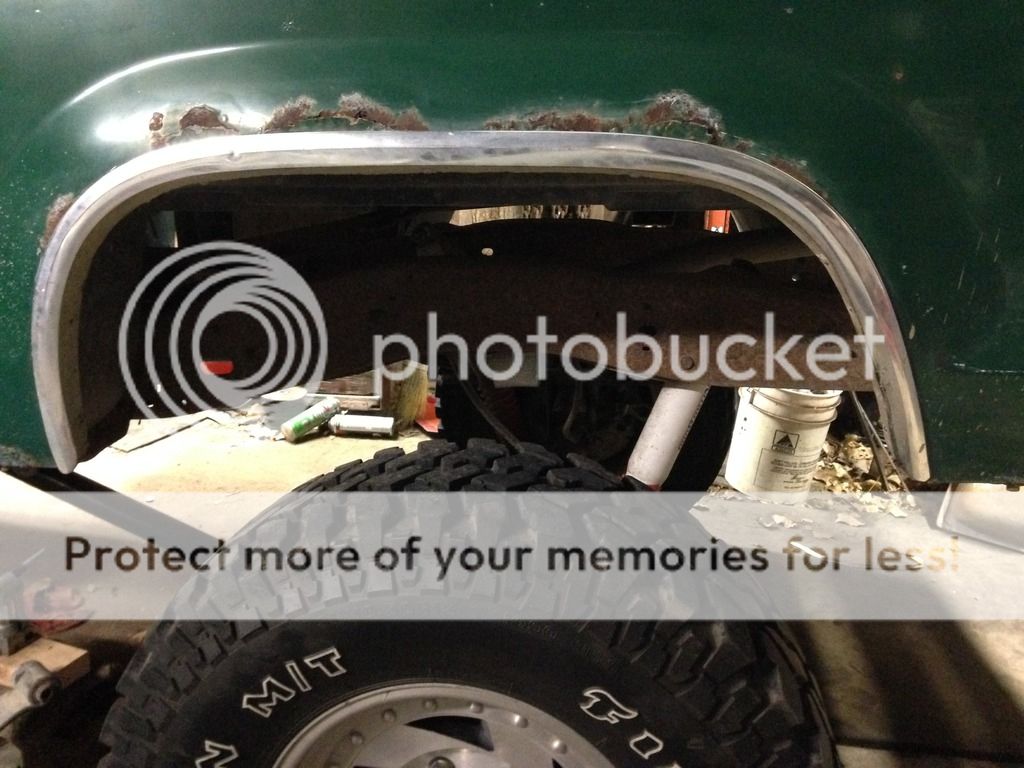

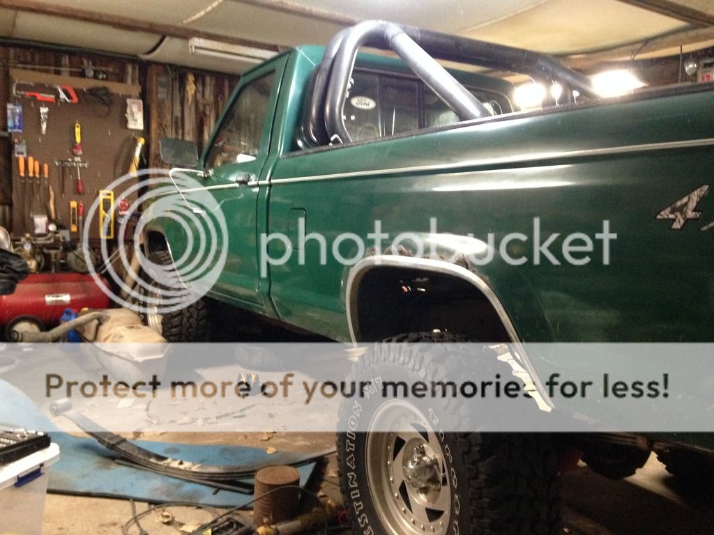

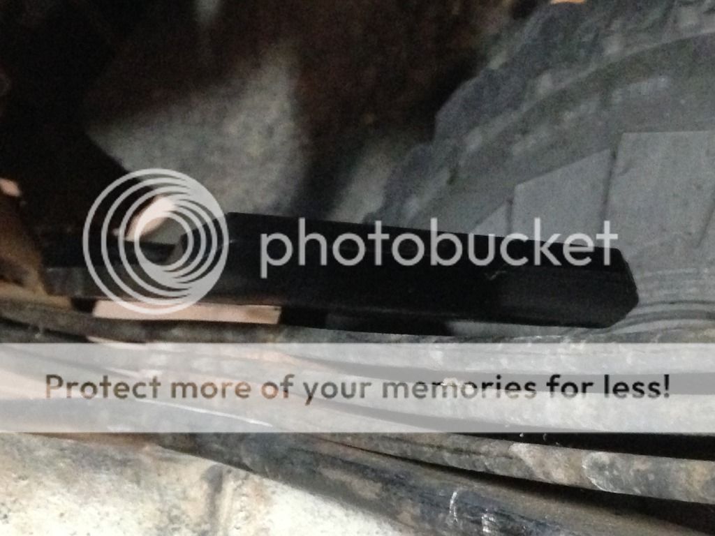

I received a pair of low mile 2010 Ranger springs from a Scab, the guy thought they were too soft. I think the Ex springs are too hard so it seemed like a plausible swap. Also wanted to trim the u-bolts that I have wanted to do for 5 years but never gotten around to it.
'85 Ranger Restomod
Looks so unnatural.
'85 Ranger Restomod
Might have helped the rake some, hard to tell inside. I don't know if it is going to be a huge difference.

Tach signal adaptor so my factory V6 tach will read correctly with a V8. It will be a few weeks before I get to it, we have engagement photos in two weeks and I don't want to open that can of worms yet, I have enough worms flying all over the place with what I have going on already. :sad:

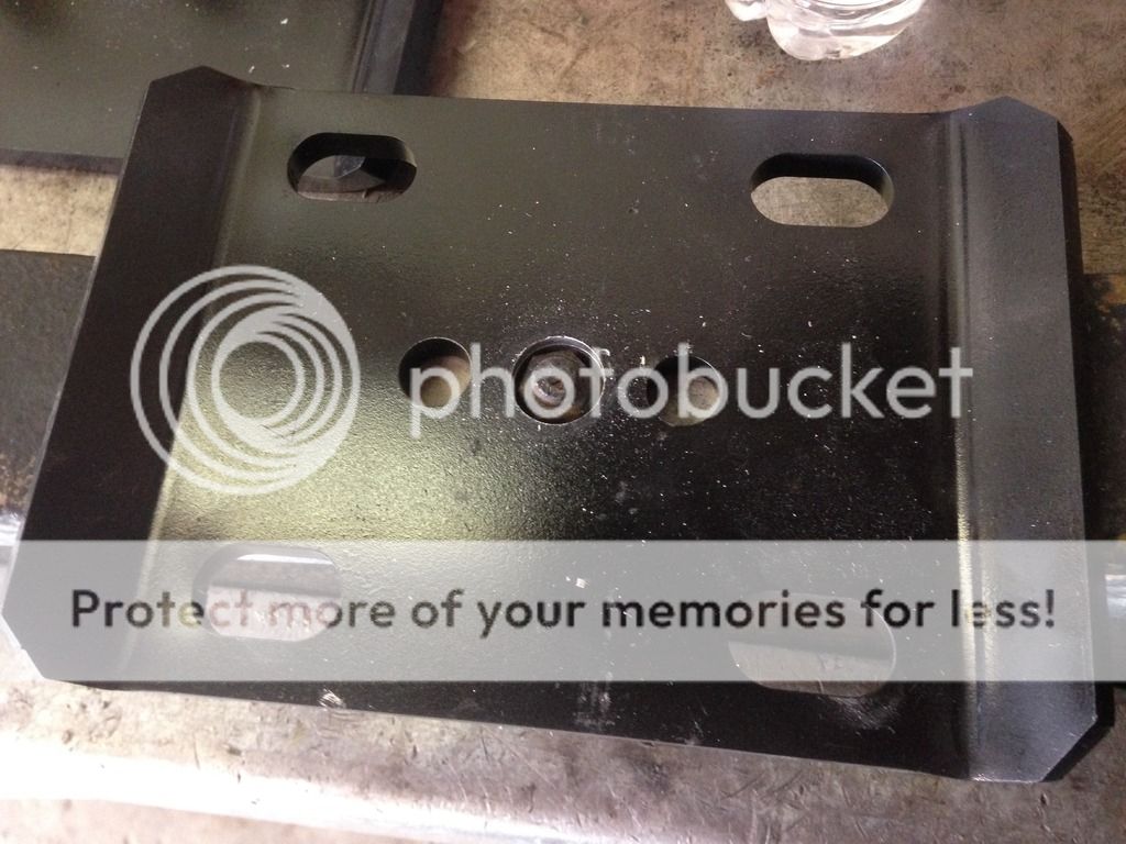

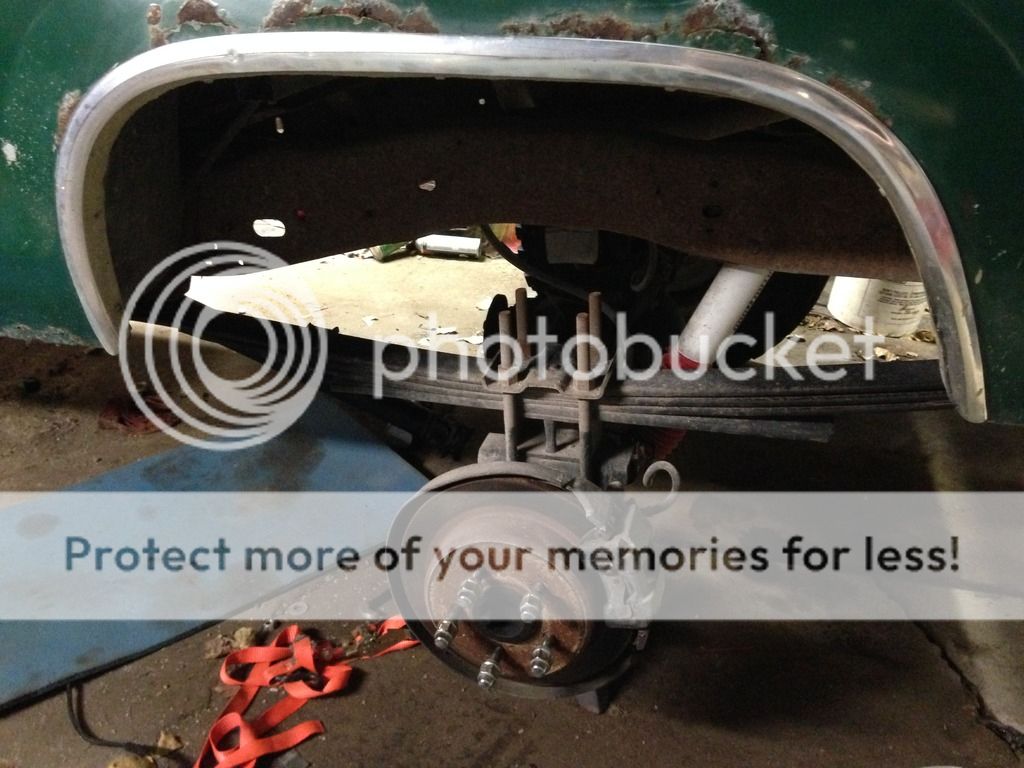

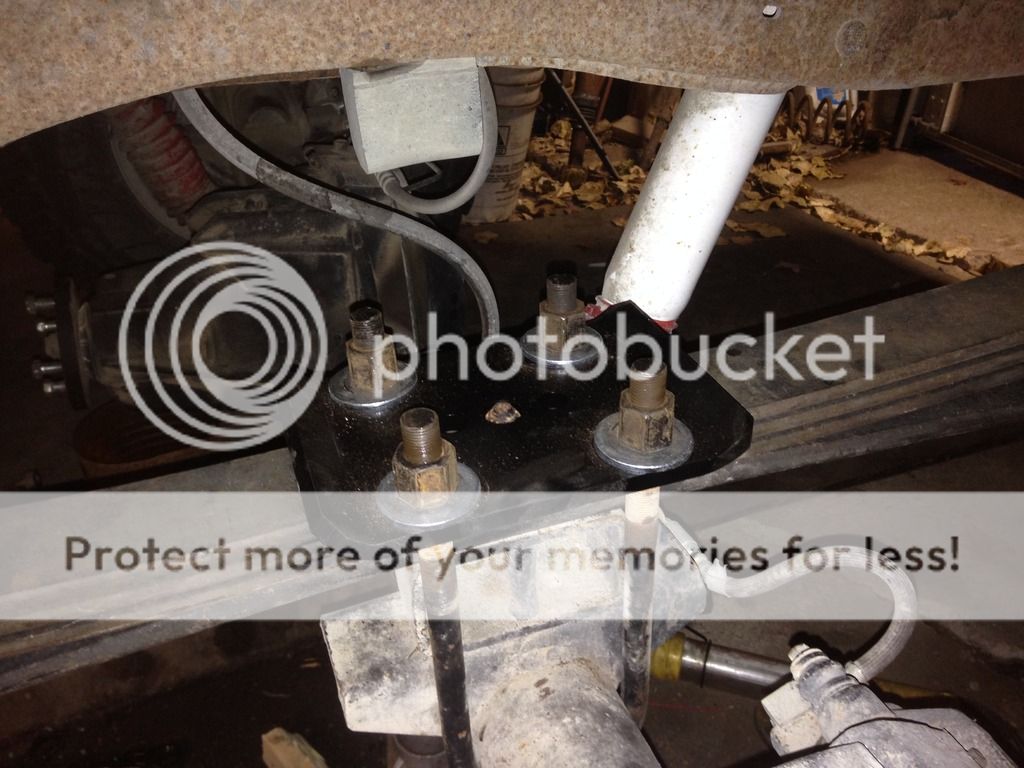

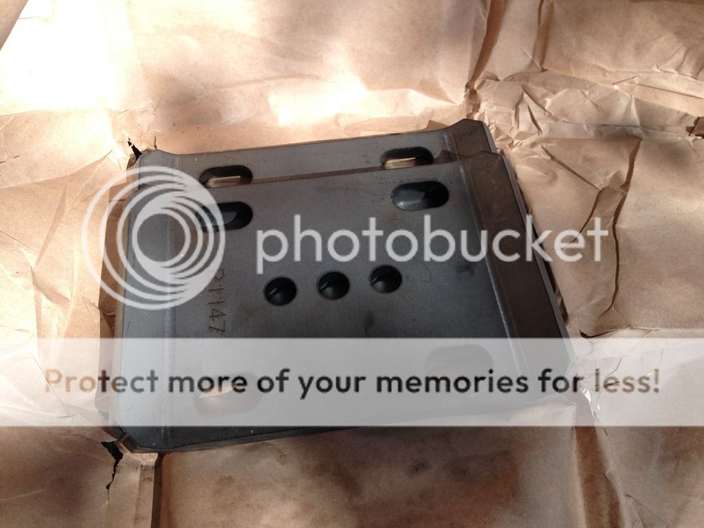

I made F-150 spring plates fit 5/8" bolts back when I put the axle in, finally going to just put plates in that are made for the bigger bolts. (from RuffStuff)

Need to finish getting varnish out of the tank and it should be running to flip the truck around in the garage to swap the other spring/spring plate.
This pretty much sums up Monday night. The brake line needed an adaptor to fit into the front splitter block. Then I slipped off the spring plate to put on my new one and the center hole was too small for the bolt that holds the spring together. I did get the fuel tank washed out though.

I drilled out the holes today and got the one put on tonight:

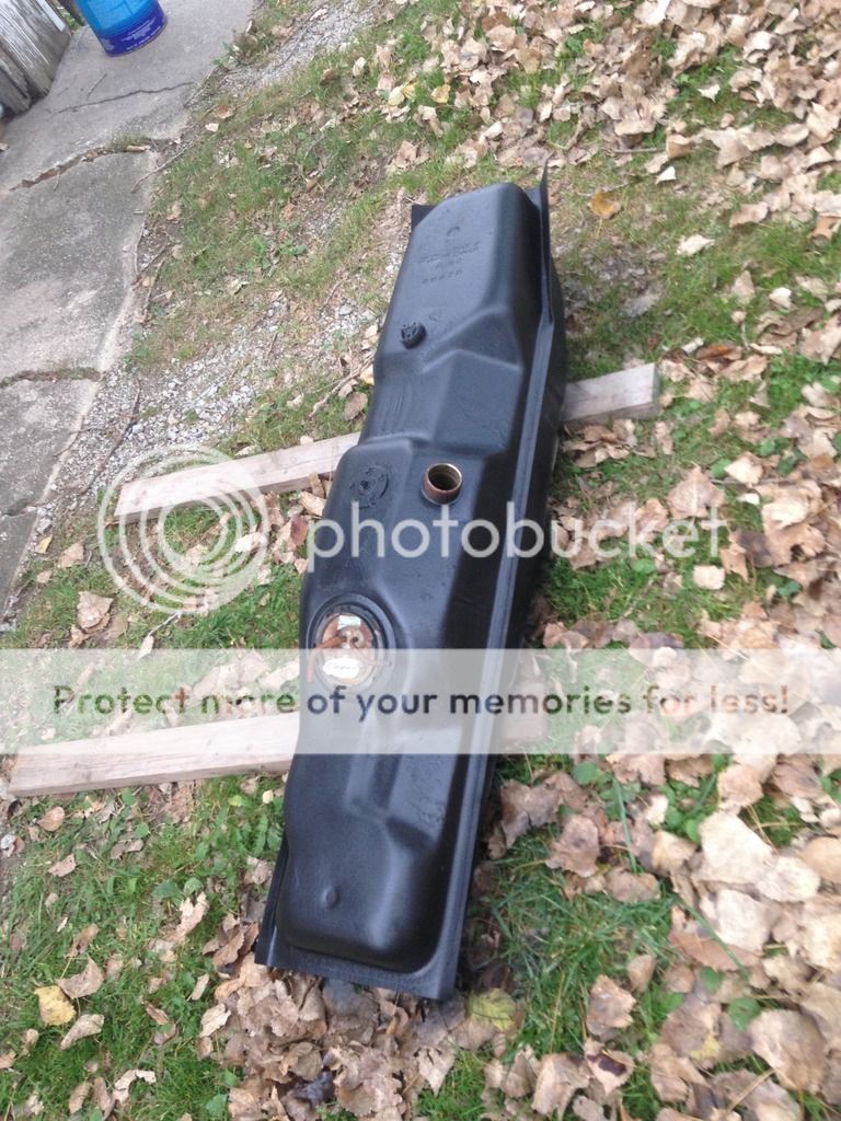

I also got the top 3/4 of fuel tank bedlined.
