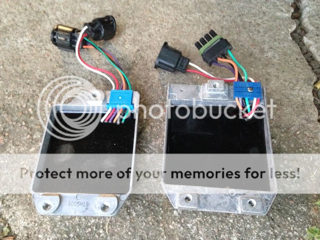

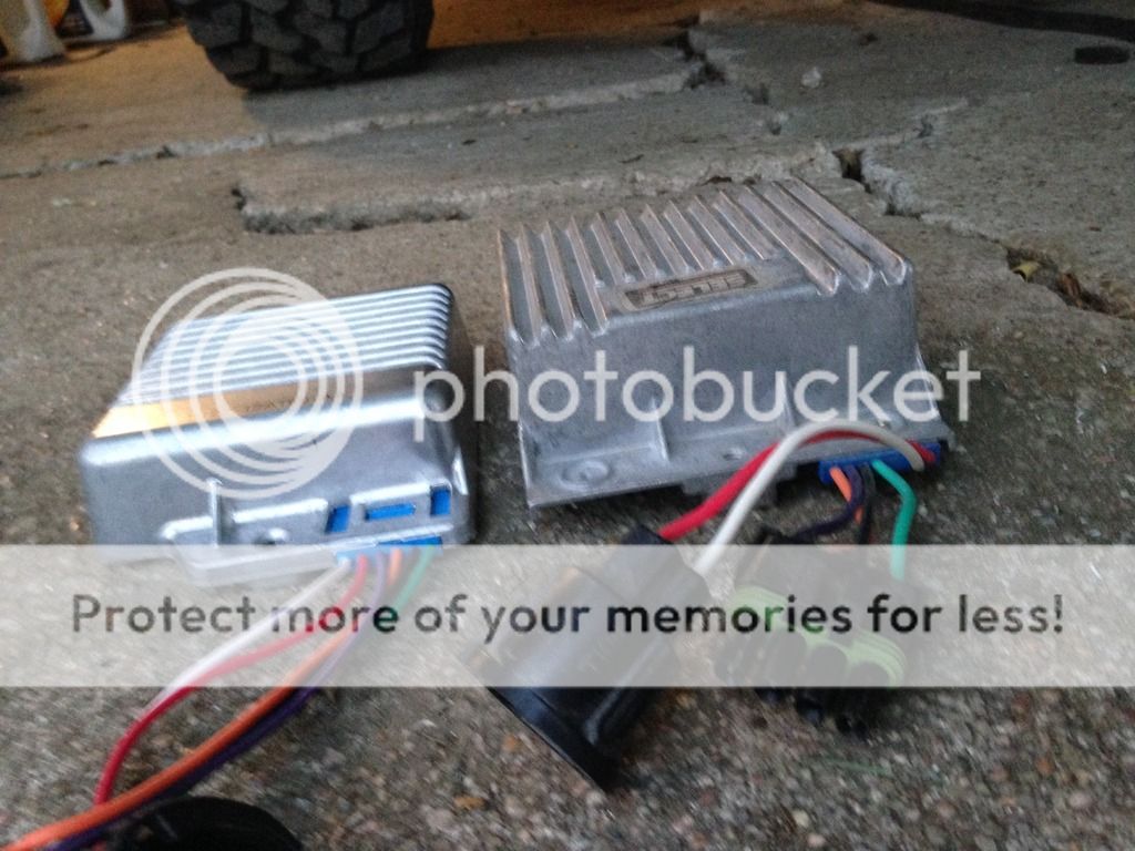

Fixed the ignition harness with a factory plug so I can quit violating ignition module warrenties and installed my Motorcraft module. Runs great. Put a factory pigtail on my spare parts store module and threw it under the seat to ward off evil spirits.

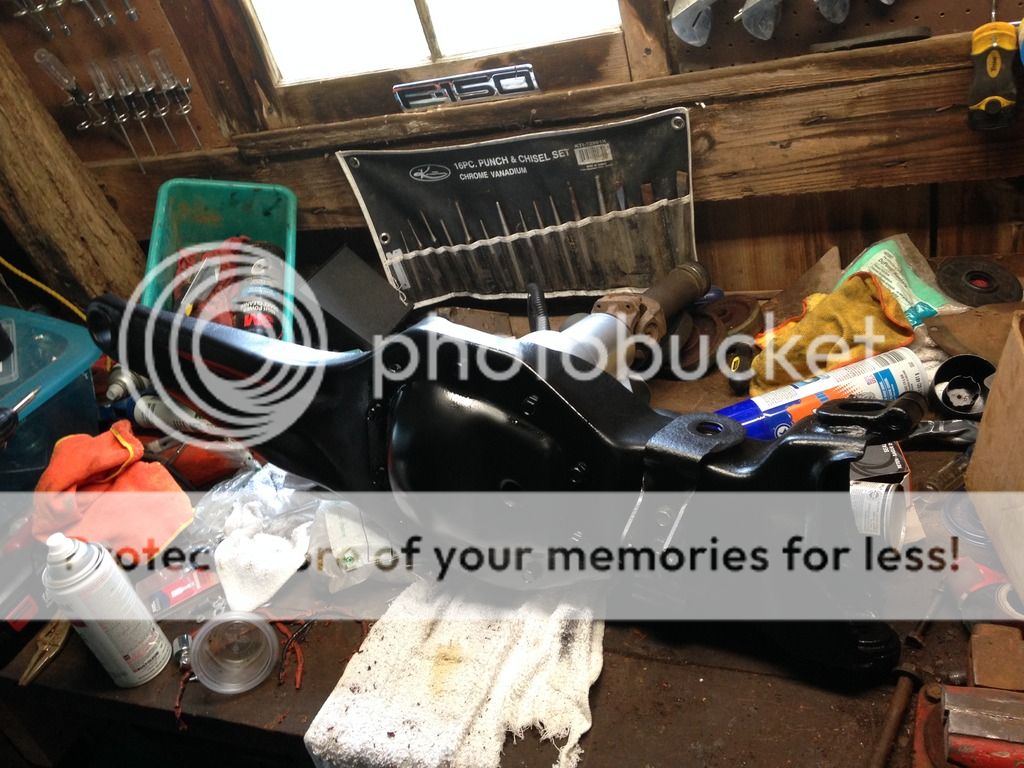

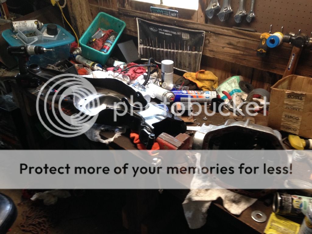

I need to clean up the bolts, put the diff back on my axle beam. Then it will be more or less ready to swap but I am not quite ready to knock the Ranger in the head for that...
