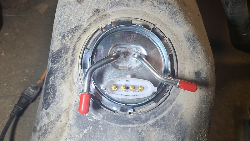

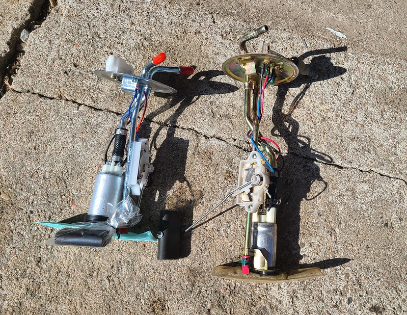

Gold star for Oreilly's! New on left, old on right.
'85 Ranger Restomod

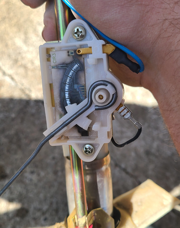

I can kinda see why the sender was flaky. As far as cleaning it the contact board is like part of the plastic as in I can't actually feel the metal. Pump is shot anyway and the contact assembly looked a lot better on the wrong pump.

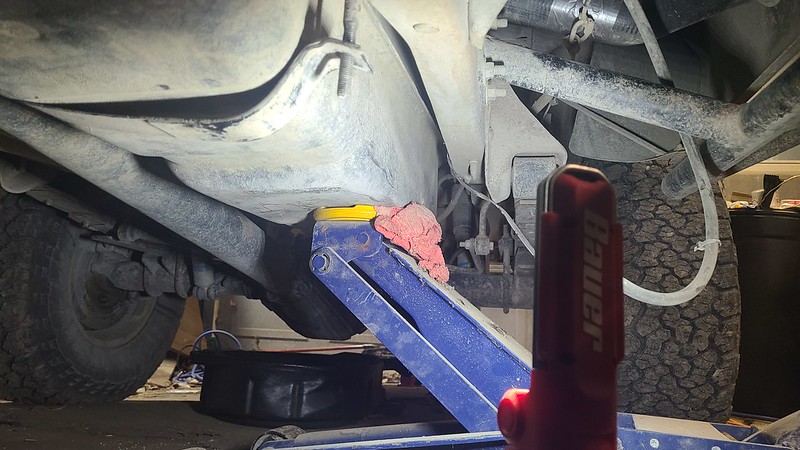

One thing that has always made me queasy with these aftermarket in tank pumps... if they die you are dead right there if you can't thump it back to life. And it is a rather messy affair to swap the pump on a whim.
Well the old Holley pump hasn't missed a beat since its one glitch, I kinda wonder if it had a piece of something it or something. So when i redid the wiring to switch back to a in tank pump I put a connector on the wiring going to the in tank pump... and on the Holley perched on the frame. So if the in tank conks out on the road I cut the hoses and switch them to the Holley, plug the wiring into it and keep going. Maybe to the hotel parking lot, maybe back home. I like having that fallback/spare for something so critical.
I need to run a new ground for the pump and switch the fuel lines around yet... but I got until Wednesday.

Your new fuel pump assembly looks shorter then the original. I ran into that one time and was only getting half a tank use out of it. I really dont have problems with in tank pumps as long as you keep them at least an 1/8th tank full for cooling the fuel pump. Slowly catching up on your thread. Congrats on your truck turning 40. I remember them when they were new.
Your Jerry Cans turned out nice. Its been a while since I used Evaporust and seems like it does a great job. White vinegar does a great job as well.
Yeah, I need range. Half a tank ain't gonna cut it.
The one I am replacing is 5yo, pump worked for 3 years and the level sender for four. Possible cause of death for the pump, undersized lock ring wouldn't stay in place which isnt great when I live on a gravel road.
Another thing that would probably help is if I got a pressure regulator with a return so the pump isn't deadheading against my non return one.

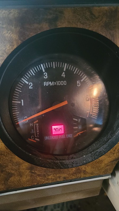

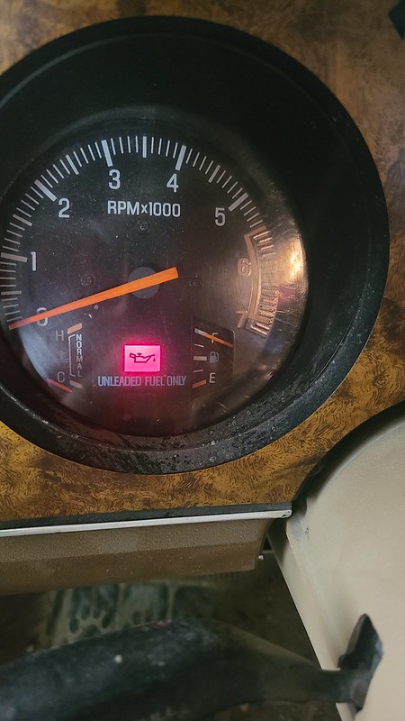

Fuel pump was finally delivered:
'85 Ranger Restomod

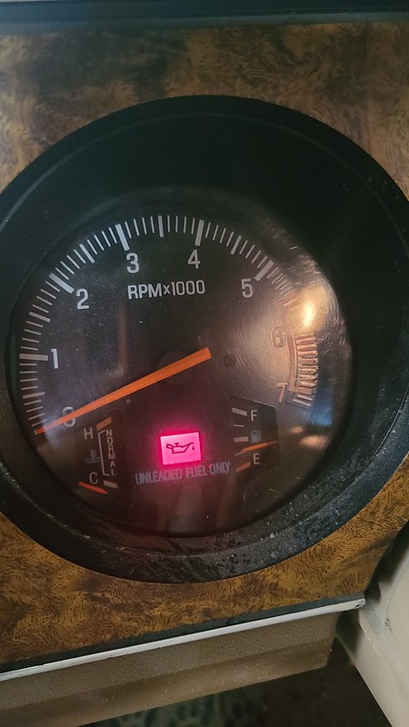

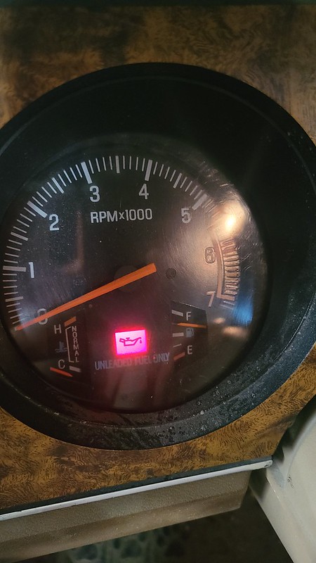

Test the level sender right off, looks great.

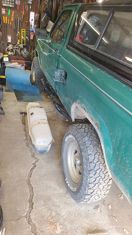

Lifted into place, such a relief to get at least one strap on. Rear is always a fight with the driveshaft in the way of everything.
'85 Ranger Restomod
And its all back together. I didn't try to start it but it runs nice and quiet and has pressure at the carb.

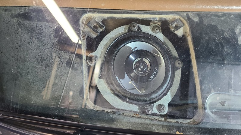

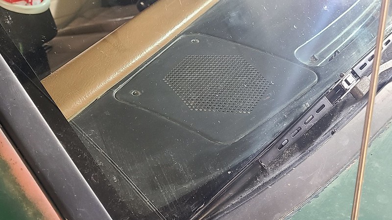

Recently the front speakers have kinda gotten bad. Hard to make out the stereo... and if you remember I have the GMRS radio plumbed into them... really wasn't super clear last fall for that matter.
The old Polk speakers were pretty old, circa 2001 or 2002 by my recolection.

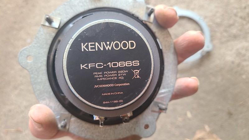

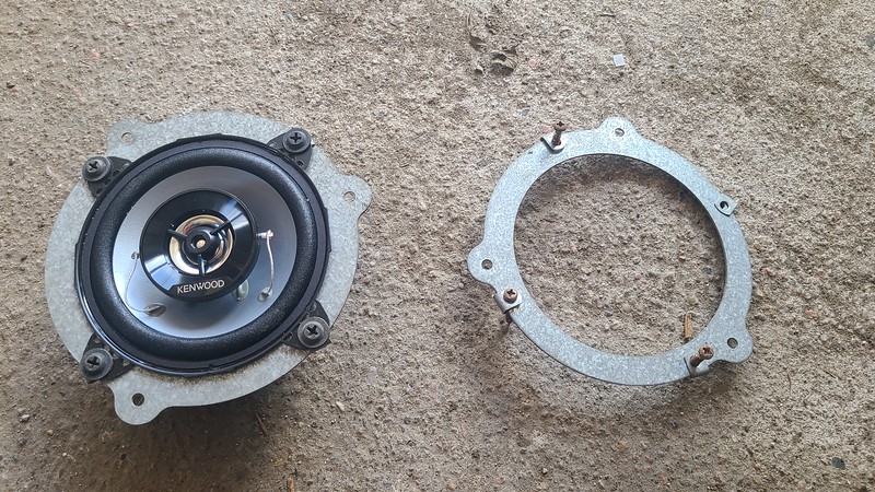

So I snagged a cheap set of Kenwoods from Amazon.
'85 Ranger Restomod
I snagged some adaptor rings at the JY a few years ago, they adapt the speakers to the goofy 3 hole bolt pattern Ford used to mount the original speakers

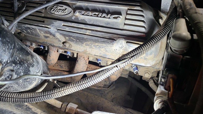

I also checked my header bolts, figured while I was there and I was looking at them I might as well throw plugs in it as well. They all looked pretty good, I will run them thru the cleaner and stash them for spares.
