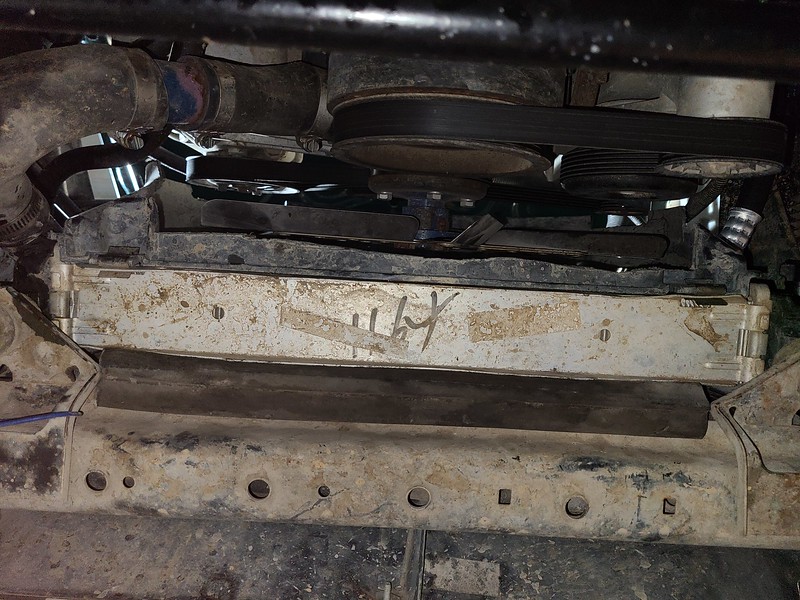

Hit the JY yesterday and snagged the lower seal off an Explorer (and a better looking/more supple upper one)
'85 Ranger Restomod
And HOLY COW.
I pulled the truck out out and just let it idle while I put stuff away. Efans kicked on with a vengeance, ran a couple minutes and kicked off. Dropped it from like 202* down to 190*. I let it keep going and letting it kick and off. The third time I timed it, it took 6 minutes at idle. With the hood down I can feel a lot of hot air coming out of the back of the hood. I was almost surprised the truck wasn't starting to crawl ahead from the thrust.
I never timed it with the 16" single but I am pretty sure these move more air/cool it faster than the single did even without blowing thru a condenser.
Anyone looking to increase cooling... I think those seals would help cram more air down the radiator at speed too. There was an '84 there at the JY too with factory A/C and it had nothing for seals.
I snagged the big cool looking funnel thing off a second gen for the radiator support but I would have to cut a lot of it off to get it behind my grille. Apparently a second gen has a lot more room between the grille and radiator support.

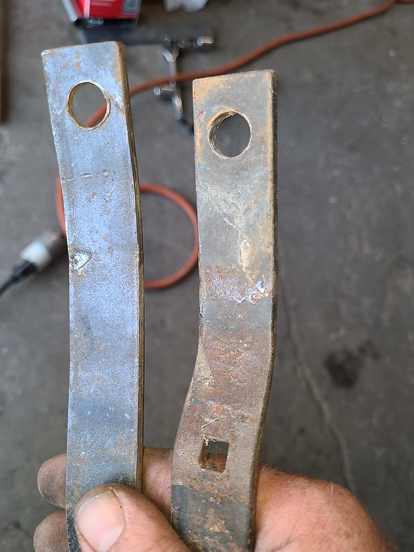

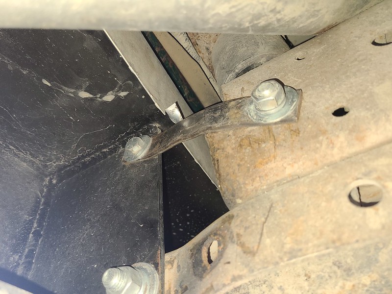

When I built my rear bumper last summer I made some quick and dirty braces for the top. I had hoped I wouldn't need them and got caught in the end when I really needed something.
'85 Ranger Restomod
They worked but they creaked like crazy whenever the truck hit a bump or as the gate was opening. Kept trying to tighten them before I realized the bend was working against the ends of the frame rails.
After a year of "working"
'85 Ranger Restomod

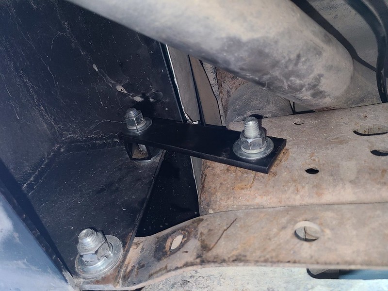

New and improved "design" has a chunk of square tube to eliminate having to have a dogleg in the straps.

That square tube should be oriented so the bolt goes thru the empty space. It's much stronger. The way you have it can fairly easily crush.
I thought of that after I had drilled the holes.
It could easily crush but the bolt in the tube is in sheer, that strap will likely bend before the tube would crush anyway.

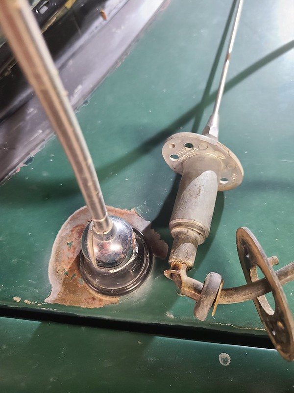

Radio reception pretty much sucked for the entire trip. I can see the cable on my current aftermarket antenna is chaffed where it goes thru the firewall. So I also snagged a nice stock one out of a sharp '84 (same truck I swiped my OHC out of a few weeks ago) Kinda starting to think my truck may have been radio delete? I don't have the three mounting holes to mount the antenna and my cable comes out of the cowl, under the HVAC box an in the firewall down low thru a hole that it looks like someone possibly made with a the dull end of a chisel. The factory one goes thru the firewall right below the passenger side front speaker (I learned that today)

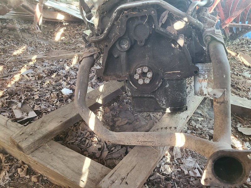

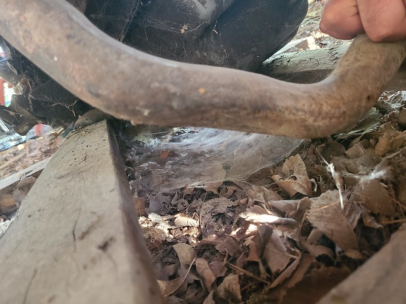

I was looking at my 2.8 in the corncrib (oil filter adapter) and noticed it must have been kind of tight for running the stock 2.8 exhaust with the 4wd front driveshaft too.
'85 Ranger Restomod
Factory dimpled for extra clearance (which didn't have to deal with the telescoping boot)

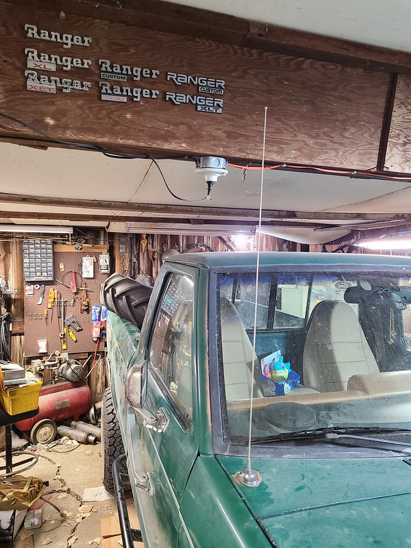

Well I actually had time to do something to the truck yeseterday!

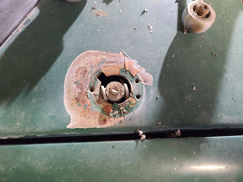

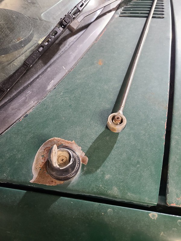

Like 15+ years ago I turned the antenna base sideways with the thought that I could lay it down flat when I did offroading. I never could manage to remember to do that and I have bent it on every trail ride.
'85 Ranger Restomod
Screw was stuck, so we drilled it out.

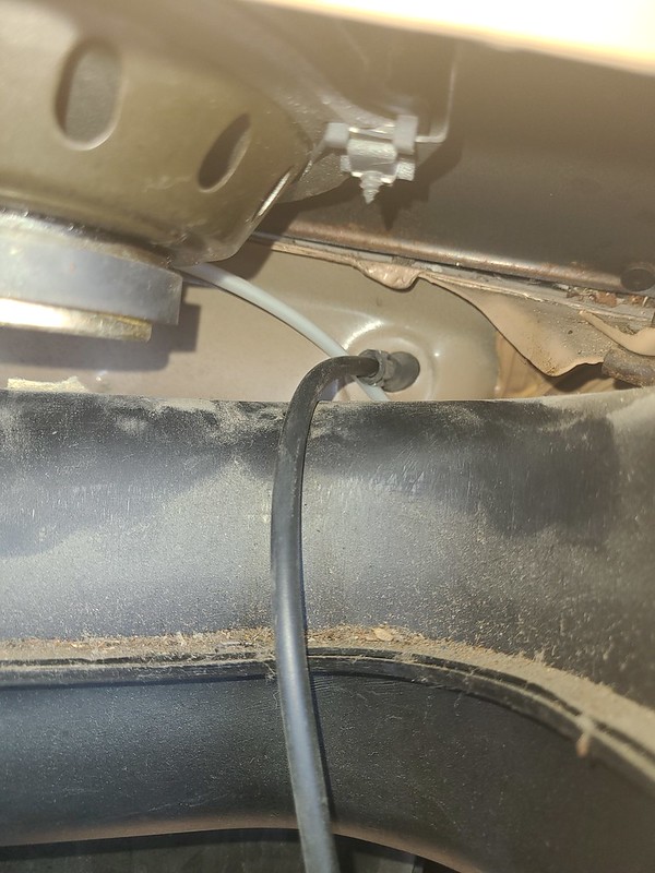

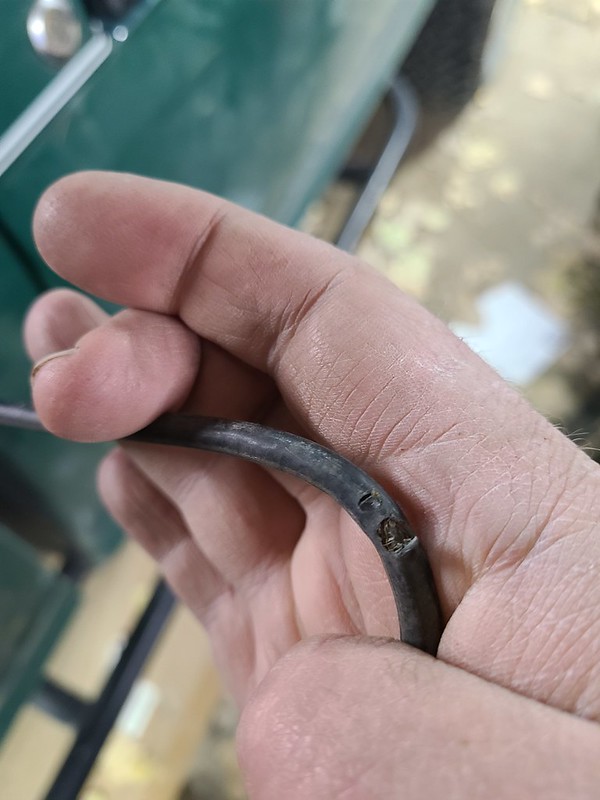

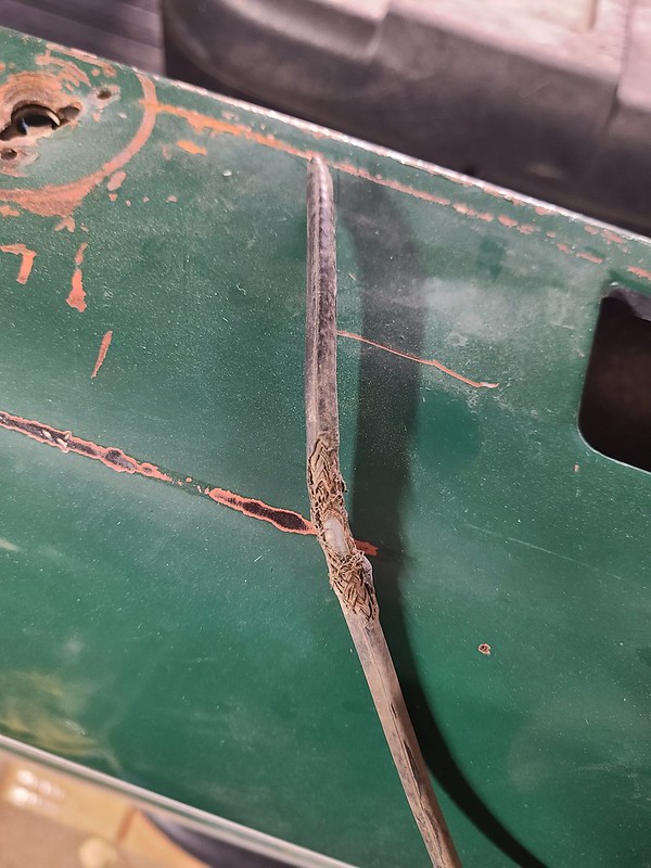

Cable did some chaffing where farmer bob had it passing thru the firewall back into the cab below the heater box.

Not sure where this was in the routing:
'85 Ranger Restomod
Fished the cable thru where it is supposed to go with a piece of light fence wire and it is now all as Ford intended.

I see the tractor tire hasn’t been unloaded. Is that your “winter traction weight”?
Nice collection of Ranger emblems!

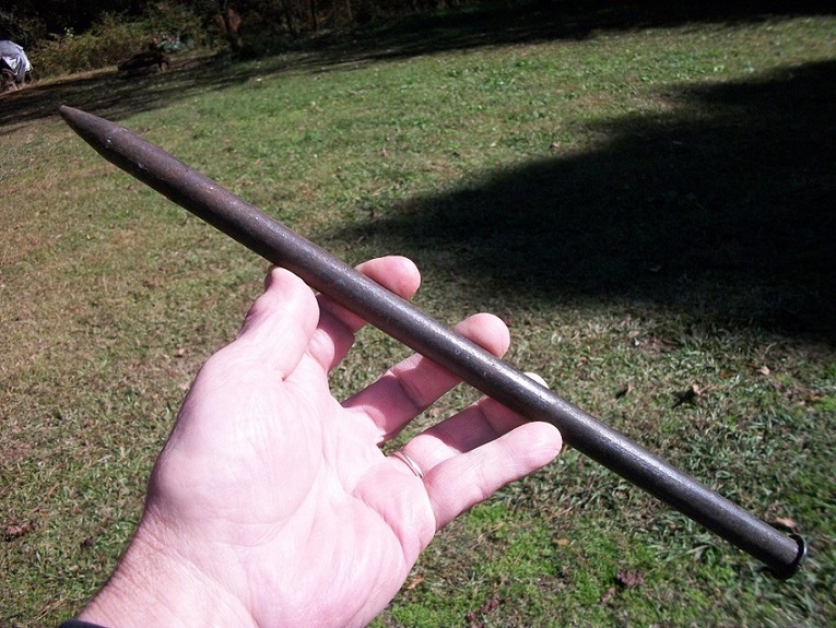

That's funny, and brings back memories from when I installed radios in these trucks when they were new. In general, in some cases the antenna coax could be routed through a factory grommet, but a lot of times we'd have to make our own hole. This was my homemade "hole poker", which I made from a tire iron:
68258
It actually worked good; it could be used between an open door and fender, if needed, and it nicely rolled the inside edge of the hole, which prevented chaffing the coax cable. And then a little black sticky butyl putty sealed it all up. This "tool" was used a lot; the mushroomed end is honest wear. I still use this damn thing; it's handy for a lot of things.
I think that all of the early Rangers had cowl panels pre-punched for the antenna (I don't recall ever having to drill one on a Ranger). The radio delete trucks had a plastic plug stuck over it with double-sided tape.
It's a damn shame that aftermarket antenna's rockers always cracked the paint under the base, and let rust get started. Getting rid of the janky aftermarket antenna and putting on a good stocker is a definite improvement.
