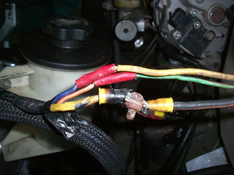

Started checking out the alternator situation, the two alternators have the same connector but the current Ranger alt has two going in where the Explorer has one. Apparently the Ranger was originally a single cable as well and somebody spliced it so both cables were live.
They also extended the heck out of it, used a much smaller wire and questionable connections... I am really glad I decided to switch alternators.

They have the same connectors between the alternators, one wire is off though.
How the Ranger was set up:

Just curious about the bolted eyelet crimps if there was a reason it was done that way. (?) Careful with those crimps and that little bit of wire that's exposed. I love soldering and shrink wrapping, takes a long time, but end up with a good reliable splice.
I don't know if it was a bandaid repair on old injury or what the deal was. It seems for whatever reason the wiring must have been about 2' too short, in the third pic of my last post and you can see the other end of the stretch (the wiring is wrapped around the power steering reservoir) The wire colors do not line up at all, and they used something close to a 12ga wire for the primary battery feed instead of an 8 gauge... the whole thing is full of stupid.
I haven't got to cutting the tape to see how they converted one primary to to two primaries for the later alternator, it must have happened farther down the line because it is still one at the bolted connection. This truck has to have a very storied history, a lot of stuff like this doesn't line up... all I can do is try to put it back to right as I find it and hope it doesn't burn up in the mean time.
I cut it all out before the first splice, I just picked up new supplies to start over with crimped and soldered connections.

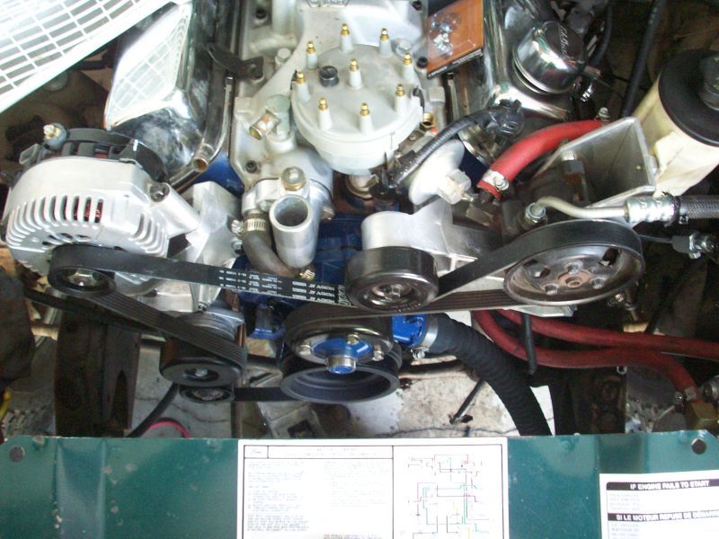

I did zip that little nub off the power steering bracket, the advance clears it fine now and I have quite a bit of adjustment that way. The PS pump is hooked up, I got a newer lower radiator hose (the original one was fused to the WP) I think the heater hose will clear the alternator bracket ok with a little tweaking. The entire FEAD is bolted on and pretty much waiting for me to put the lower radiator hose on so I can stick the belt on it.

Going from this (only running the outer belt)
'85 Ranger Restomod
To this:
'85 Ranger Restomod

That's a nice looking power steering pump. What did it come from? I had major issues getting mine to fit, and I'm still not happy with it.
The one in the lower pic was off of a 96-01 Explorer. I don't know what all is entailed to put it on a different FEAD but so far without running it the pump itself hooked up pretty easily. I had to adjust the '92 4.0 Ranger pressure line a little with a bench vice and after that it actually hooked up easier than the CV/Ranger pump did.
The lack of that nub, I could take off more (I probably should have) behind the idler. We will see how it goes I guess.

I did some trimming on the 91-94 Explorer fan shroud so it would clear the idler pulley, tensioner pulley and the fan.
'85 Ranger Restomod
'85 Ranger Restomod
The belt fits :yahoo:
'85 Ranger Restomod
The fan clears
'85 Ranger Restomod
Looks pretty official all buttoned up.
'85 Ranger Restomod

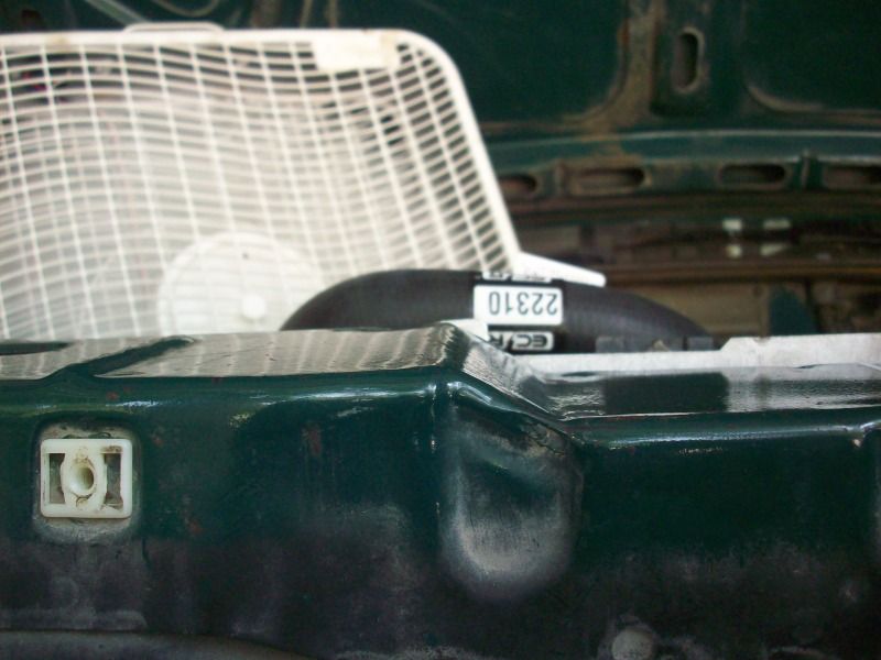

I tried the Explorer hose again... just not really happy with how it fits.
'85 Ranger Restomod
'85 Ranger Restomod
'85 Ranger Restomod
That hose is going to give you a run for your money, isn't it? You're going to have to get creative with some pipe.
