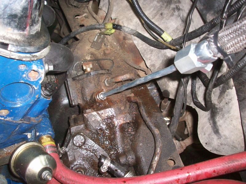

Headers are on, exhaust is hooked up dipstick is in (had to take the DS back off to put it in :blush)... now I gotta pick on the FEAD. Plumbing the power steering and hooking up the alternator.
PS pump is on, the pressure line (for a '92 Ranger) fit fine once I straightened out the curly cue end. The plugs are in, the steering shaft is back in. The alt. bracket is on and the alt is sitting on top as I try to find bolts for it.
The line does not come with the seal that goes on the end of the line, you must order that seperatly so if anybody else goes down this road keep that in mind.

I ran the line on the front side of the res so I would still have a hope of getting the enigne dipstick out, somehow I didn't catch a pic of it. The Explorers ran them behind the res. It is still a bummer getting the dipstick out though, that disappoints me.

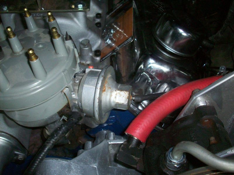

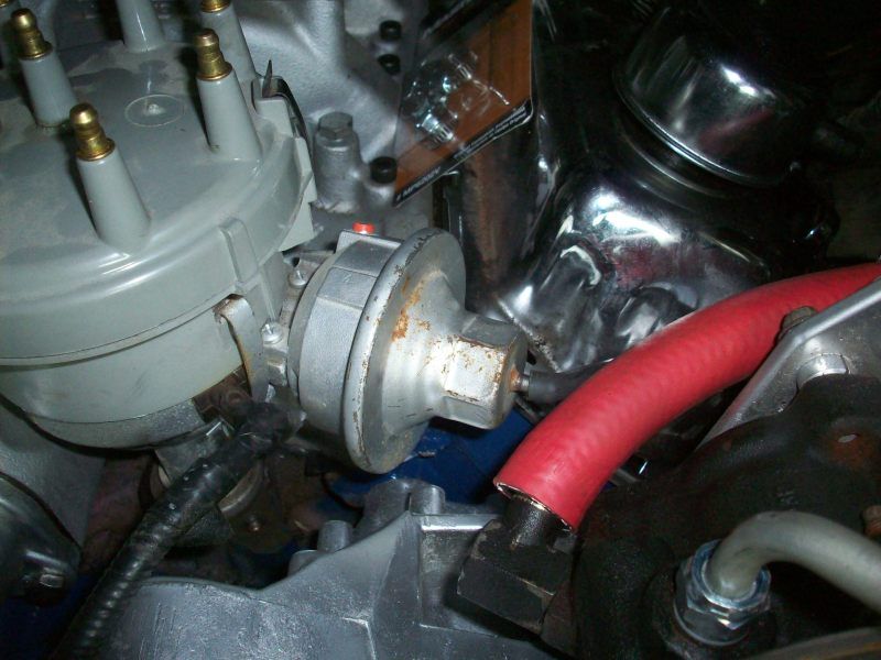

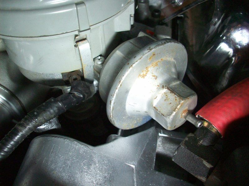

Of course a couple snags have cropped up, mainly with the dizzy. With the res. line on it really limits its adjustment.
Here it is really close to TDC1.

I could zip a little nubbin off and really open it up, I am not sure where it would put me for timing though. I will probably do it so I don't have to try to cut it out in the truck later.

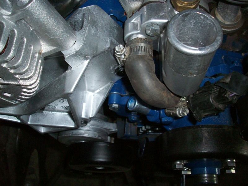

Yet another irritation, the heater hose outlet points right at the alternator bracket... looks like I will have to dig the pipes out of a truck in the JY and get the goofy looking hose to take it up to it. I might see if I can dig up my CV pipe and see if I can cut it back so I can get a hose going towards the heater core rather than into the firewall, it would be a lot easier than dismantling an EFI truck for a couple of pipes.
