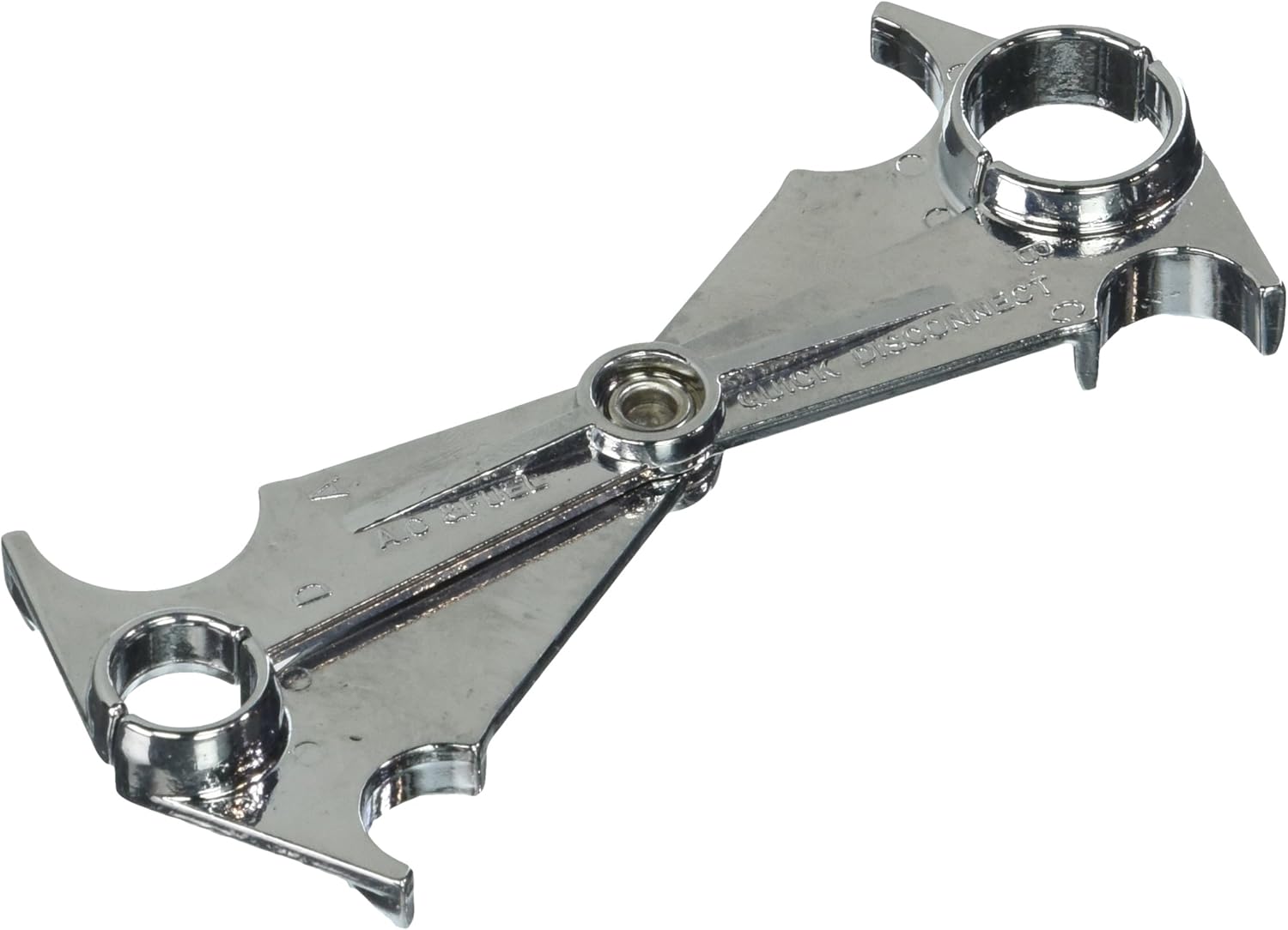

So this might be a stupid question, but how do you get the lines apart from the drier condensor etc where there isn't a nut? Is it a quick connect line a fuel line where you need a tool?
"Spring Lock" connections. It does take a special tool, which is not expensive.
I will prepare you. They can be a real pain to get apart sometimes, even with the tool.
I'll look into the tool. Figure I'll take my system apart soon and order parts.
I actually might have some aluminum disconnect tools somewhere. I used them on fuel lines before.
That tool that franklin posted is what I use...and a couple other similar styles. That reminds me, I had a hell of a time with one of the new lines on my last AC job... one quick connect had a weird spring that wouldn't quite clip on. It felt like it clicked when I pushed it together and held vacuum but blew off when I started charging the system. Keep a very close eye on the springs, make damn sure it's clipped in place!
