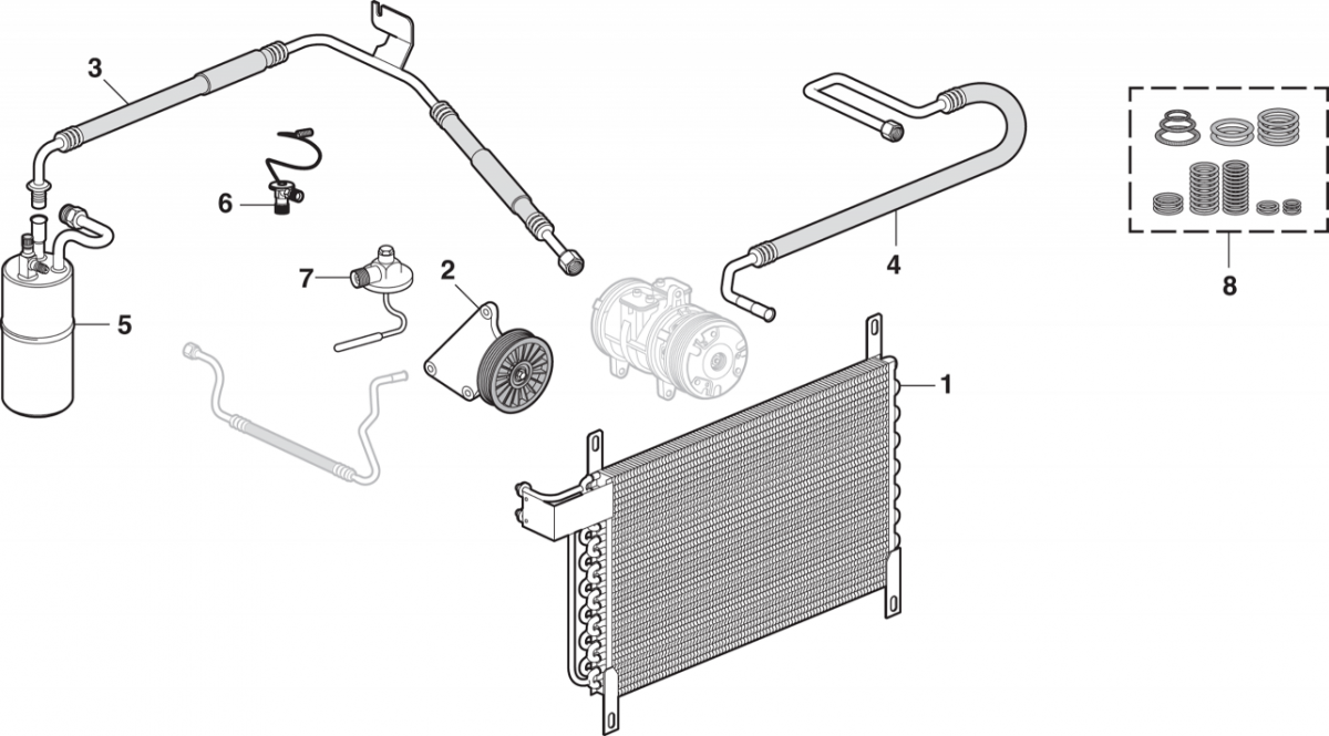

Are there 2 or 3 hoses total?
When I look on Rock Auto, I only see 2.
The LMC truck catalog has a picture. Rock may not have all the hoses.
The hose that's grayed out is metal on the 86 Ranger I'm working on right now, if it's not rusty just flush it and reinstall.
44106
I forget about LMC, they don't always the best prices, but they have hard to find items alot.
If the cheapest source doesn't have one their price doesn't matter.
The "greyed-out" hose, from the condenser to the accumulator, usually has a short rubber section in the middle.
