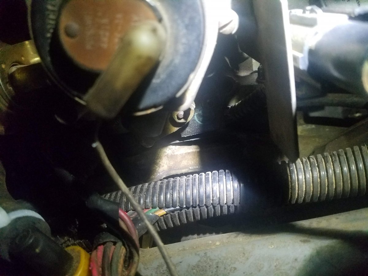

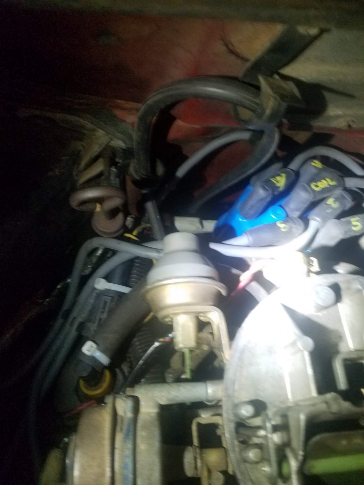

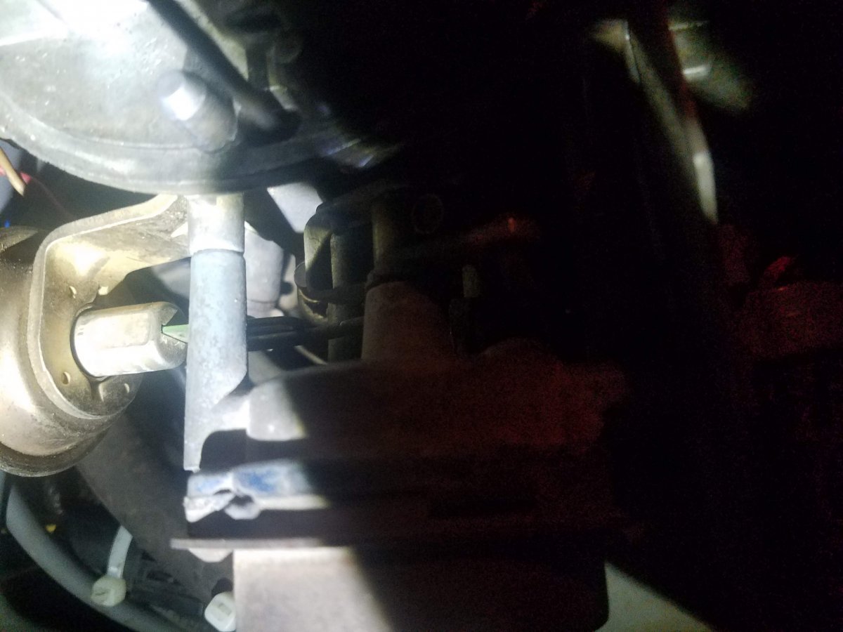

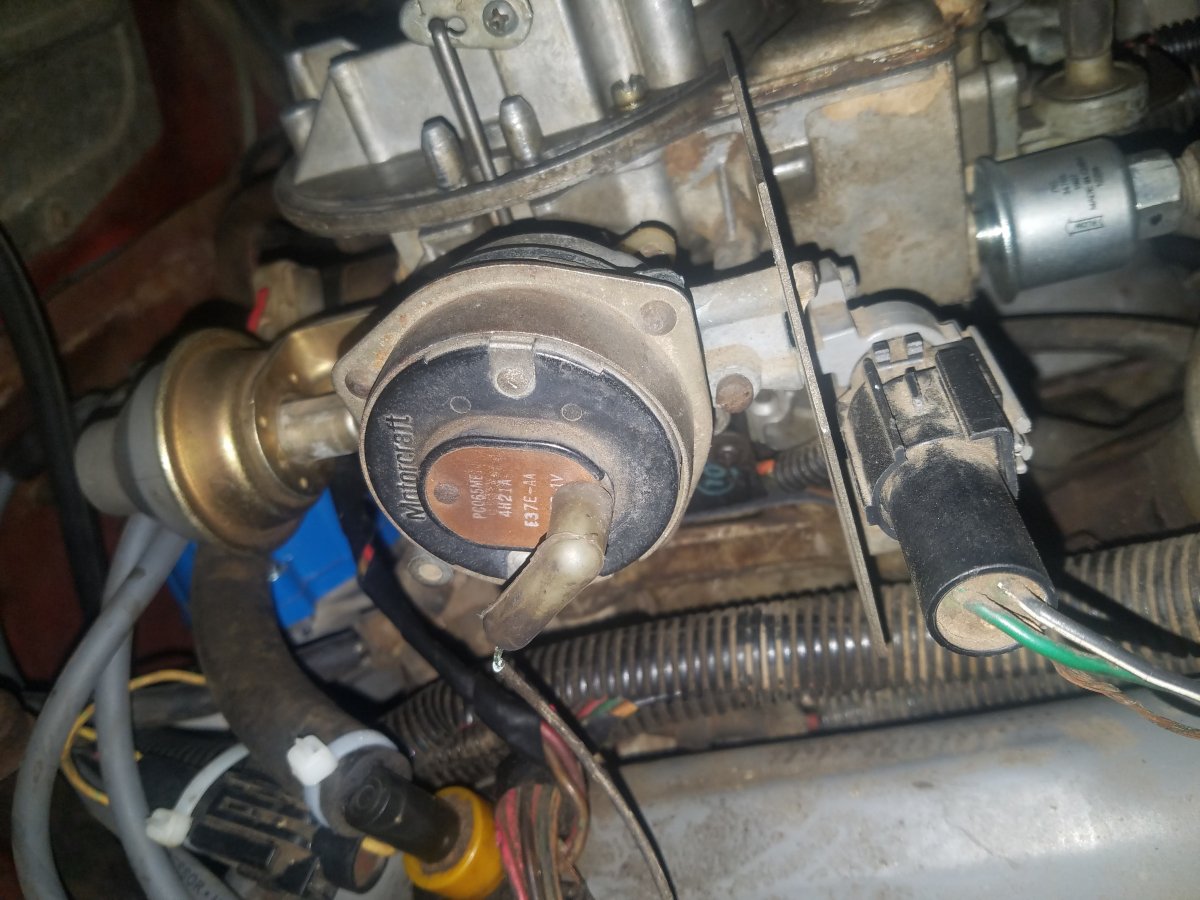

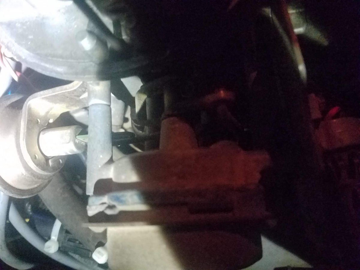

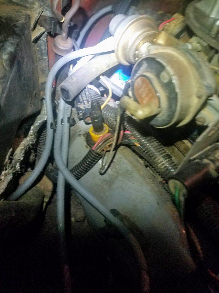

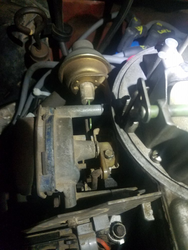

After looking at choke setups online today for the 2150a, mine seems all sorts of screwed up. Looks like the electric choke coil is way off to me, and I'm not even sure the linkage is hooked up right. The choke plate sits open a little, but I'm not sure it ever moves like intended while running. I understand that the choke plate should be fully closed when cold, the the vacuum pull off will open it a little when started and engine running while the electric choke coil opens up when heated upto finally have the choke plate at fully open while warm.
I don't think mine is doing anything. Any tips on where to start? Oh, I also read that you can use a dremel to make slots on the choke screws so you can remove it. Was this model never intended to be replaced?
Also, anyone have any tips to confirm the solenoid on the back of the carb and the tps are functioning properly?

I haven't actually tried this...if the engine is cold maybe a heat gun or hairdryer on the choke housing for awhile and see if the choke plate opens.
A Solinoid will be either open or close with the application of 12V. So disconnect the wires and apply 12V and see if it moves.
