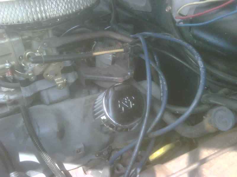

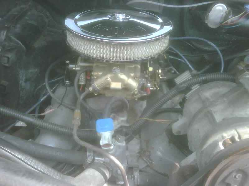

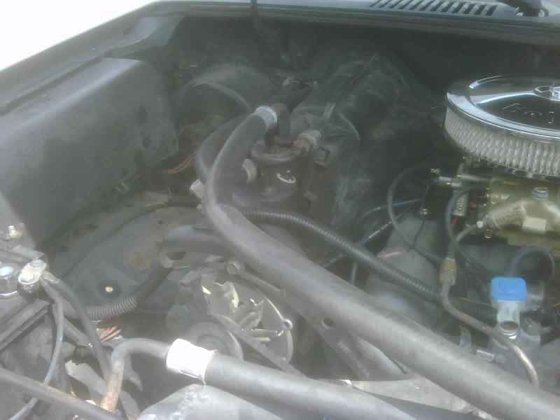

in the pics that shows the t-stat housing,i have not seen one like it on a b2...i thought the t-stats were down on the lower hose?
I put one on my 2.8 duraspark they work great you either need the manifold or like I did I plugged the nipple for the bypass hose on the intake manifold the housing has the1" bypass and with a 195 degree tstat the guage never goes past half

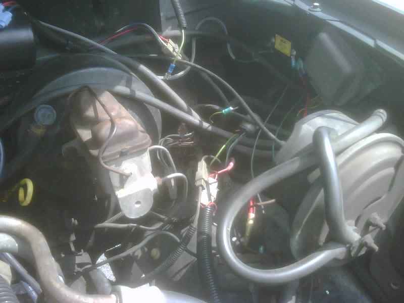

all you need is the temp and oil pressure and choke solenoid and yes you will use the harness for the swap. I pulled the harness out of the firewall and pulled it back to the alternator then you trace the wires for the temp alternator and oil pressure and strip the harness to keep them intact also the wires for the choke and whatever you want o keep connected I believe i only had to cut two or three wires to remove the harness leaving the rest hooked up. you will need to get rid of the mess anyway for the swap It is amazing how many wires and vacuum lines in there you are not using. All you need is the advance and possibly the air pump and vapor cannister to keep the fumes out from under the hood. Just strip the harness form the connector by the coil and ignition module back to the alternato and it will be clear whicgh wires to cut and what to save and use some of the loop shield to protect the wires you save.
Sorry not clear you will need the harness from the TBI swap for the computer and sensors.
WOW!! I must say that is some bird's nest under that hood. Kim is right about what you need. Fortunately you don't have the A4LD like I do so you don't have to worry abot any trans wires. I'll try and get pics from mine on. In one of your pics there is a long rectangular box mounted next to a silver square box on the driver's side fender, that is probaly your 'duraspark' box. Basically it is a resistor. I used a GM 4pin HEI module instead of a duraspark box. If you want I can do pics and tell you exactly what wires I cut. I'll list them by color. All my factory plastic vacuum lines are gone also. The only thing really left under that black cover on the passenger side is the starter solenoid. I haven't done the T-stat change that Kim tells of. He told me about it but I haven't gotten around to changing it...just happy mine runs right and isn't leaking at the moment!! lmao! Kim was a huge help when I did mine, Thank you very much Kim...
my t-stat is up top.in the pics i have the neck off and a t-stat was in that hole thats visable.that "box" next to the silver one is like ceramic with two wires connected to it and they run to the coil.and yes any pics anybody can show me on what wires to say bye bye too will be great.
yes kim looks like he is the bronco II god...very knowledgable on these wicked little things. and thank you all for your feed back.i'll will be having much more questions...be warned..lol.
