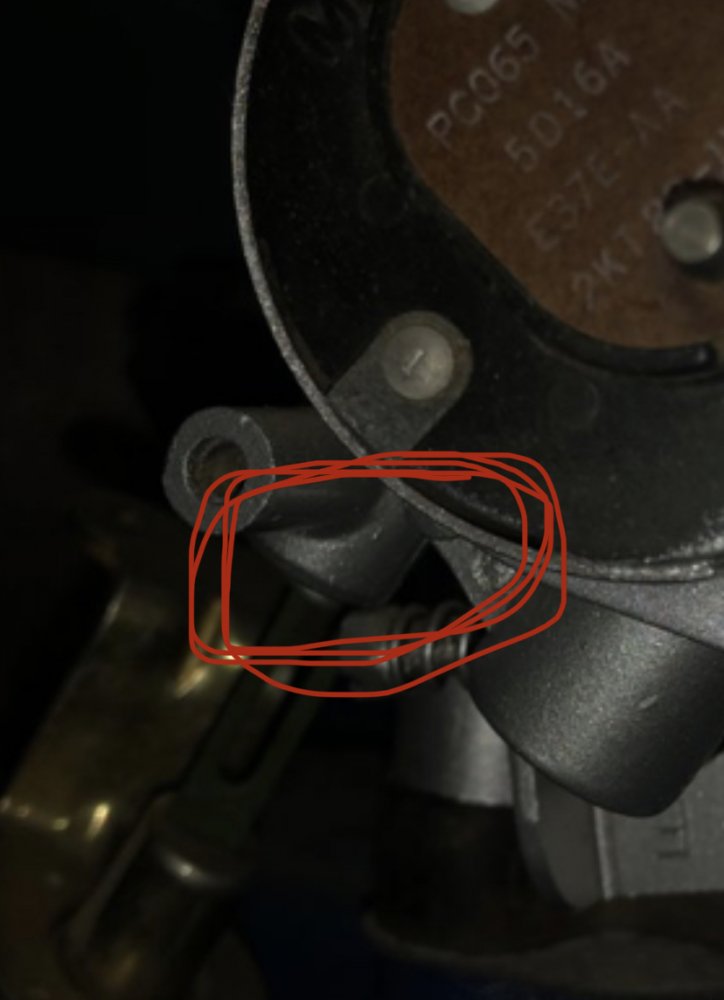

The issue with the carb, is that I noticed the choke was not opening all the way. Upon further investigation, I found that the hose that vents heat from the engine into the carb to open then bimetal spring is not there. If anyone has a diagram of how a new one would be routed to fix this it would be terrific.

I thought there was a heater hose that went in the port to the left of the bimetal spring location? If not, which part do I check? There was a small wire with a plug going into where the spring is, but I thought that monitored the temp not controlled it
No, it the wire makes the choke work. Looking at my old carb (on a 289 I turned into a lamp in my living room) I dont think anything goes on that post behind the choke, if you look at the other nipples on the carb it is not shaped the same (and alarmist looked like it tapers smaller)

Yes, I was looking at this part right here. I saw one diagram where a hose ran down from this port.

Nope, that's an electric choke. They used the same old casting from when hot air from the exhaust manifold was drawn into the housing. Ford always used to feed the choke stator voltage from the alternator, about 7 volts.

Okay, that clears it up a lot then, thank you. So the small wire I saw the leads to the bimetal spring should run down to the alternator and I just need to make sure it’s getting the voltage?
If you look at the back of the alternator the terminals should be marked "S", "F", and "A". S is for stator. Once you confirm the wire is attached and in good shape, I'd test the charging system output before doing anything more serious.

So I checked the connector, and something was a bit odd. I got pulses of voltage to the boot not a steady voltage. I then Ran a wire straight from battery to it to see if it would open, and the choke still never opened fully.
The electric choke was usually powered by alternator so choke spring would only Warm UP when engine was actually running
If it was powered by Key ON voltage then driver may turn on the key and NOT start the engine right away, for ??? reason
Then when he did start engine choke would be open too far and wouldn't run well until engine actually warmed up
There was never a good "automatic" choke setup on a carburetor, you would ALWAYS need to adjust them for winter and then summer temps.
