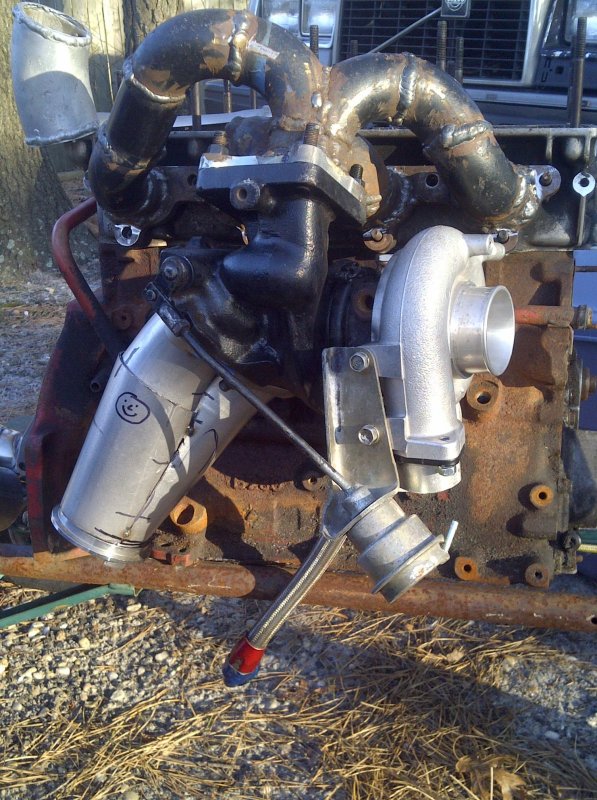

Turbo bricks forum ftw....
Not sure how those are going to help. TurboBricks is a Volvo forum. Yes, with a lot of machine work a Volvo DOHC head can be mated to the Ford 2.3L block, but that's more than I'm interested in doing and IMO is not worth the effort to reach my goals for the truck. If that was simply providing examples of making it work, thanks, but if I were going to put that much effort into building the modifications shown, I might as well build a header. As I think mentioned previously, I'm not interested in getting into fabricating my own header.
That first picture is interesting if I ignore the home brew turbo relocation. The engine side flange looks a lot like the 2.3L's exhaust flange. It looks like the the turbo would be positioned lower and further aft than where the Ford turbo header puts it. Likewise if it were flipped it would place it higher and further forward. Makes me wonder just how similar the flanges are and what the turbo mounting flange looks like. Unfortunately, there are no junkyards around here where I can go to compare parts.
