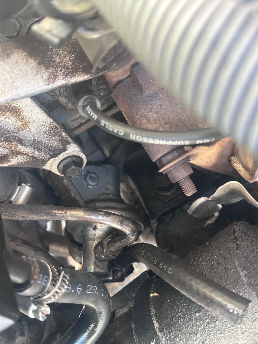

Can you show me the stock mechanical pump on the side of the engine?
With key on i can hear a electric pump kick on, im certain its not mechanical. I wonder if my fuel system was already messed with previously.

2.8's originally had a mechanical pump towards the front of the drivers side of the engine. It is buried in there and will be hard to see. Follow the fuel lines, where the one that comes up from the rear of the engine on the DS frame rail meets the one that comes down from the carb... that is your fuel pump.
They just had a pickup assembly with the fuel level sender assembly made onto it.

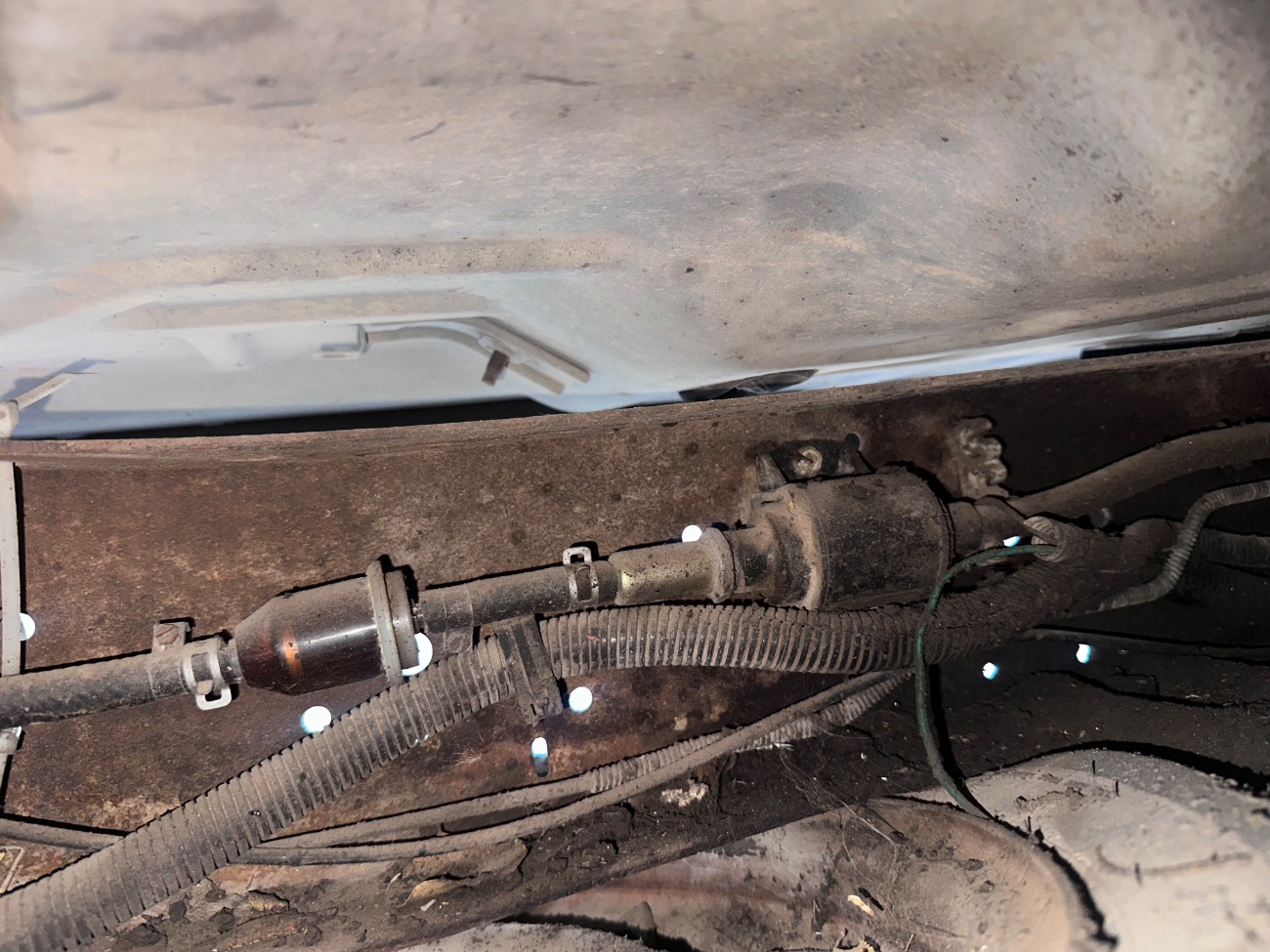

Yeah its definitely been messed with, its just a softline from the carb that goes down to the frame rail to the hardlines. Ill send some photos when i get home

Thinking about it, my truck is a 85, since i already need to replace tank and sending unit, can i just run the inline pump? Then fabricate the return port back to the tank. Everything is going to be done myself.
Taking off bed bolts went great, god i love working on this truck.
Fuel system is fuel sending unit > first filter > fuel pump> 2nd filter > carb.
2nd photo i think is the mechanical pump, its never been hooked up since ive owned this. Please confirm for me.
So basically ill get a 85-88 fuel tank, new sending unit, wire as normal then replace filters and utilize inline pump. Will add a return fitting on the tank for the EFI

It also looks like my inline pump has its own ground wire, its getting 12v from ignition coil + , and from ignition coil negative theres the green wire thats just dangling next to the pump….
