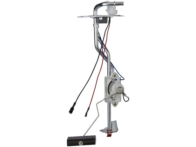

However, you should be able to just use a piece of hose in place of the in-tank pump on the sender assembly as long as you have a good frame-mounted pump.
In theory.
The sock clips onto the pump so you lose that unless you figured something else out there.
Actually when the first in tank pump died I ran a holley inline pump and it was content sucking fuel thru the non-working in tank pump lol.
At the end of the day the in tank pump pushing fuel out of the bottom of the tank does work the best.
