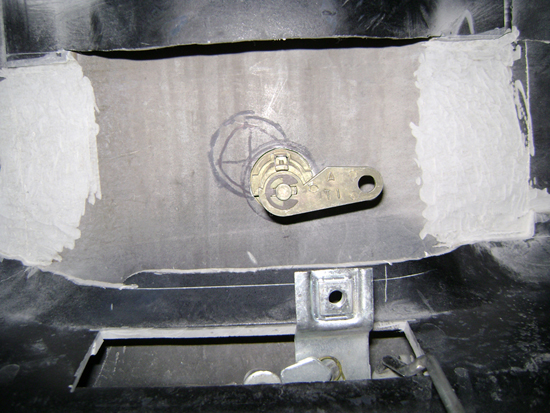

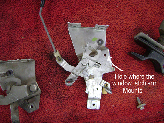

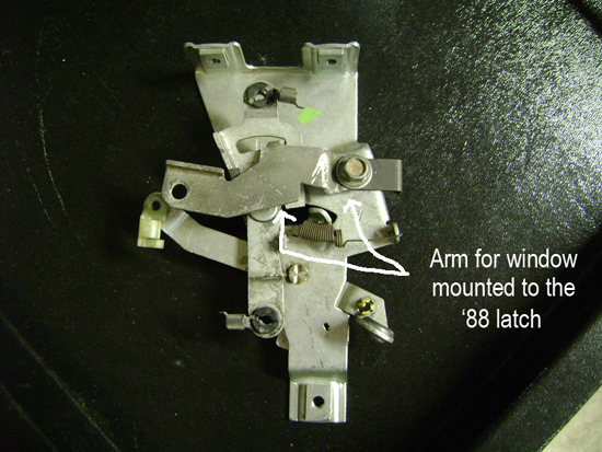

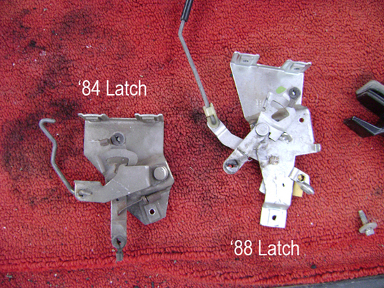

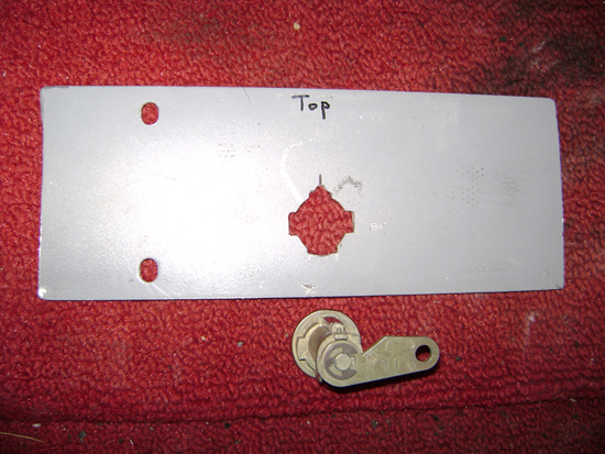

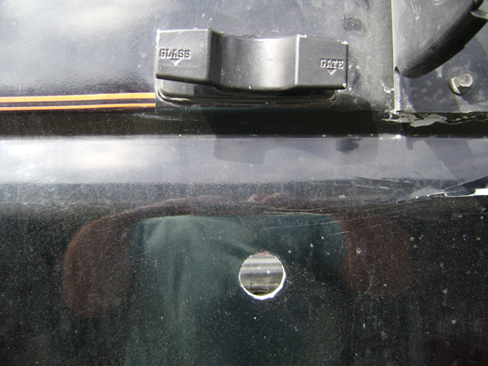

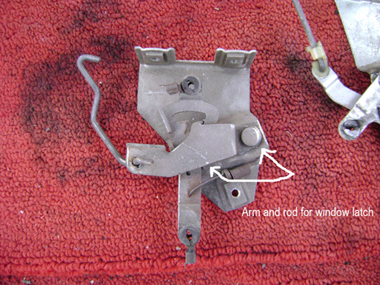

Fixed
Well I got it done. I got a lock set with keys at Autozone for under 12 bucks.
Made a hole for that in the gate like the 85+ year models. Found that the 88' latch assembly had a hole in it that matches the 84' hole for the rod that operates the window hatch. Mounted that with just a bit of enlargeing the hole. did some creative carving with the Dremel and mounted the 88' latch assembly. Drilled and fit the inside lock rod so it can be locked/unlocked from the inside. Created a metal plate, and dremeled the inside of the gate to recess it, behind the lock cylinder to keep it from rotating in it's mount.
With all of this done , it looks very near OEM. I am trying to post pics that I have but I need to resize then post. I'll have them up here soon.
Hawkeye :icon_thumby:
Pics of the Fix
I got it working! Here's some pics. :icon_cheers:

More pics of the fix.
Here's more. :icon_cheers:
