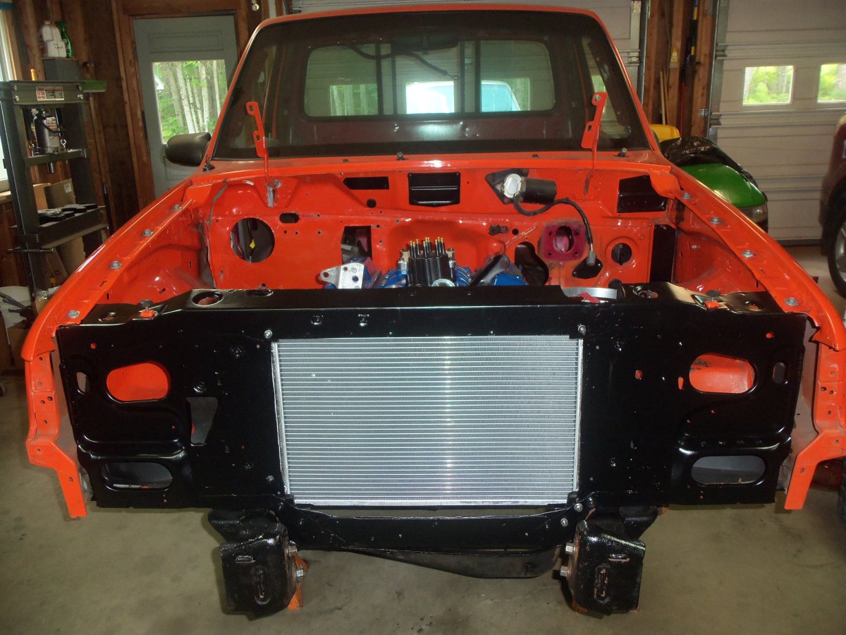

When I put the 95 351 in my Ranger I had to hollow out the core support and mount the radiator inside it because the fox body accesory drive didn't leave enough room to mount one on the face of the core support. I don't drive it in the winter so it has only an external cooler.
