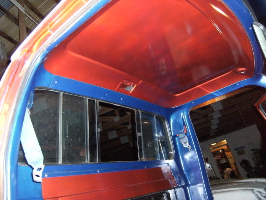

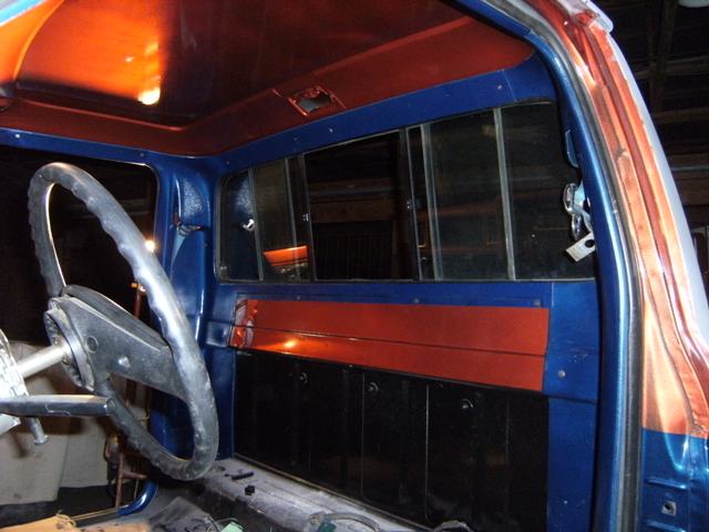

here are a couple more pics of what got accomplished tonight before the lights went out in the shop. this is the trim and the roof, there isn't going to be a roof liner, just metal.
  • 83 302 build
  • 83 302 build

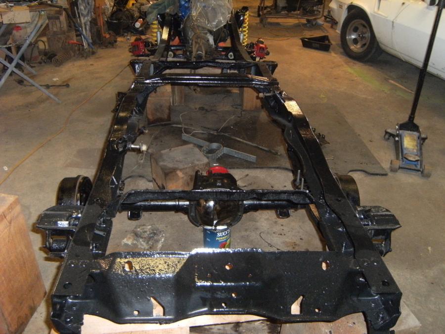

All cleaned and ready to be put back together. You can see the reinforced boxed section in this pic.
  • 83 302 build

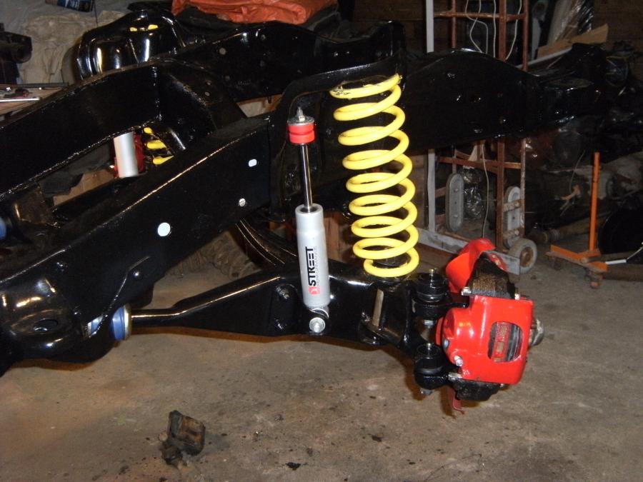

Was able to do some work on the front today. Hope to get all the tie rods in place tomorrow.
  • 83 302 build

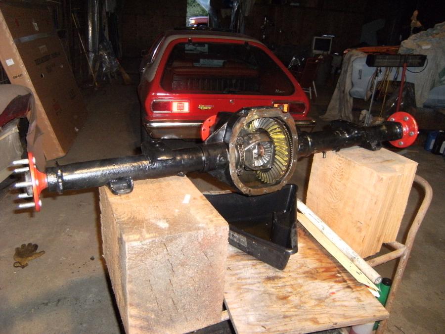

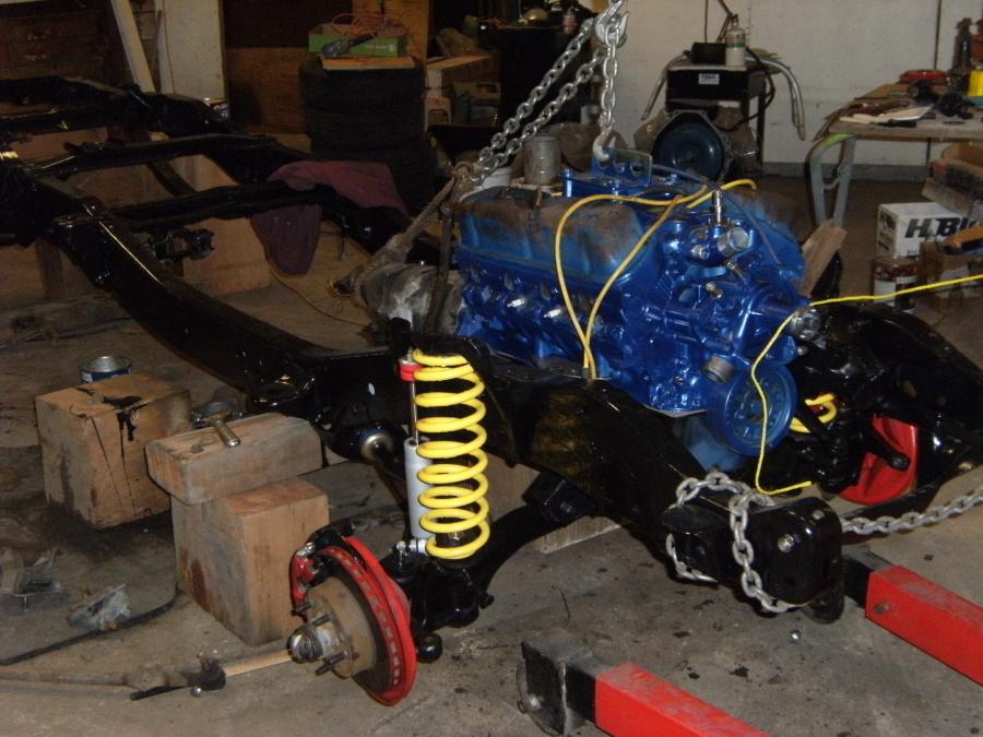

been trying to get out to the shop and work on the project. couple new pics of where it is at. test fitting the motor and figuring the motor mounts, plus the rear end will be bolted up this weekend.(hopefully) It has new seals. all new bearings plus a new set of spider gears. 3.08 and i was happy with this ratio when this rear was in my old 91, so i will keep this for now and see how it behaves. cheers

Rear is in, just looks like the drums are complete.... nope just sitting over the hubs. still need to buy all the new springs, pads and hardware to complete the back. not to mention getting a roll of brake line and cutting to fit with making all the fittings with the flaring tools. if anyone says building a truck is easy or cheap, i will say, NOT!!!!
