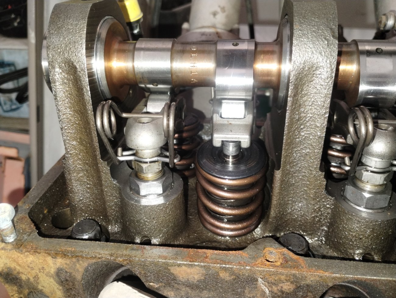

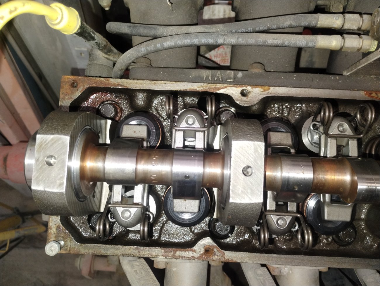

I just went out to my storage. There is a 2.3l that I got in trade for some work. It has been built for salt lakes racing, so not stock...
However, I think it would be based on stock type engine. There is no hydraulic lifters. There are no lifters at all. There is a place to adjust the ball end of the rockers to provide clearances needed at the valve tip. Does yours look similar to this? If so you need to back off the adjusters because as the engine heats the clearances close up. And if too close to start with the valves will end up not closing onto the seats when warmed up. This is what it sounds like is happening....
First pic, left side, under the spring is where the adjustment is made. To the right in between the valve stem and rocker is where the measurements for clearance would be taken with feeler gauges. Generally the intake would have less clearance than the exhaust.

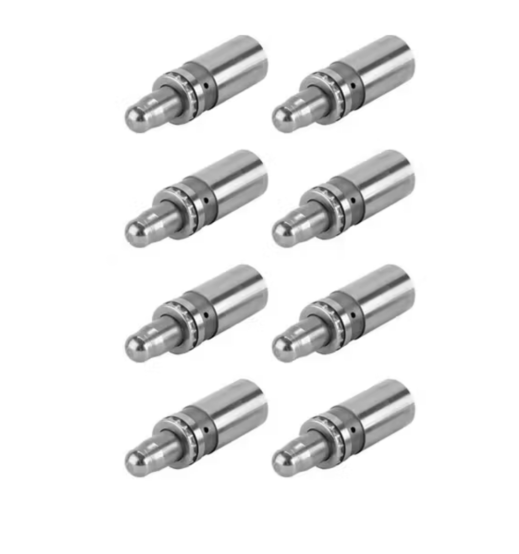

Mine is not like that. It doesn't have the spring keeper on the rocker adjuster. Mine has hydrolic lifters where your adjusters are. They look very similar to your adjusters, but they are hydraulic lifters.

I would suspect either the oil pressure is way above stock or somehow the return passages for oil out of the lifter bases are restricted. Are the lifters shimmed at the base? There are oil bleed holes at the base of the lash adjuster boss that should bleed excess oil when the engine is running.
View attachment 122693View attachment 122694
