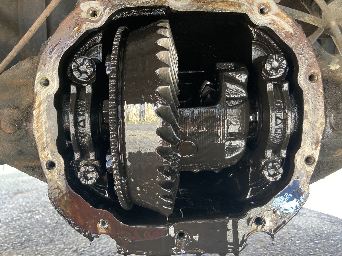

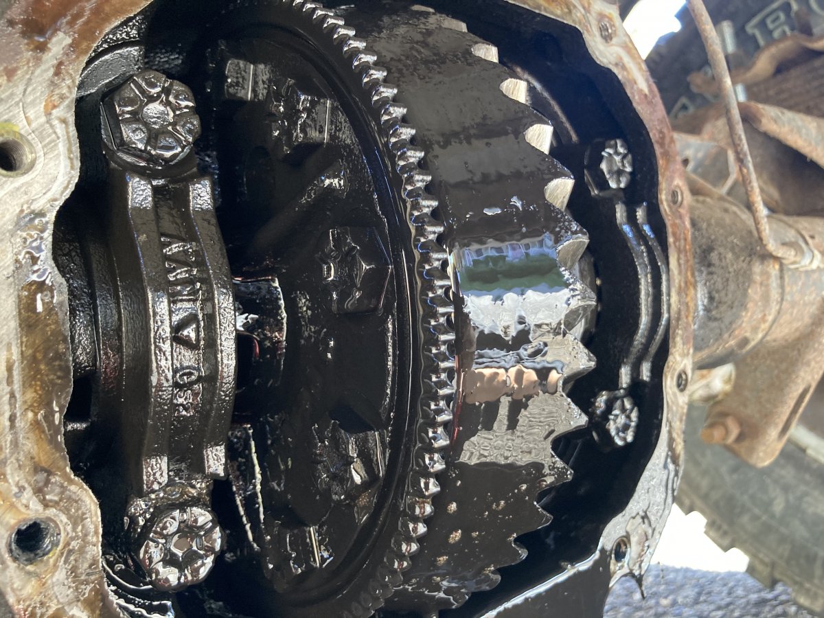

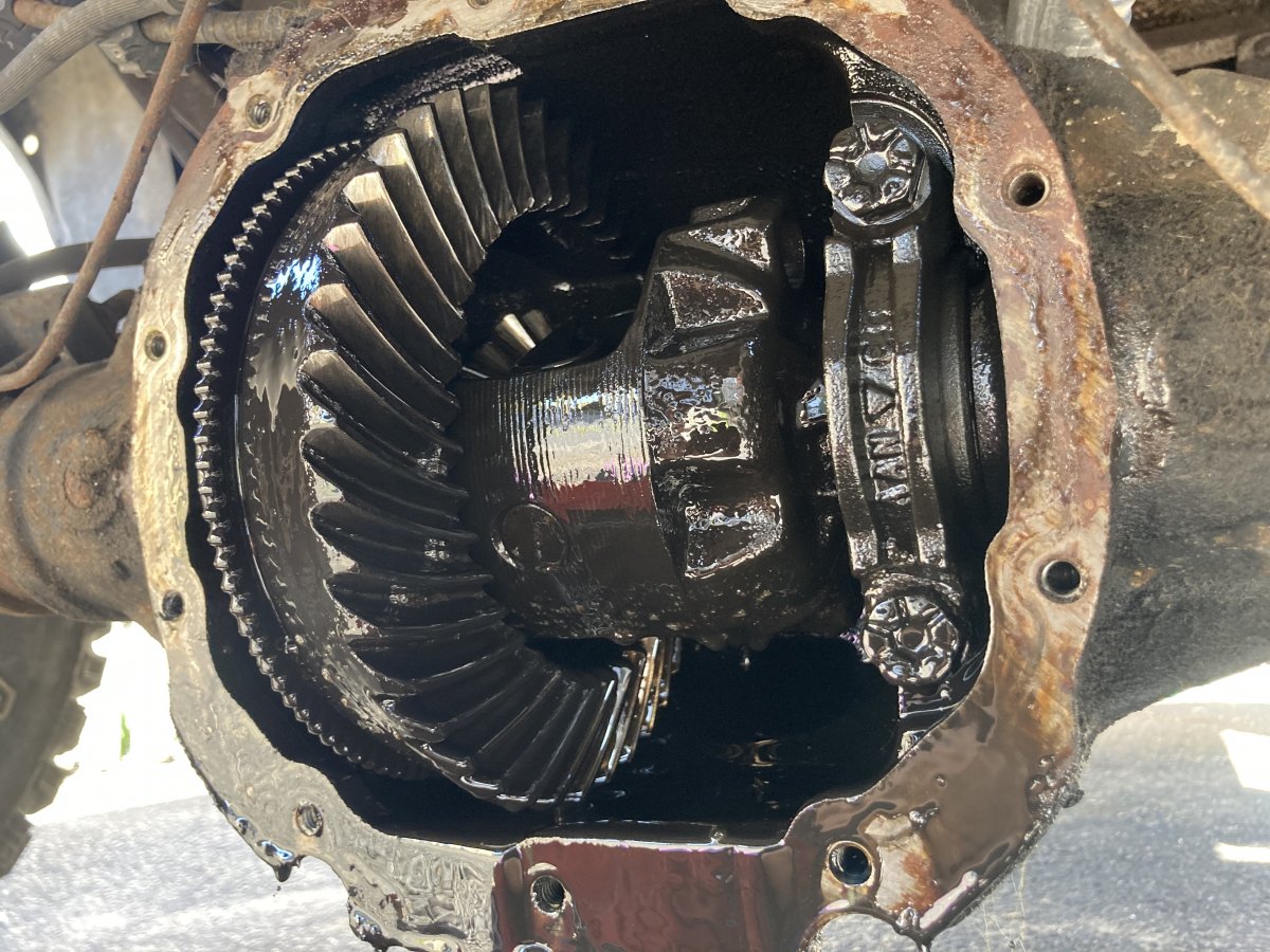

Rear differential pics. This is before cleaning off the surfaces
58166
58167
58168
Cool, you even have a limited slip!
Probably needs rebuilt but you can still say you have it. :icon_twisted:
I can smell the used gear oil from here...

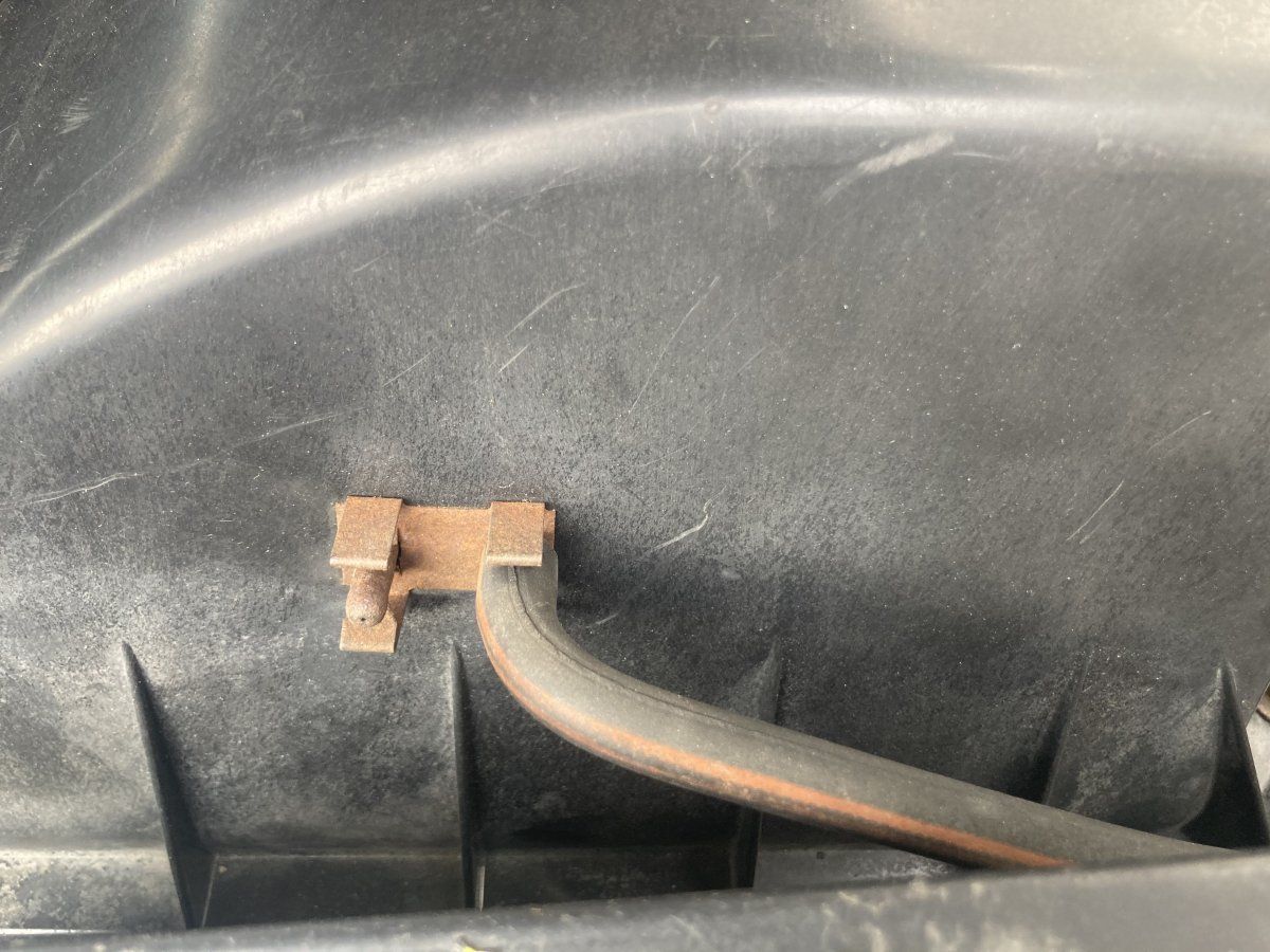

Then I took a look at my engine and right off the bat found something completely missing.. a second hose connected to the air filter..
58197
On the bottom side of the throttle body, pointing down, was a completely wide open small vacuum connection. I can’t believe I hadn’t seen it before because I had taken the throttle body off twice previously.
Using the video just linked, I was able to determine that the charcoal box was supposed to connect here. My charcoal box was connected instead to the top of the intake, at the same double juncture as the MAP/MAF sensor. This spot, naturally, was supposed to connect to the air filter box’s second vacuum hole which in my truck is open as well as just pictured. So I pulled this incorrect charcoal box line and connected it to the correct and available spot under throttle body. Then using some proper sized vacuum hose I made a connection from the top of instake over to air box.
Fingers crossed this has an impact. I dont know how it couldn’t since that spot under throttle was wide open and now it’s not.

Not sure about the hub thing.
Block a front wheel or two, put the trans in neutral, jack up a rear tire and see how hard it is to spin the wheel by hand. It should fight you.
Generally by 100k they are wore out. Looking at your gear oil it has awhile since anybody has looked at your rear diff.

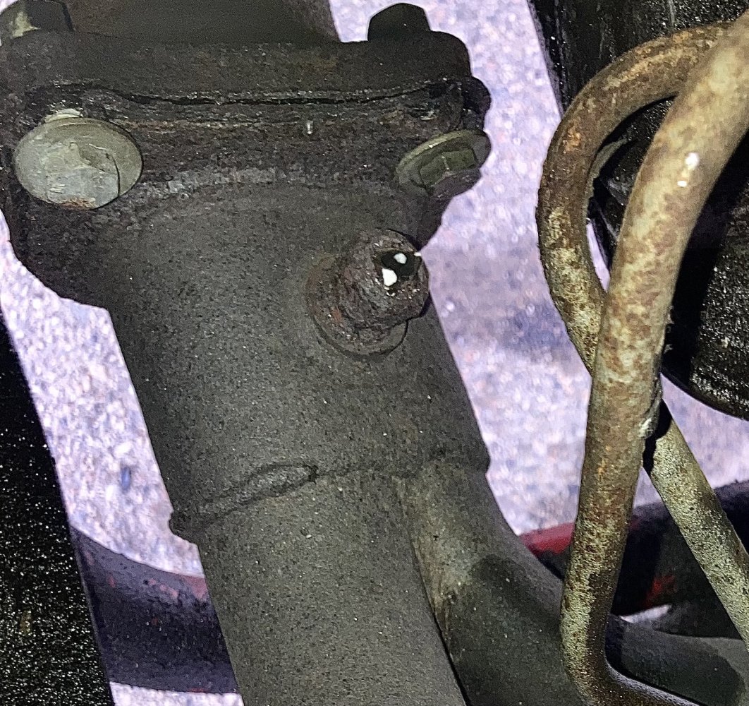

I finally found the location of the sensor today and put a socket down in to try and twist it out. I got it over top of it and just touching it made the sensor snap in half. The top just fell right off without any force. So i'm assuming that it was completely toast, literally. I consider this to be excellent news since that means there some explanation to some remaining symptoms.
The remaining part of the old sensor, if i'm interpreting correctly, is the hex base of it. It's about 21mm but maybe 20mm. It's not a standard O2 hex size. The 21mm wants to slip so i'm picking up a 20mm tomorrow to test. I'm pretty worried about this breaking apart when i try to turn it. I'd almost rather it not budge at all than break apart and leave a hole in the Y pipe.
I know if i left it in place that means committing to drilling and welding a new O2 bung right by it. Sounds like a nightmare because i'd probably have to take out the Y pipe to do this since it includes welding and access down there is horrible. And i know removing the flange bolts to manifolds to remove Y pipe will not be a nice time.
But i'm going to give the sensor a real shot with PB Blaster and the 20mm socket. If i can get it to twist, it'll be a big victory. There's just enough room for me to slip my arm in above the cad converters and have a modest size wrench in there. I might be able to hook up an extension bar and gain lot of leverage from the side of the truck.
I know that temperature also comes into play. If it were more accessible I'd torch it a good long while first.
The only way to truly gain access is to remove the cad's/exhaust and then there'd be space to get a torch in there and also much better leverage with tools.

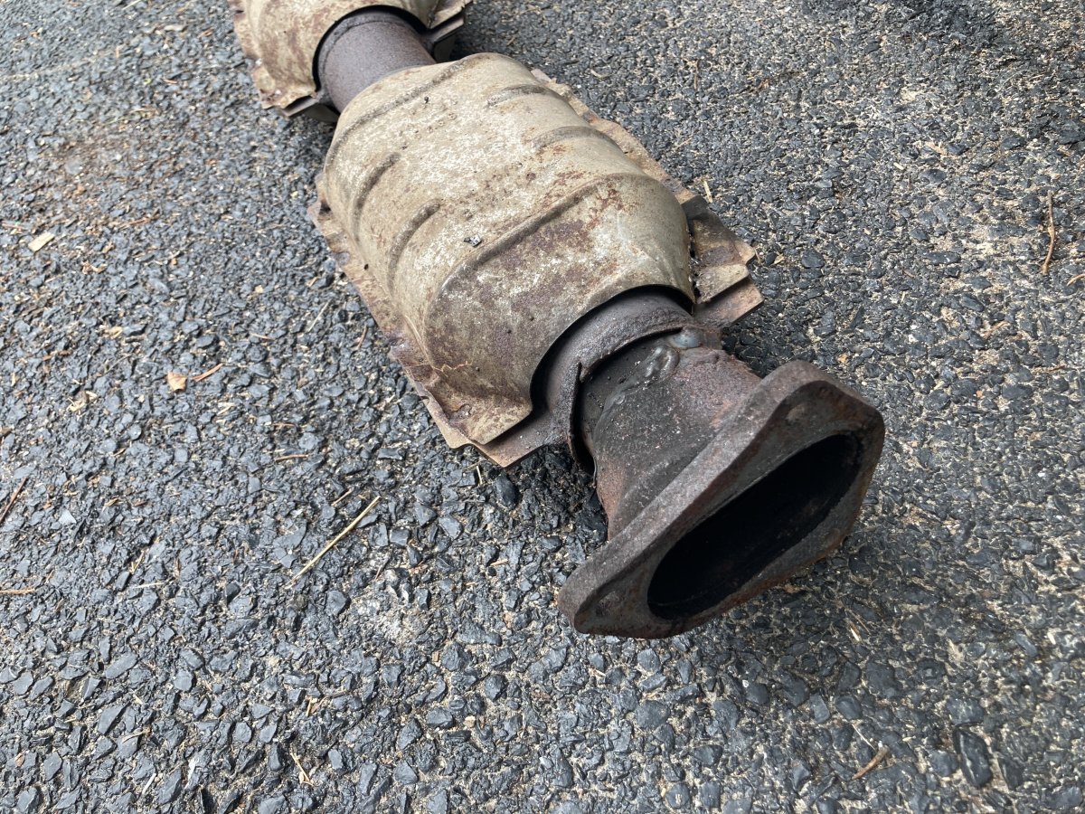

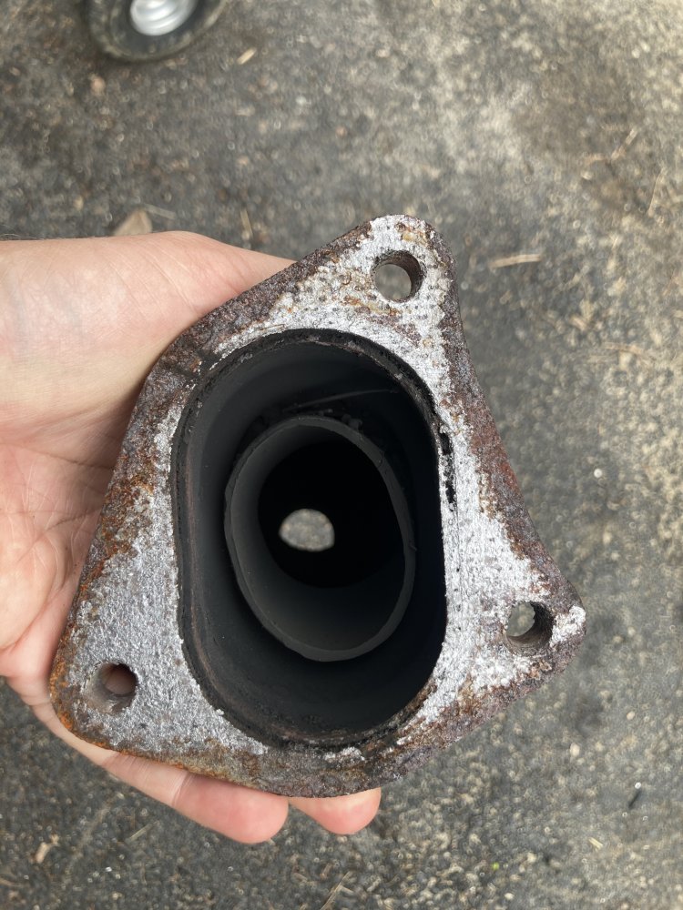

Got the cats out.
Well, I do not see how this is converting anything.
Is this just a dummy installed to fake out inspections?

I know in Pa that they are supposed to do a visual inspection of the emission equipment. So even if there is not check engine light/codes, they need to look and see if all the parts are still installed. So some people will hollow out the cats to pass the visual.
