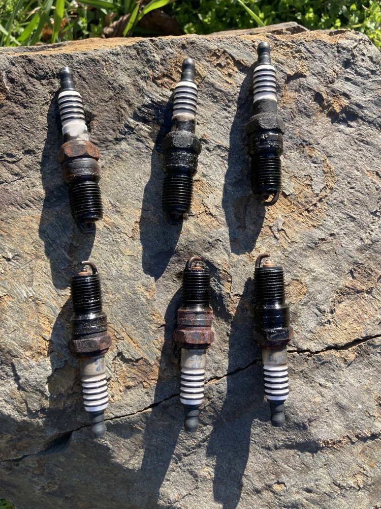

All six old spark plugs look the same.. they’re quite old looking, with a good bit of rust color on outsides. The plug tips are all dry brown. The threads are all a little oily. See attached pic. I’m almost positive the replacement with new ones (all measured for gap) made a nice improvement. I believe there has been less random stuttering / loping since the change.
So my priority is bringing down the idle during park and cleaning up the mixture and exhaust. In drive the idle drops down nicely. But I know in park it should be lower than it is.

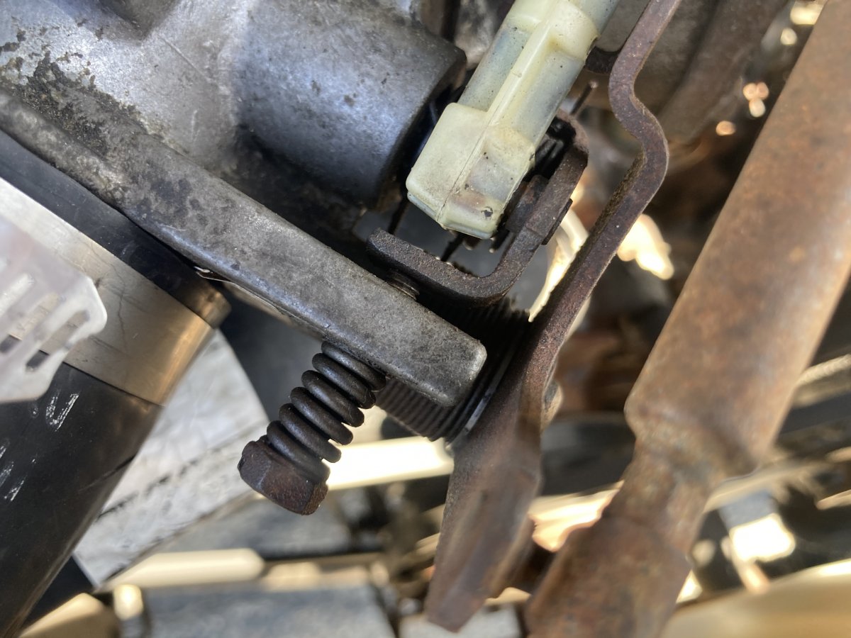

I’m curious.. I know there isn’t an idle adjustment on these and that everything is dictated by the circuit and sensors. But what about the throttle / linkage adjustment?
The way I see it, I wouldn’t be surprised if previous owner had been frustrated with an aging engine stalling and just one day decided to adjust the throttle so that it always was giving a little juice.
Below is a pic of the linkage screw position. Does this seem correct or is that gap there becuse the PO screwed it inwards some so that the linkage was always gunning a little bit?

Anybody have any thoughts about that screw?
Ok so i have backed off the screw by exactly two turns. Surprisingly, the mechanism doesn't fully come back down flush with the plate. There is now some air between the tip of the screw in the position and the plate that's "getting stopped". So it must be something else that's stopping it.
This had me thinking that maybe the TPS mechanism was stopping it, so i took off the TPS and checked.. it did not allow the plate to come down fully to where the screw was set.
All of this makes me think i have something backwards, and that IF there is a mal-adjustment of the screw that it may need to go further in instead of fully out. However that doesn't make sense to me at all regarding the actual throttle system.
But while i had the TPS off, i decided to fire up the truck and see where it idled. I knew that the TPS mechanism itself was fully "down" so maybe something would improve. It was hard to tell a difference but maybe there was some.
However.... i also decided to try turning the TPS sensor just a little bit. To my surprise, when i started turning it "UP" so to speak, the engine slowed down. Turn it up enough and the engine goes down quickly and wants to stall. So i quickly let it go.
So this has me thinking backwards.. what if the screw needs to be pushed in, and the sensor needs to read a little big higher voltage than it's getting right now in order to work with the computer's voltages.
So, working with that, I'd go right ahead and start adjusting the screw inwards and past where it was set before i started tickering, but i don't understand how this is going to slow down the engine since i'm literally giving it gas by adjusting the screw more inwards, right?
I'm going to reset the screw, and start turning it inwards past the former spot while the engine runs and see what happens..
I ended with backing the screw down one turn from where it was and leaving it there. It settles at 1,000 RPMs idle which is better than 1100.
All of this would make much more sense if the throttle mechanism let itself rest fully back down flush against the base plate. If it did, I think I could back this down to where it needs to be.
This is all very strange becuse I find nothing but warnings about how this screw isn’t meant for idle adjust, but clearly it’s tied quite tightly with it especially since the TPS has no adjustments for it’s mount holes which I gather used to be there in older models or some other models.
I may investigate the throttle cable itself to see if PO had tightened it.
But for now, with the backed down a full turn, the screw is coincidentally, or not coincidentally, lined up exactly with where the throttle mechanism stops down on its own unimpeded. There could be some correlation there, but probably not. Regardless that’s how it is and it’s an improvement. Perhaps the PO cranked it up by one turn for some higher idle.
I would love to read the full service manual adjustment for this section. I thought I had a proper service manual PDF but I guess I don’t. Will be searching for it..
Your throttle is all the way closed, a high idle indicates a vacuum leak somewhere past the throttle plate like vacuum lines, brake booster, intake manifold gaskets, broken EGR valve, etc...
That is unless the IAC valve is gummy and stuck open, that would do it...
