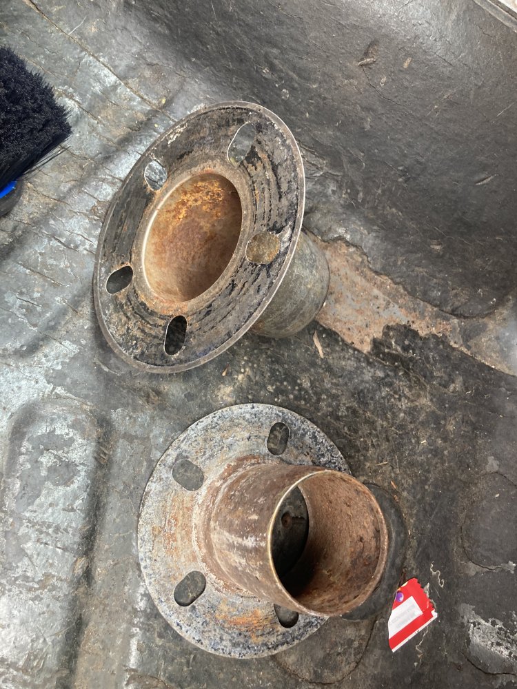

I had the local generic tire shop swap new rims on since I found some OEM rims locally for a good price. They balanced the wheels too of course.
They did leave one lug nut off since it looks like they didn’t want to try hard dealing with the threads on that one. There’s still decent looking thread on that lug but I may need to use a thread reformer first on it.
They also left two hub / bore adapters. Pic attached. Not sure what this means about the former wheels (AR23) vs the OEM wheels. Maybe the front required them for the AR23’s but not for the OEM wheels?
Im glad to have gotten a shop to be the ones to undo 20 old lug nuts. Now that they’re fresh I can more easily take each wheel off to work on brakes.
