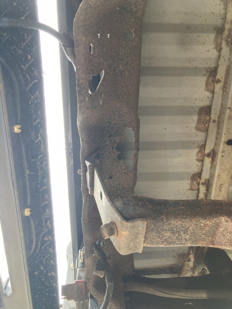

It is a team effort. Get heat on it and work it, let it cool and throw oil on it, work it and keep repeating until you force it to see the light.
You might be able to cut some of the nuts off with a grinder if you are careful but they are in a bad spot, some (like the ones above the fuel tank) are in worse spots than others.
