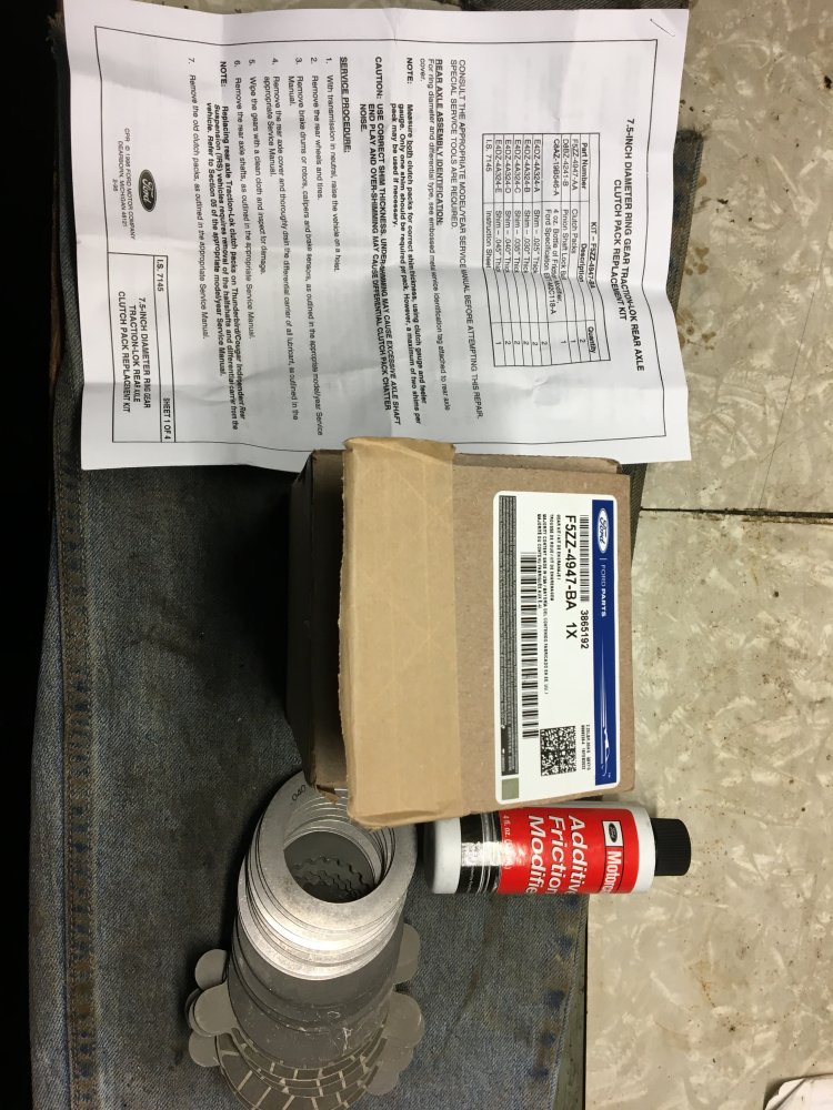

I just knew there were too many Ford vehicles with 7.5 rears for parts to be unavailable. Went to a second Ford dealer & happened to get an old-time parts man who, without blinking an eye, found the Traction Loc kit I needed. Didn't have it in stock but took only four days to get it. Cost $160 out the door. Photo of kit attached in case anyone needs the part number.

Pasting the part number in the thread for anyone searching later...
F5ZZ-4947-BA
