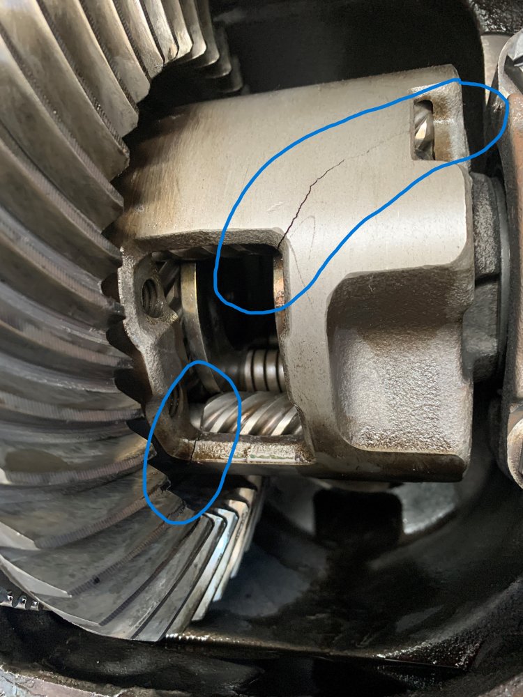

Found that I have a cracked carrier on the rear Toren differential while I was changing the pinion bearing on my 2003 FX4 Level 2. I check the Toren website and was happy to see that they have the FX4 replacement differential on sale. I called their number and was told that number was no longer in service. In addition, approximately 6 months ago, I wrote to them inquiring about a Torsen differential for the front (Dana 35 SLA), but never received a reply.

Iron Tom, I have a very rare leak at pinion seal area of my 4.10 / 31 spline, 8.8 Torsen. Thought it was the seal, also keeping the fluid fresh changing it every 2 years. Never thought of looking for any housing cracks however. Q: can you post a picture of the crack if possible? Also what ratio is yours? Need to install a cover with a drain plug~ Thx, Doug

I bit the bullet and made the purchase on-line (knowing that I can always cancel the charge card transition). To my surprise, on the second morning after placing the order, a brand-new Ford Ranger FX4 Torsen Differential, Part Number 975420-9703A was delivered :yahoo:
I'm installing it now.
MaicoDoug, you asked for a picture, here it is.
