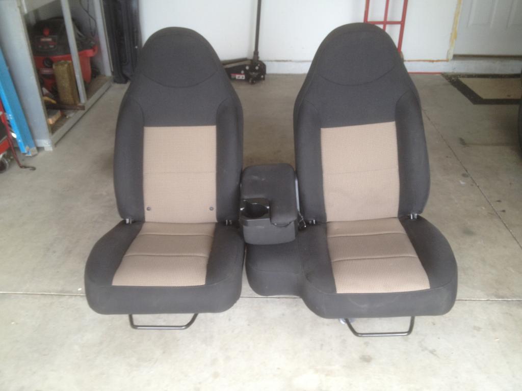

If I want to put something like this in my 1996 extended cab is it a direct bolt on ? Do they seats have the quick pull option to recline them forward and slide forward to access the back of the cab ? The seats in question are from a 2003 extended cab with the suicide doors
They should bolt right in since they are extended cab seats. You won’t have to swap tracks or anything. The only real problem is when putting extended cab seats in a regular cab… or vice versa.
