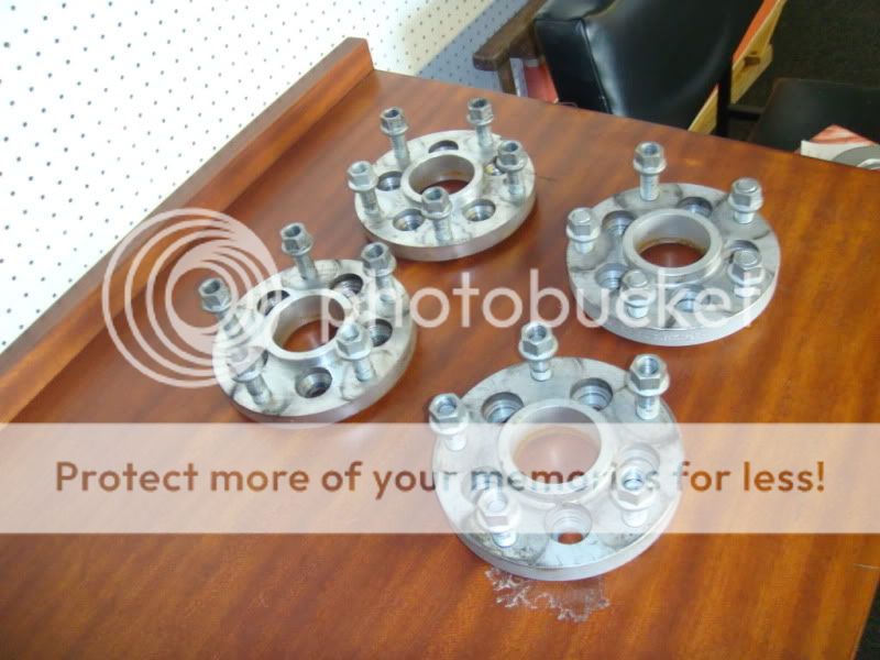

Yep alot of them sell spacers AND adapters. I would only get the hubcentric ones though.
Just so you know those are NOT hubcentric. I personally would not use ones that wernt.
These are hubcentric, notice the raised locator ring around the center hole.
